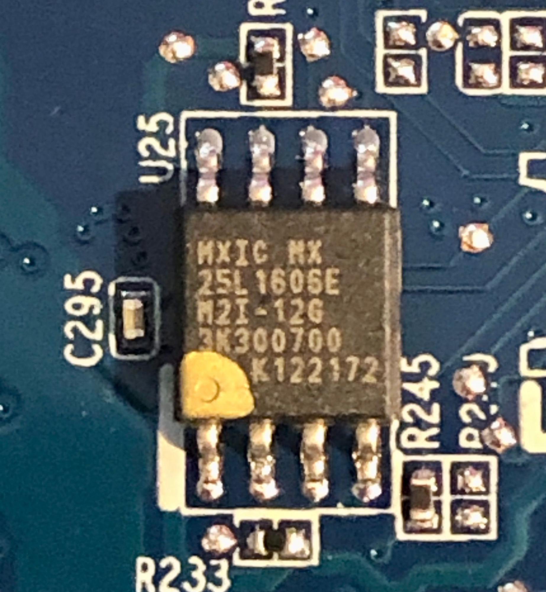

    I had an unfortunate accident when I was updating the bios chip for a Clevo P170em and I brick it so I have a CH341a to reprogram the chip but when I tried to flash the official bios from Clevo I see that the official bios is 4mb and the chip says 2mb so the software is all the time saying that it can't be flash because the size.
    By any chance someone have the 2mb bios that I can use to flash the chip.

    what does it say on the chip?? post the original bios here... maybe you still have a bios chip on the board... keep looking..

      Hi, the chip is this one:
      And the stock bios I have from the clevo website are this ones:
      But as I mentioned I can't use any of this ones because they file is larger than the chip capacity so don't know how to remove the unnecessary stuff to flash it.

        There are 2 chips on your board, 2MB and 4MB.

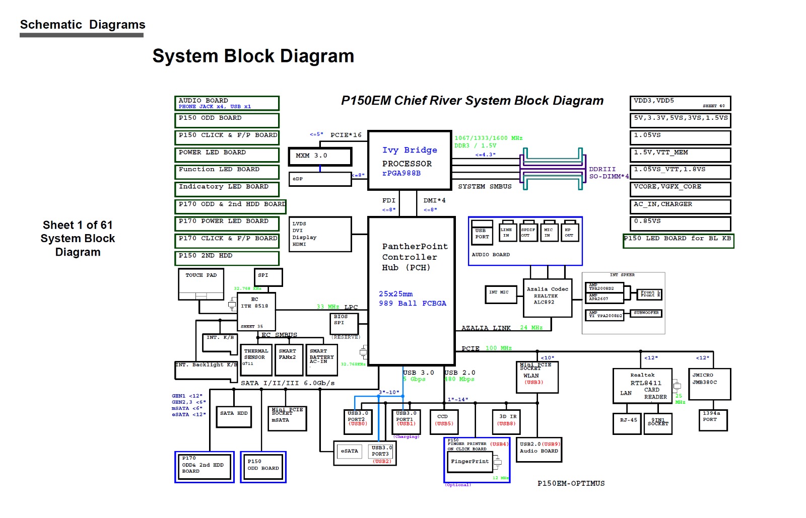

          Thanks for the reply, I tried to check what you said about two chips but I can't find 2 I see the one I post, checking the schematic I see only one.
          Also I read the chip I posted first and is completely empty. I tried to follow the instructions to split the bios but probably I'm doing something wrong because I can't it resets the software all the time and is not reading the bios I'm trying to load.
