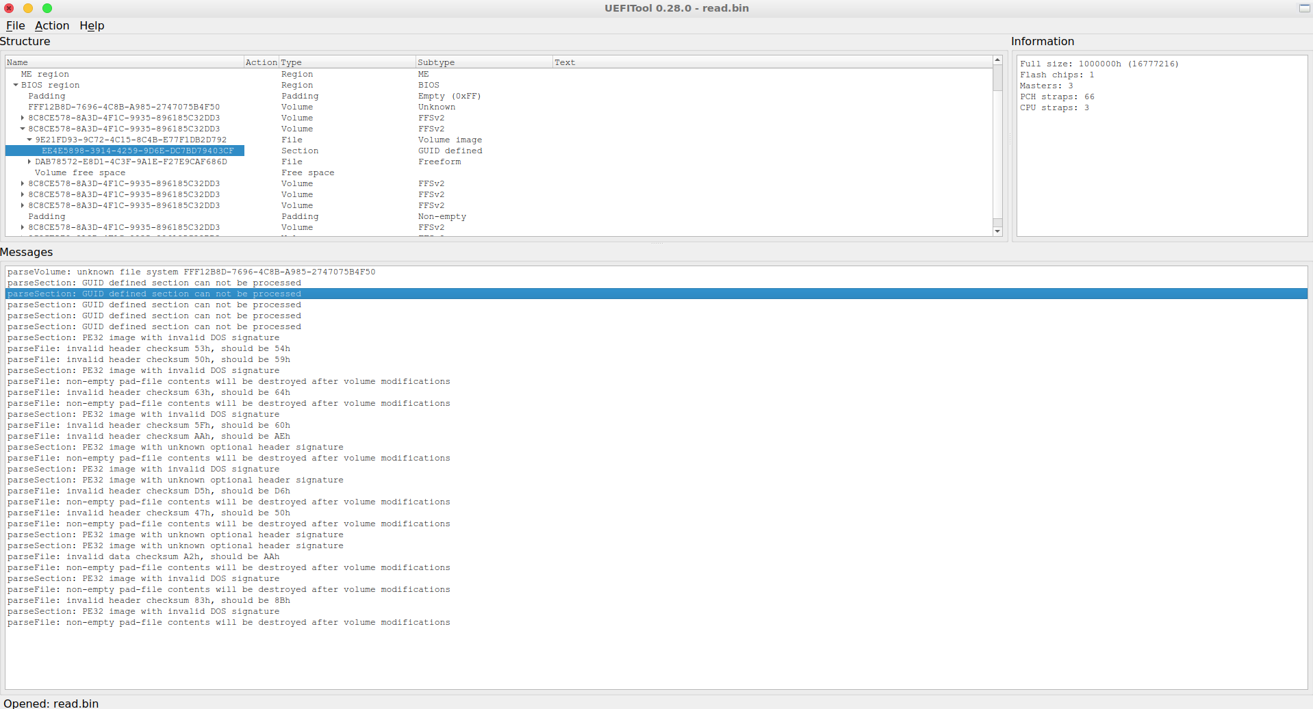

Lenovo x380 unlock. autopatcher does'nt work
  • x3oo
    • Jan 2022
    • 10
    • austria
    I read the bios from the motherboard 2 times and did a compare. both files seem to be identical. The autopatcher doesn't recognize the .bin.

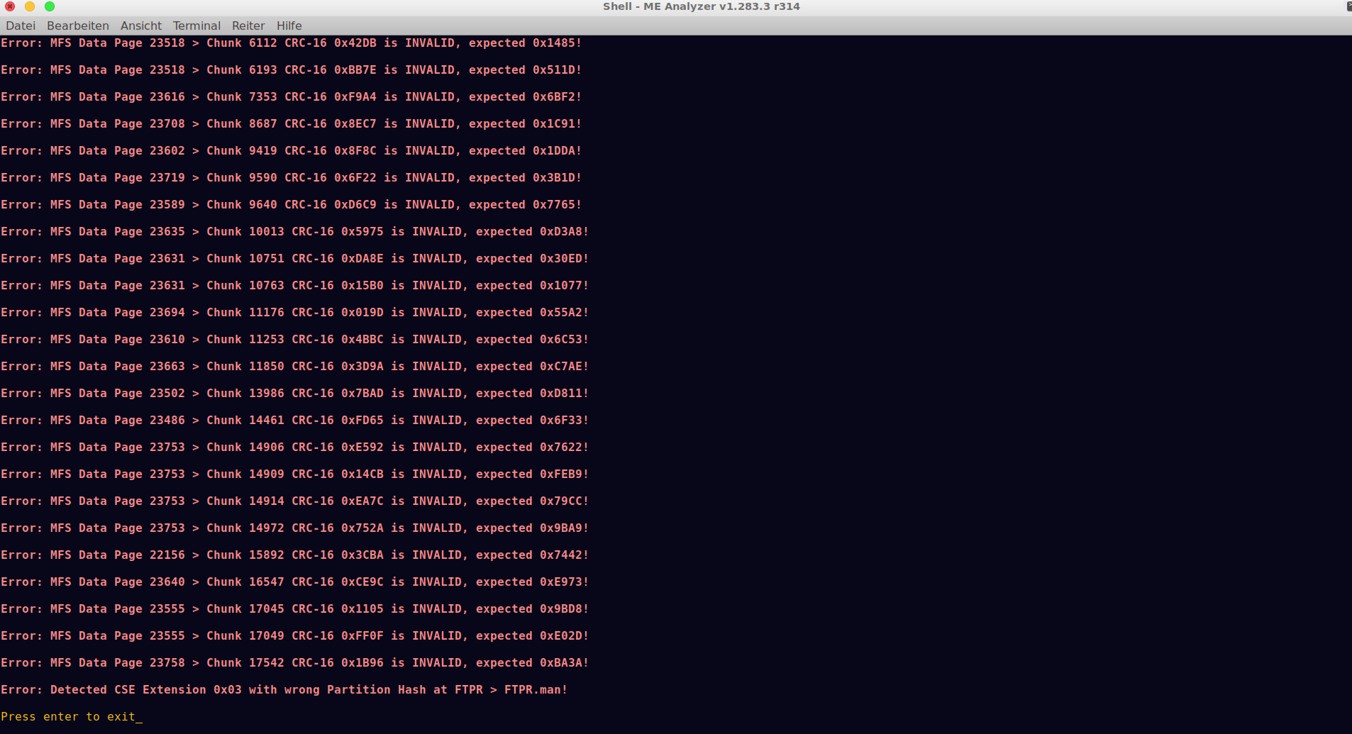

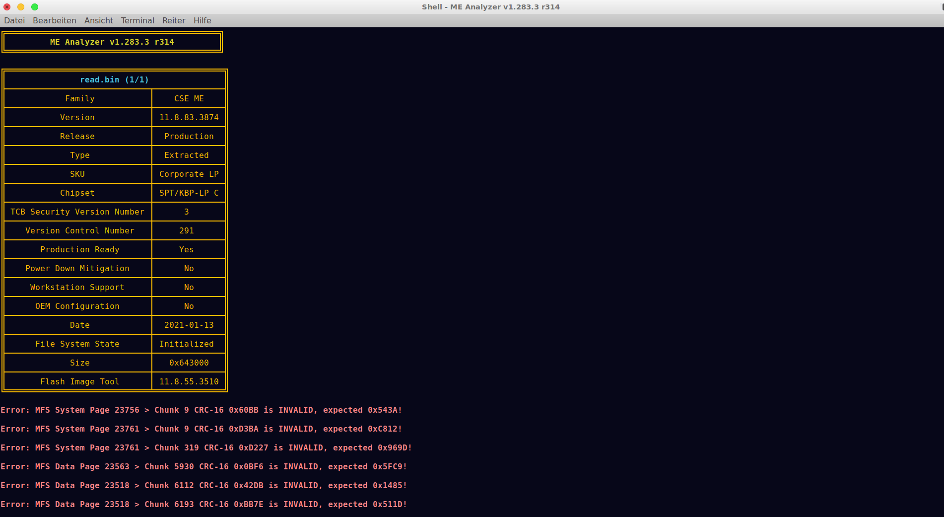

      Re: Lenovo x380 unlock. autopatcher does'nt work
      Sorry your file is total broken ....
