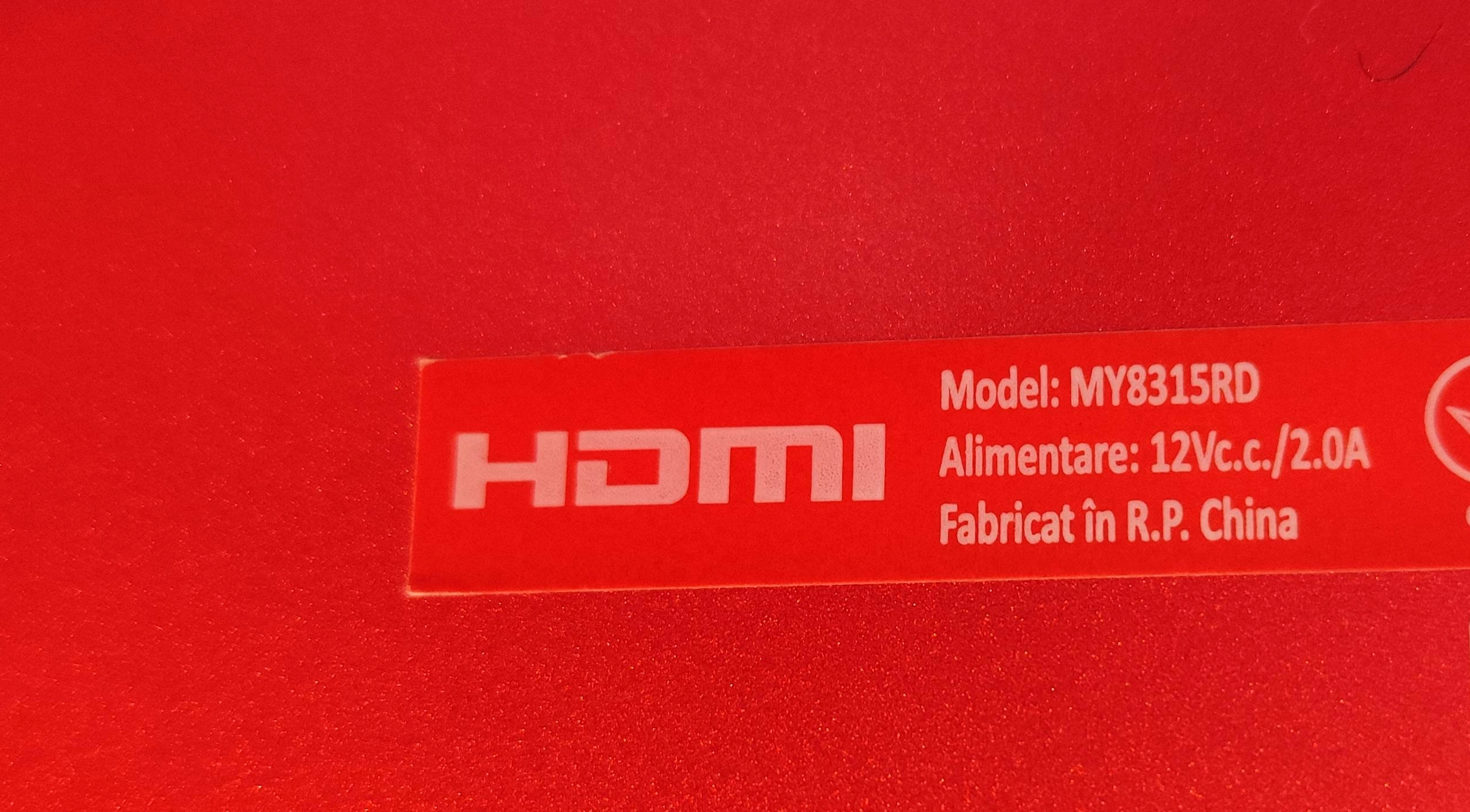

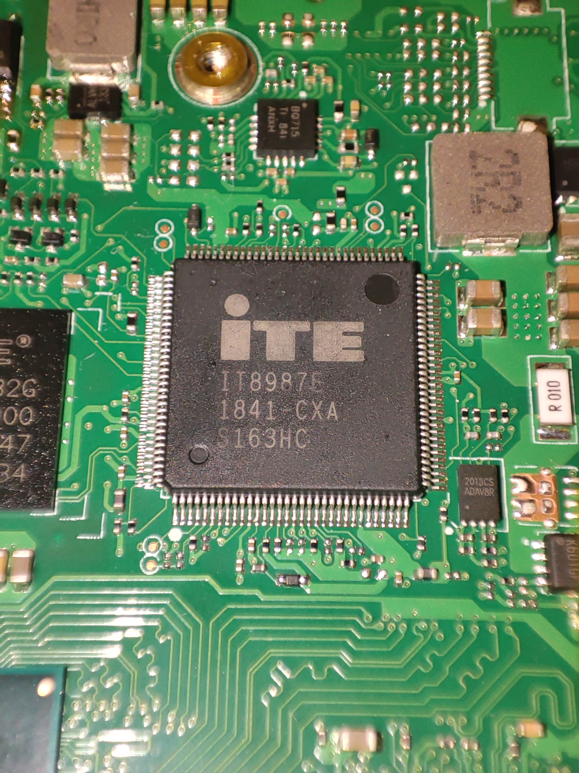

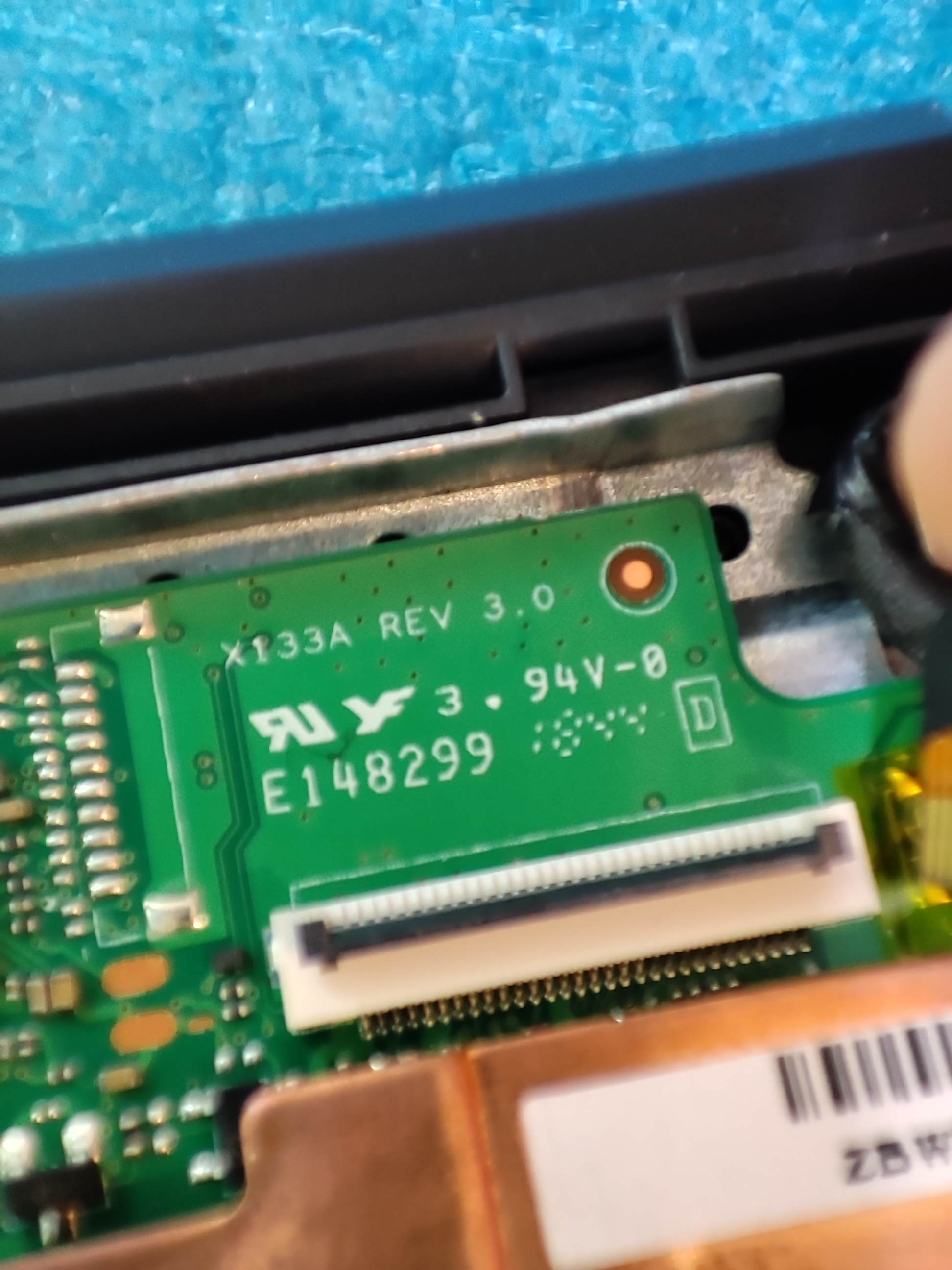

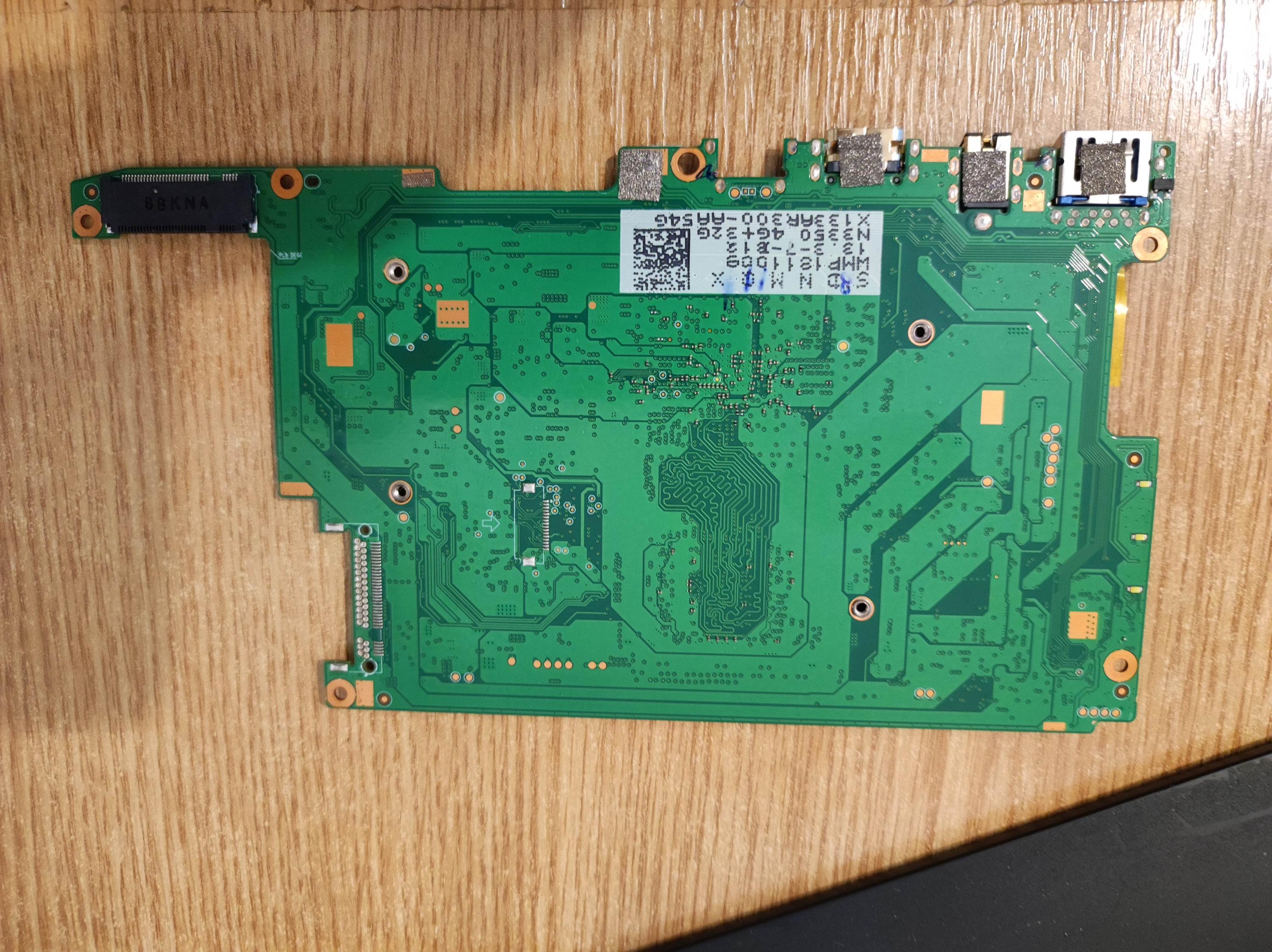

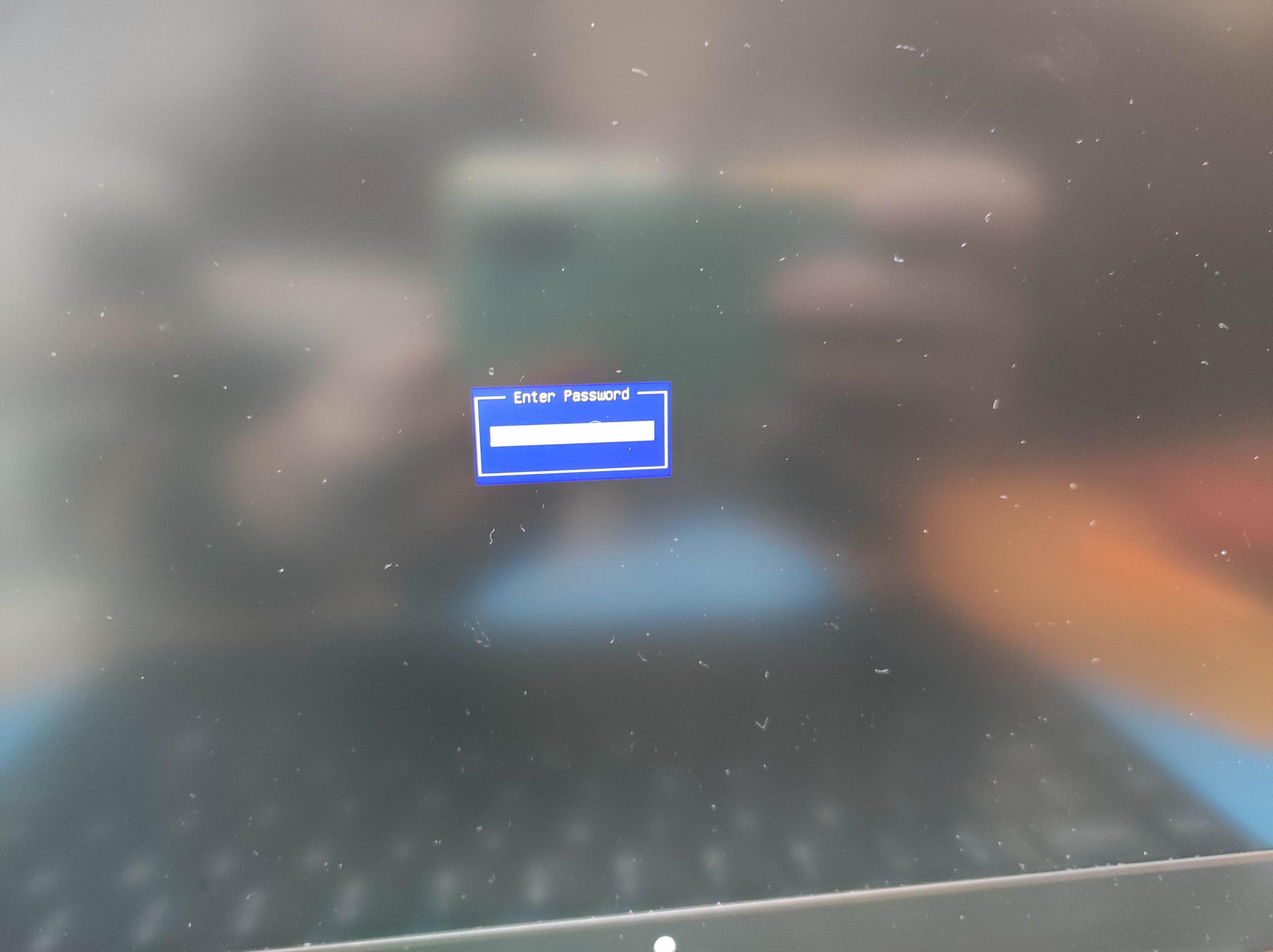

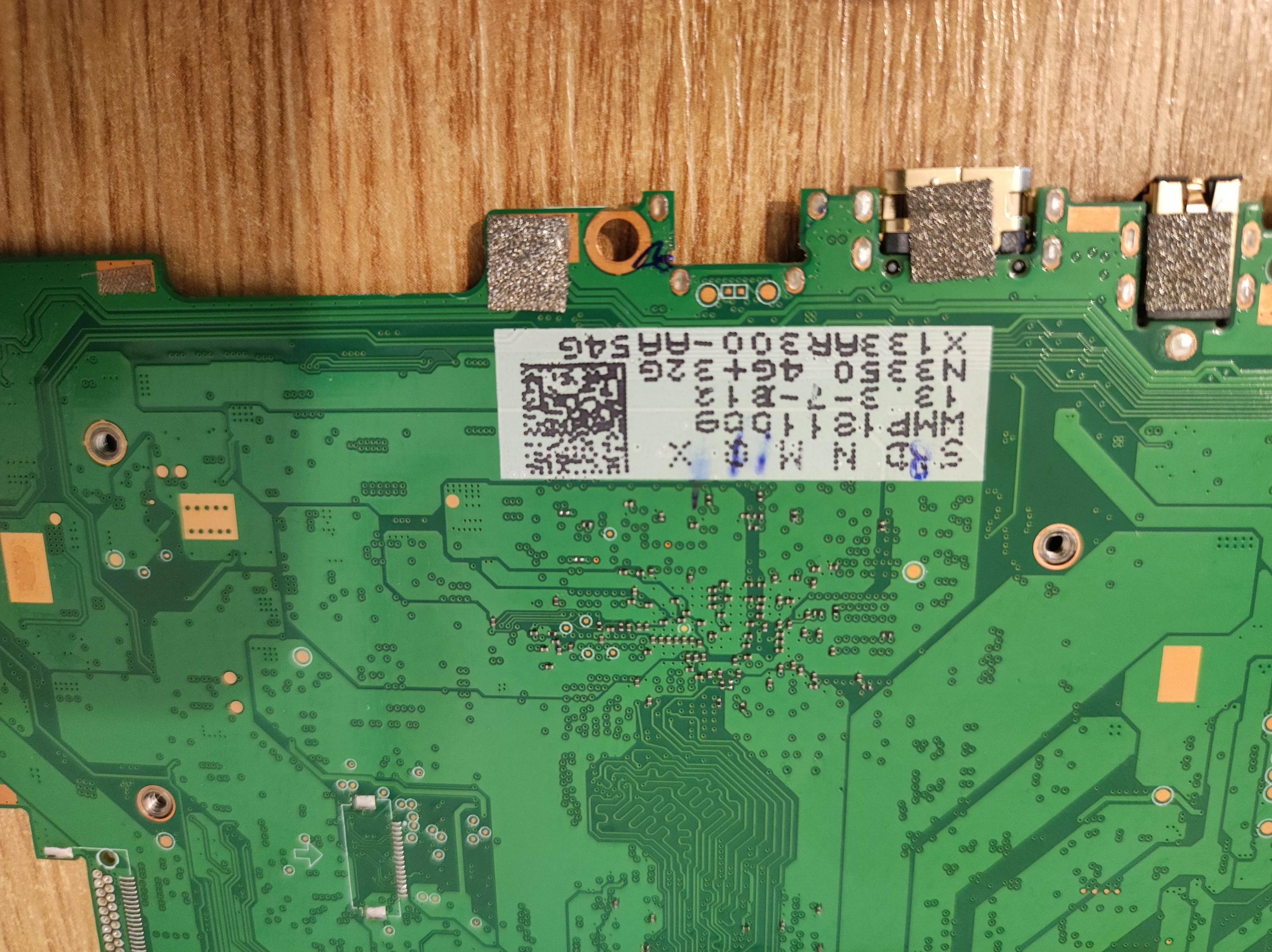

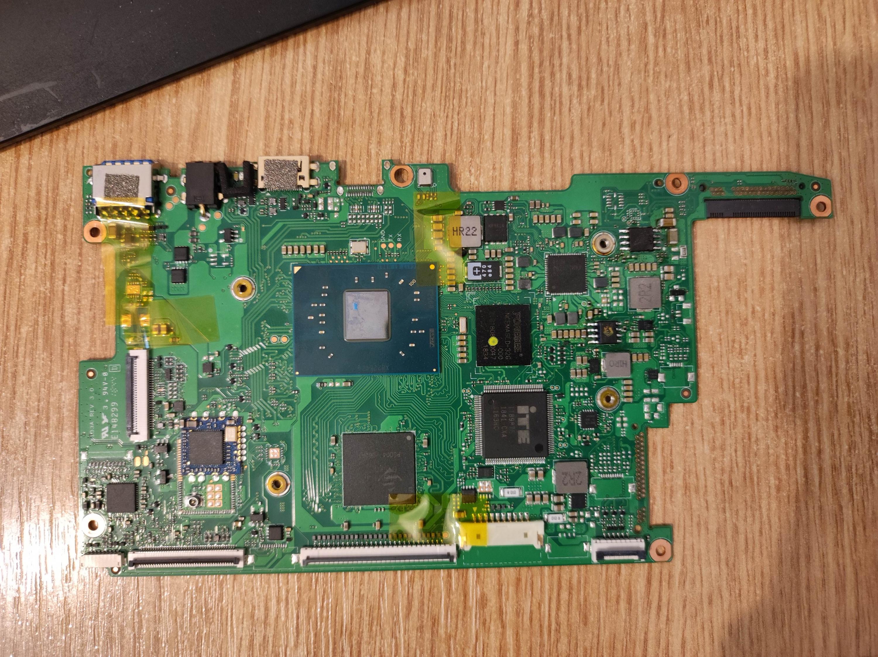

    Hello; so, one of my friend has this china regular notebook style, Myria MY8315RD, with very "speedy"cpu Celeron 3350 at 1,1ghz...
    So, this notebook has sit for a few months, and now when powering on, is asking for password ... of course, they don't rememeber to put some password, but also have a little kid...
    Anyway, mainboard is model X133A REV 3.0, and i found several similar notebook on internet, a Haier, UMAX and a MULTILASER; i write bios from all, but with no luck, when press power on, only power on led is light and no screen.
    So, best is that someone delete password from bios file; my knowledge is very low, i don't know where is located, at what line, and if is shown clear view...
    Notebook is not stolen, you can see my post in here, and notebook is very very low on resources even for Romania...so, no reason to stolle this notebook.

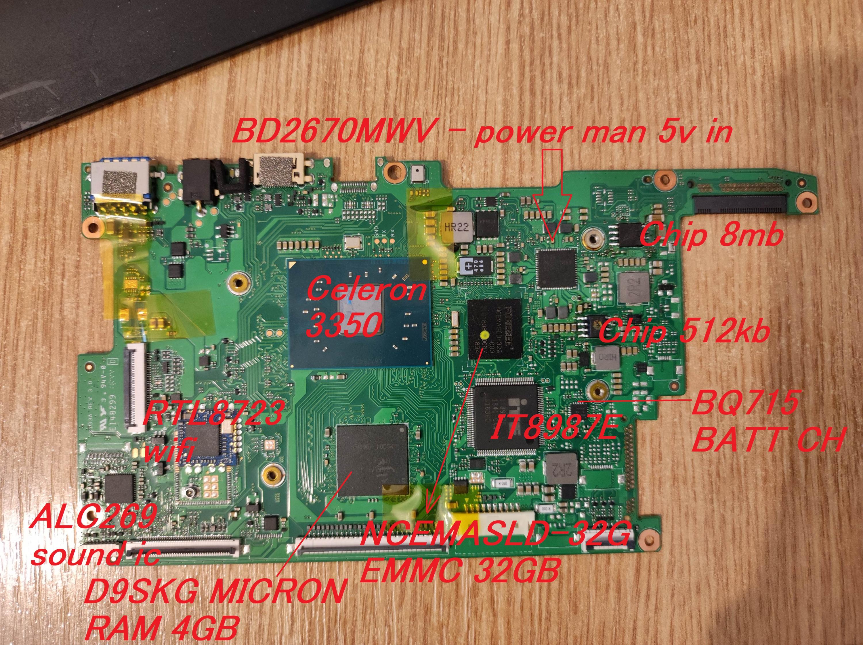

    I atach pictures with mainboard, maybe will help someone in future; and two bios file; is a 25LB64CVIG with 8mb and one 25L4006E with 512kb; sio is ITE8987E.
    I empty the tiny chip, full with Ff, stiil asking for Password.
    Thankyou very much.

    try..

      So, it's working, no more password on poweron; thankyou very much, PESTE.
