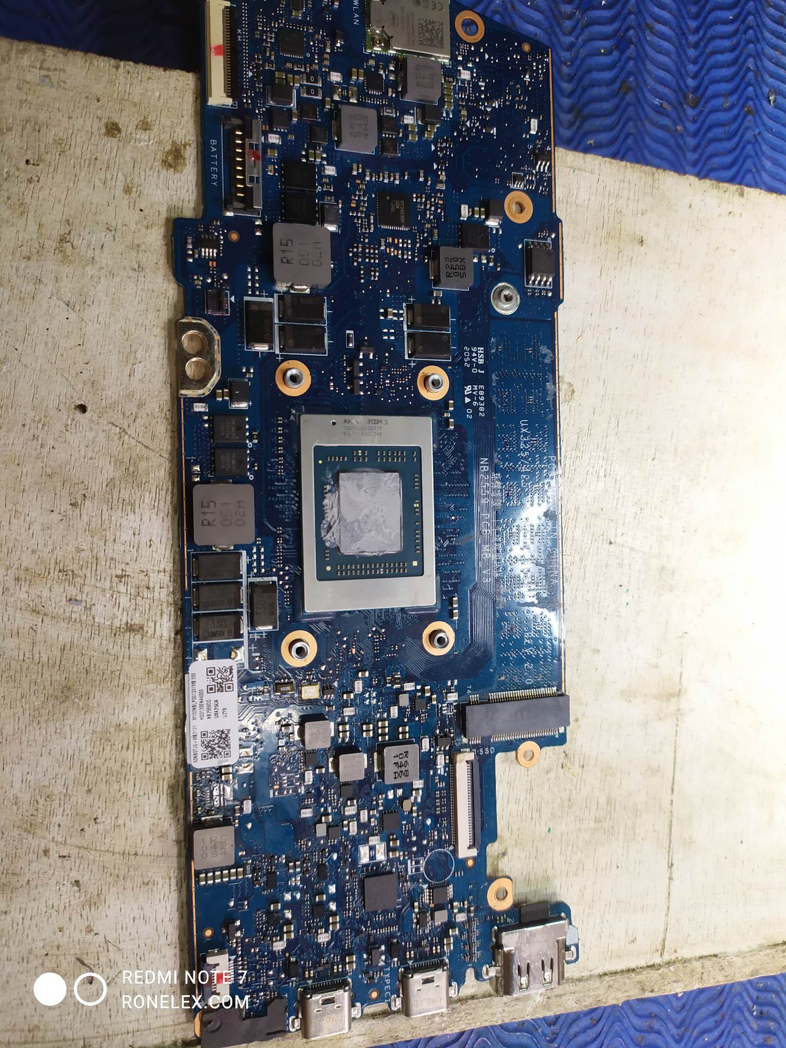

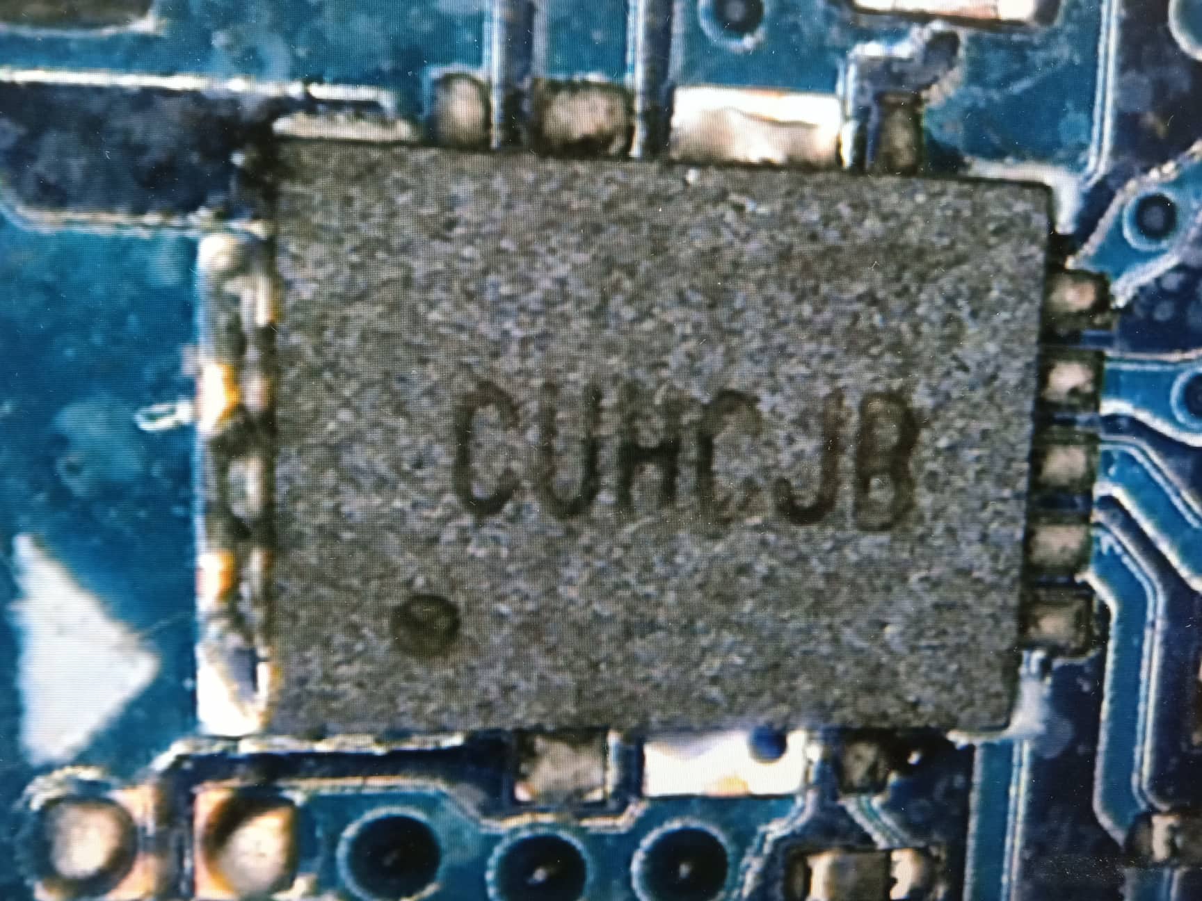

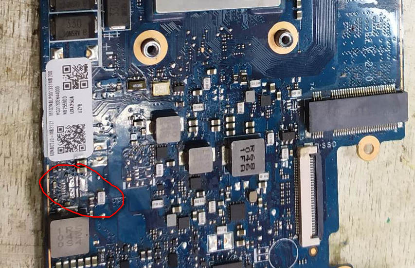

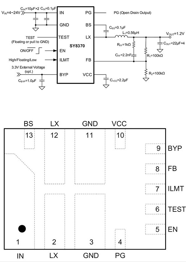

Good day, I got this unit come with a defective charger. It works first but suddenly died, and found this ic shorted but cant identify its part number. No diagram and boardview available online
Asus UM425U Identify IC
Re: Asus UM425U Identify IC

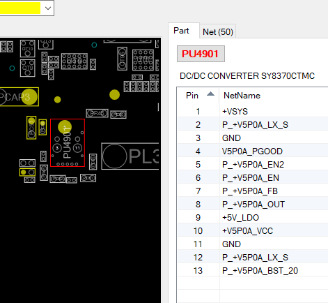

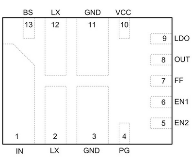

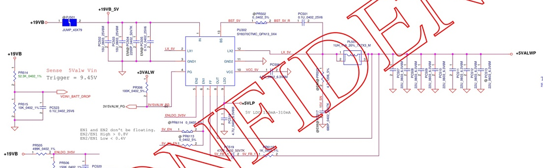

I'm not sure, just search on the internet. at least you'll get pinout from other tech that have similar ic's. i got it for you
SY8370CTMC has same pinout with SY8270CTMC
SY8370CTMC you can use LA-K971P for reference
SY8270CTMC ===> LA-K321PAttached Filesif you find these attachements useful please consider making a small donation to the site
