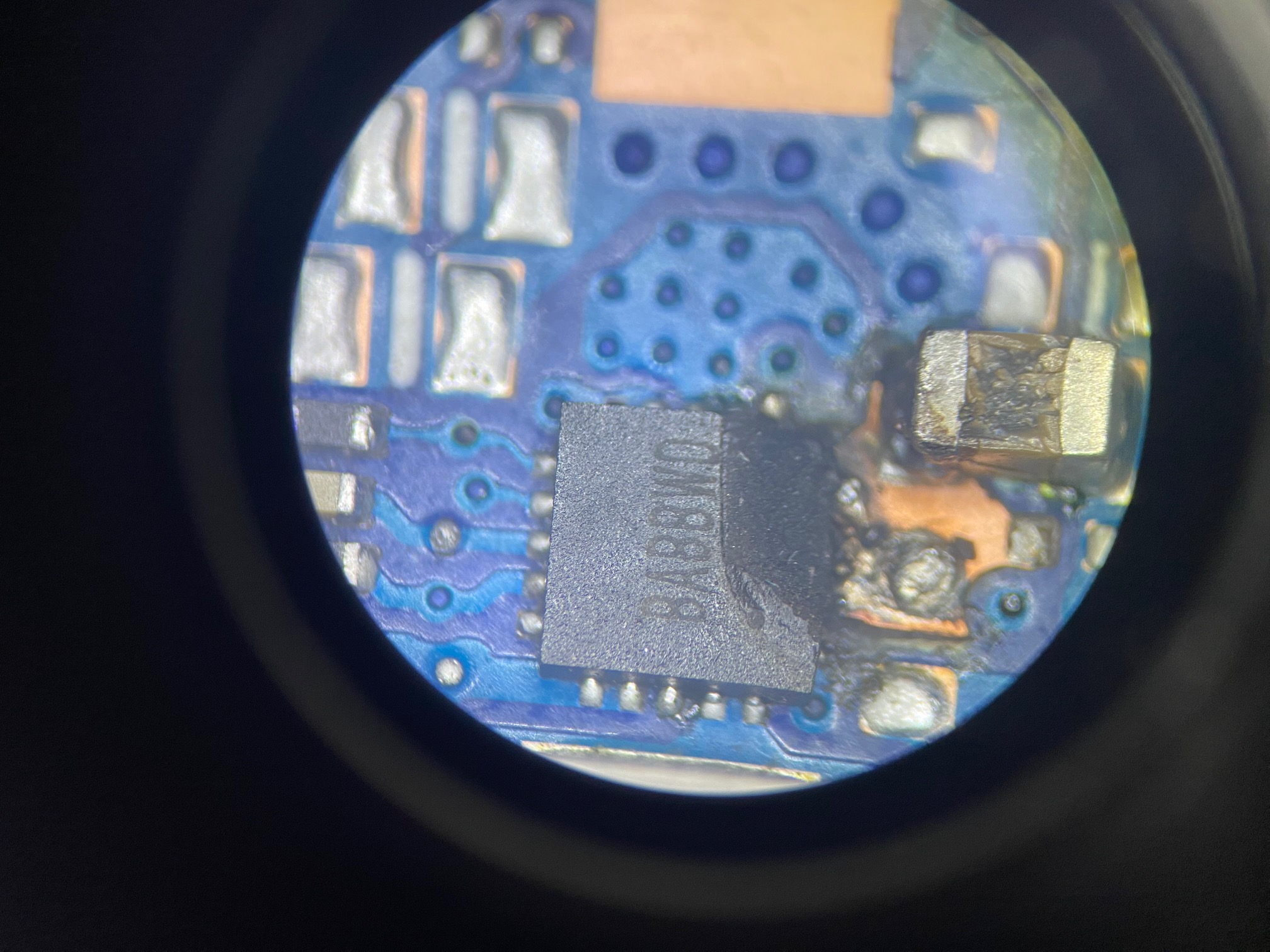

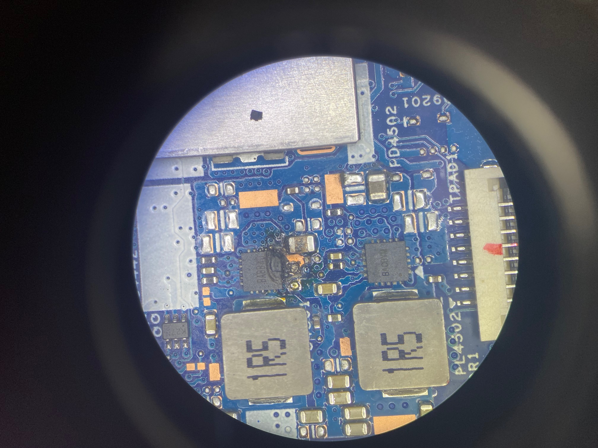

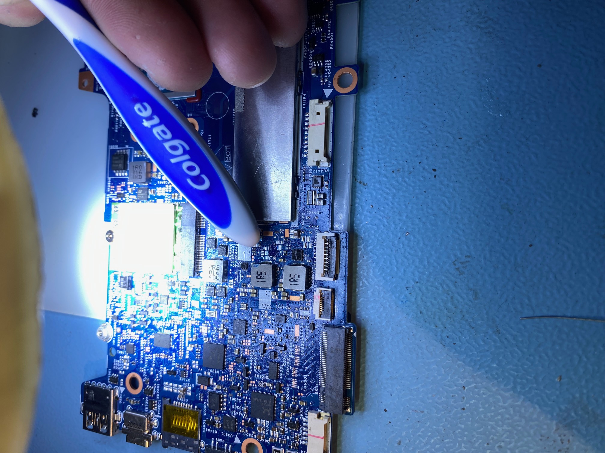

    Hey everyone, working on an HP with quite some waterdamage. One chip kinda exploded, but I have no clue what it does, or where to get a replacement. Included are a picture of the damage, one clearer shot of chip, and one pointing to the location of the chip.
    The modelnumber of the motherboard presumable is 18740-1 or 448.0GA08.0011
    Not certain what the motherboardnumbers of these HP's are tbh.
    Does anyone have any idea what chip this is, and how to find a replacement? Thank you very much in advance for the time and effort!

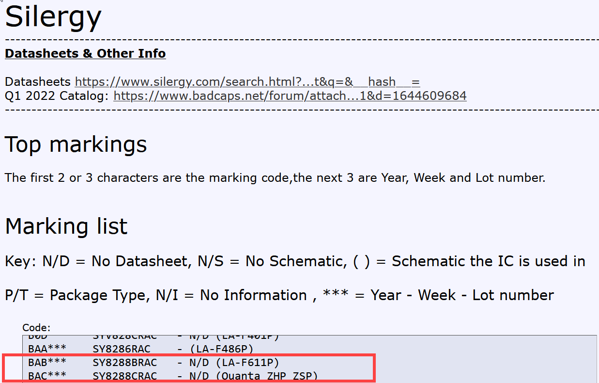

    Re: HP Envy x360 (13-AR0033NB) Waterdamage - Replacement chip?
    From the above sticky.
      Completely overlooked it, my bad. Thanx again mon!
