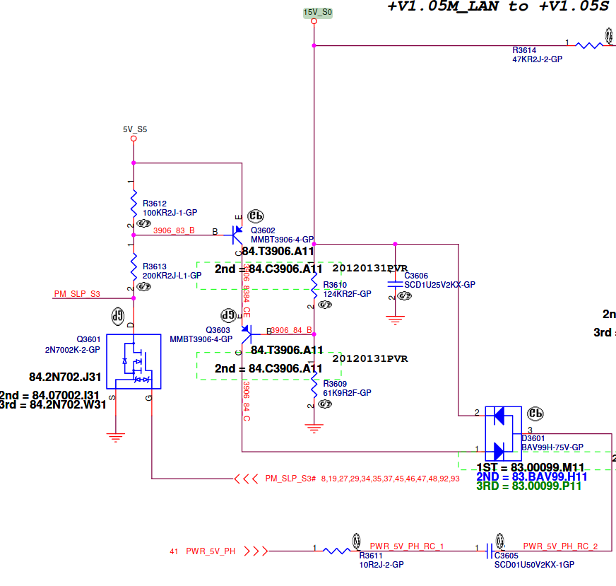

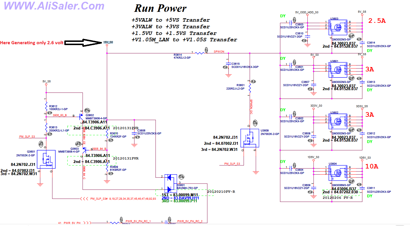

Help me to find 15V_S0 generating ic on probook 4540ss
  • bdfix
    • 16
    • Bangladesh
    I can't find 15V_S0 Generating ic.
  • piernov
    • Jan 2016
    • 4439
    • France
    Re: Help me to find 15V_S0 generating ic on probook 4540ss
    No IC, charge pump from 5V switching regulator.
