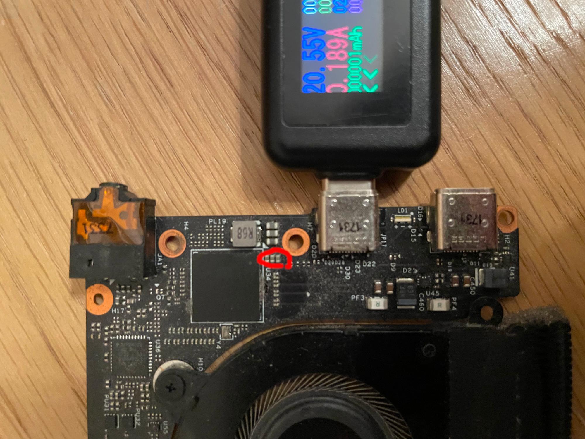

    I've a Yoga 920(DYG60 NM-B291 rev:1.0 that no longer charges. I'm pretty new into electronic repairs and don't really know where to start. But I (think?) I've made some progress.
    The charging won't step up its current (see attached photo) and I've identified that there seems to be a short over the circled resistors.
    There's some threads about the yoga 920 here, but I haven't had any success reading them.

    Re: Lenovo yoga 920 no power
    Those are capacitors and not resistors as far as my eyes can see.

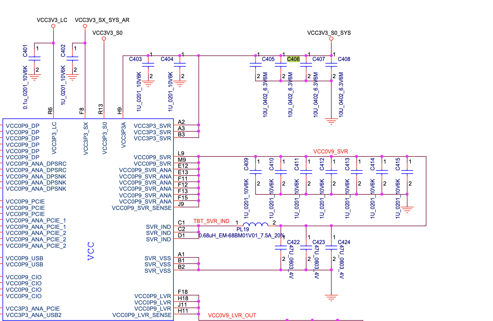

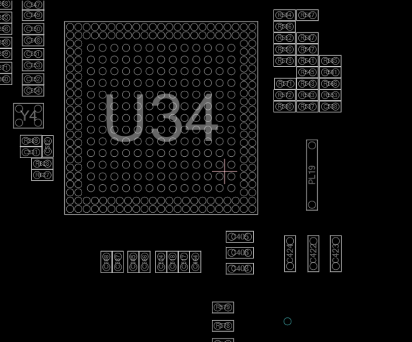

          thanks, it's c405, c406, c408 that seems shorted.
          The exact reading for the caps to the ground is 0.4 Ohm on one side and 0.7 Ohm on the other side (all three have the same).
          Attaching screenshots of the relevant areas

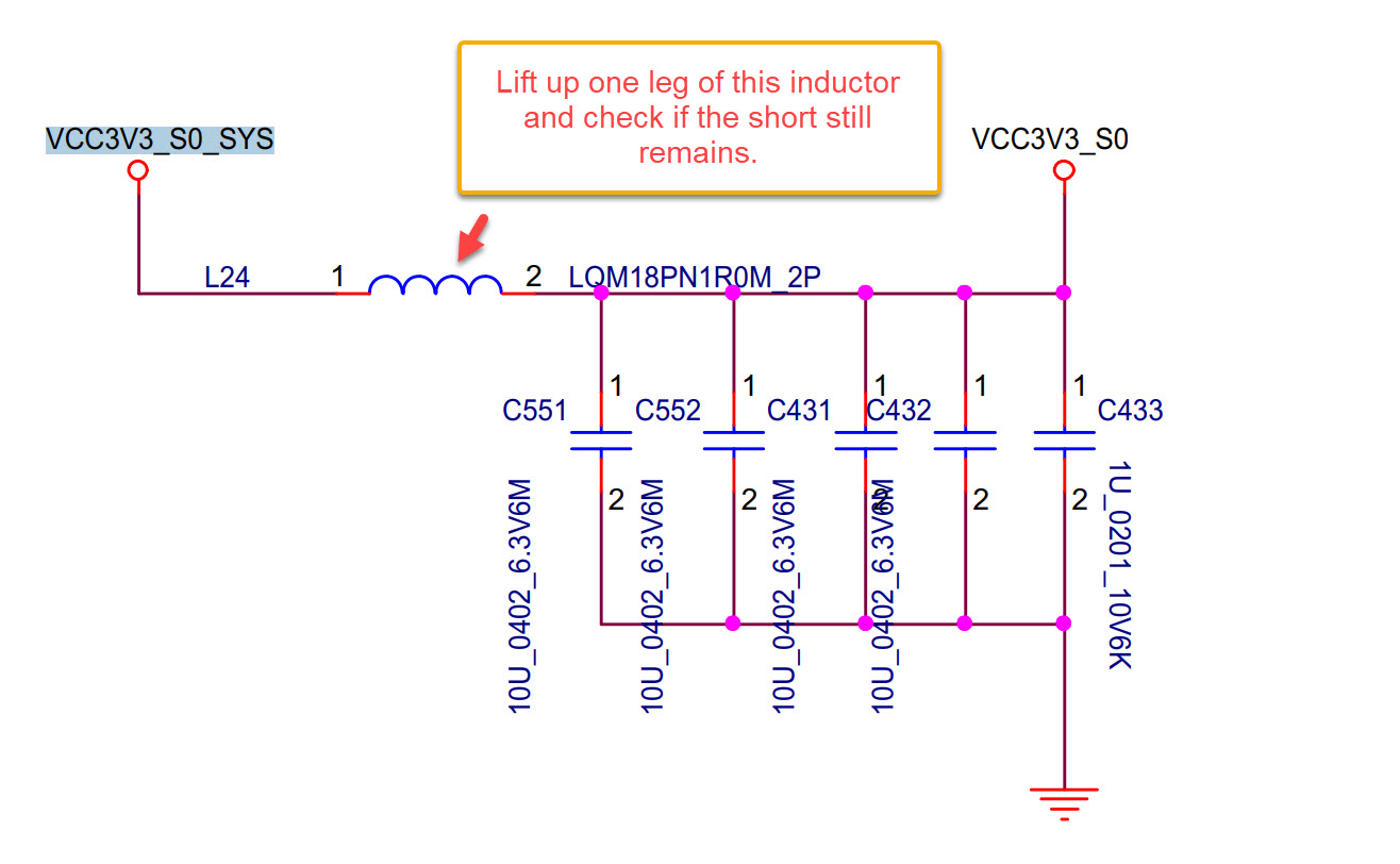

            See attached. Locate and lift up one leg of the coil / inductor @ L24.
            This is to isolate the group of caps and the target IC voltage pin.
            After lifting up the leg, check if the low resistance to ground (short) still remains or not.
            Post the resistance readings.
