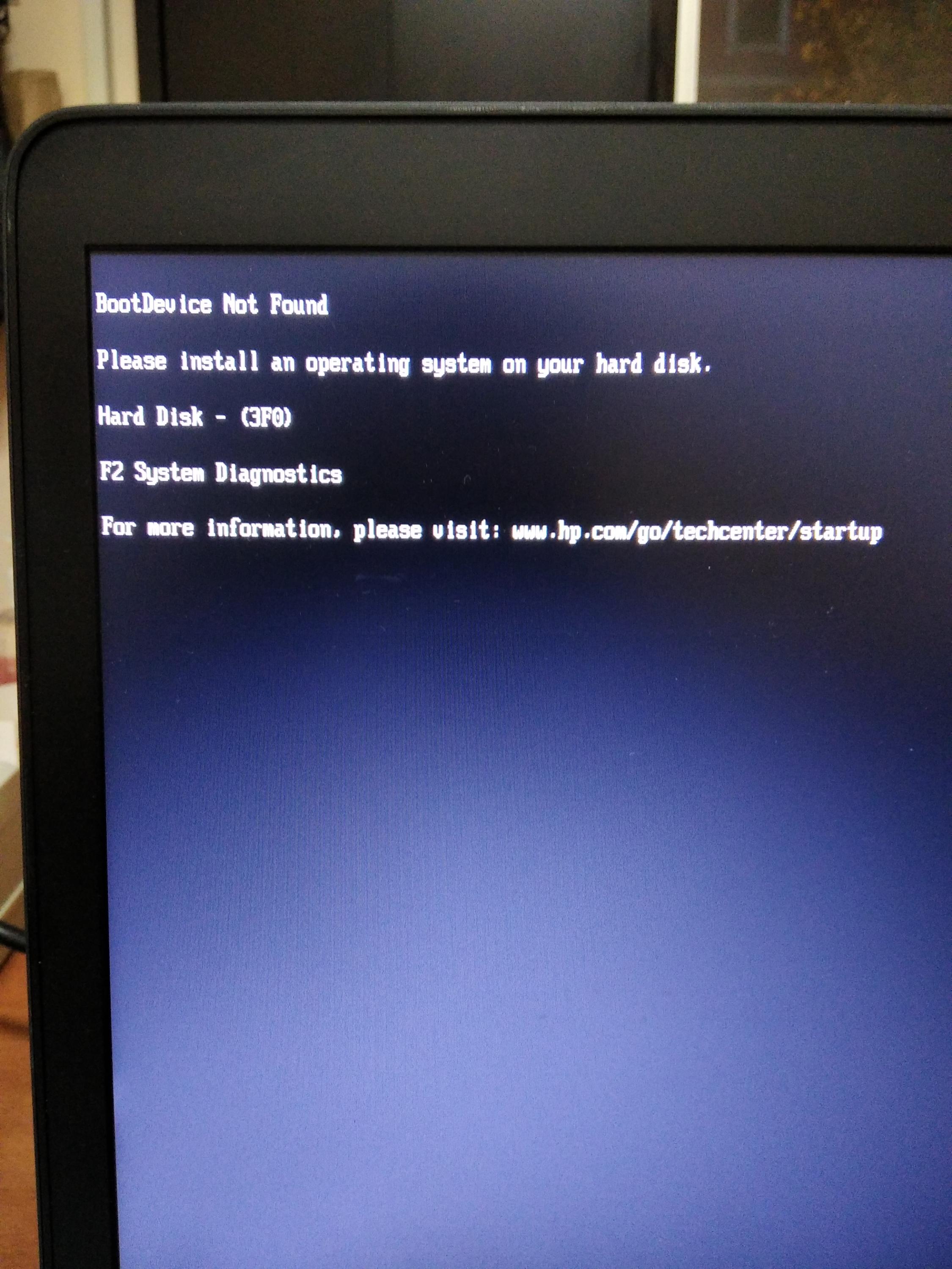

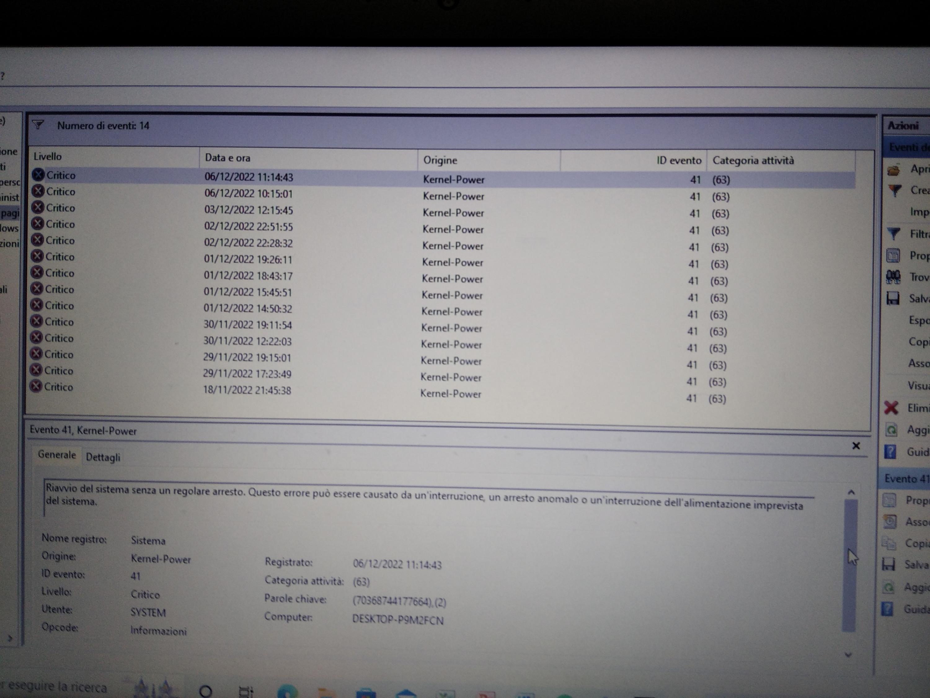

    Hello, while I work they come out sporadically and in different uses of the blue screens with restart, when I restart the boot tries to connect with ipv6 as it does not see the disk, if I turn it off and on again everything starts normally, the strange thing is that with the blue tool screen view nothing is detected, the only detection I receive in the windows events of which I am attaching photos. hp tests say everything ok. I have win 10. Thanks.

    Is this a mechanical hard disk? The hard disk may be failing. Suggest to test with another SSD with a fresh windows installation. Recently upgraded to Win 11 and it is a very nice and fast operating system.
    Backup your hard disk ASAP.
