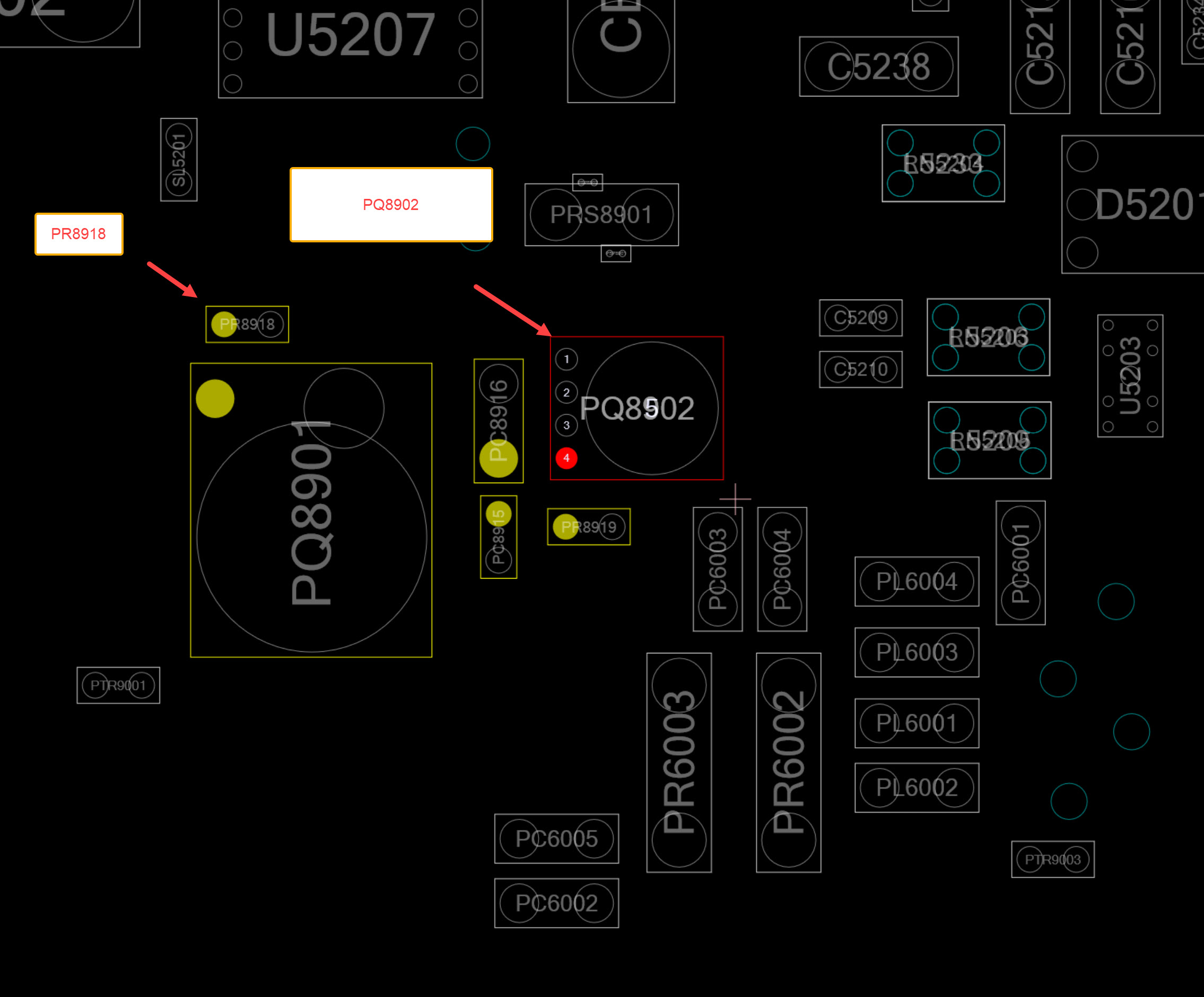

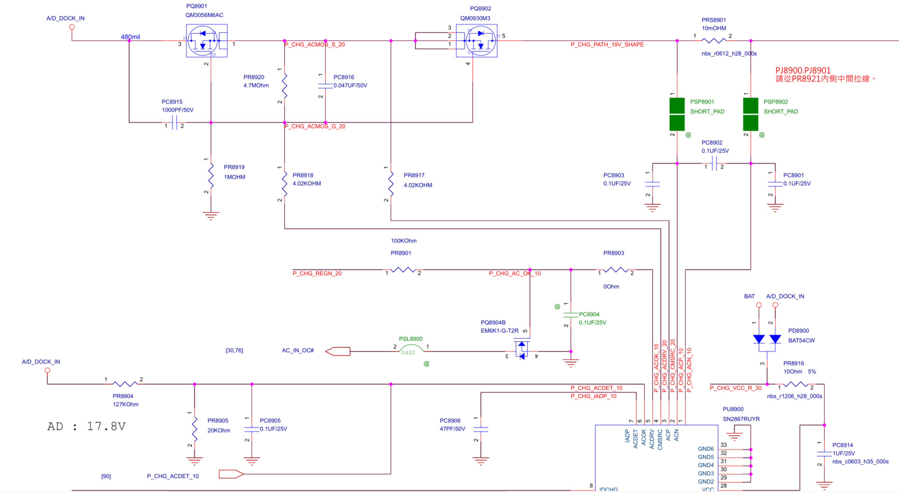

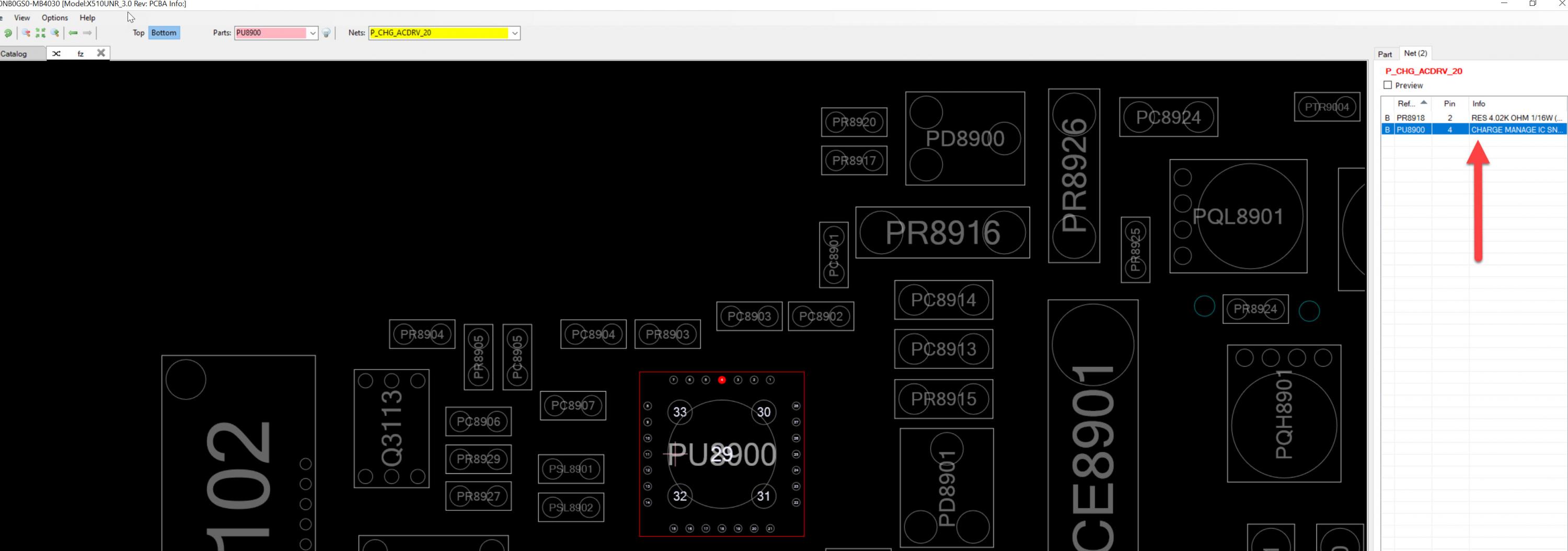

Wiring should be as attached.

Thank you for your help. It took me a while and a new battery to fix this Asus.
I finally found the 0 ohm resistor that was missing.
Mon2, I really appreciate your help and patience while I was struggling understanding this board.
