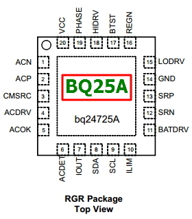

    what is the equivalent ic bq735 on laptop asus gl553vd plz help

    Bq24735

      BQ24725 is also likely to work but better to put original 24735. However, you can try with 24725 if its in stock with you. It wont harm for sure as both are pin-pin compatible.

        Re: BQ735 equivalent
        bq25a same schematic

          Re: BQ735 equivalent bq25a same
