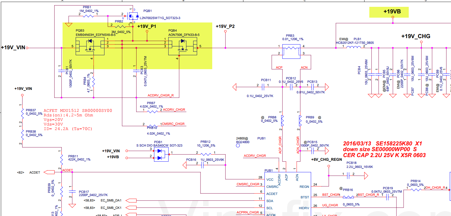

    Hello guys can you check if my analysis is correct? No 3.3v in EC_RSMRST# pin power button pressed or not. After pressing power button, 3V_EN will have 3.3v then back to 0v so PU301 will not produce +3VALW and the laptop will not turn on. I've checked the resistance of 3V_EN pin and it is not shorted. Is it because the SIO is defective already or do I need to reprogram it? By the way, is this SIO ENE KB9052QD programmable? I've included the Boardview and a reference schematic diagram LA-K092P(No KA-K093P available). Thanks to all who will answer.

    Hi. Have not reviewed your schematics but start with the basics. The sticky above by @Piernov is a must read on how charging works.
    Do you have the usual 19v from the power adapter?
    Start at the dcin connector and confirm how far this voltage travels. There will be typically 2 x DCin mosfets. What voltage to ground is on each pin of these mosfets?
    Often the 2nd mosfet gets killed on laptops.
    With voltage and resistance checks with your meter, we can find the defective parts.
    Start with the mosfet voltage checks of the source, drain and gate pins. If the gate pin is not ~25v on each, then one of the DCin mosfets is defective and must be replaced.

      Thank you very much for your reply. To answer your questions.
      Answer:
      Yes 19v is present in the DCIN Jack up to the first mosfet.
      Answer:
      I never tried to check on the 2 DCIN mosfets because the SY8286CRAC 5VALW IC is functioning normally with 19V present at VIN so I assumed that the 19v rail is funvtioning normally. Based on the power sequence on page 5 of the schematics, the5VALW line is the one initially present and the 3VALW line will come up after pressing power button sending the ON/OFFBTN# signal then 3V_EN will come out from the EC to enable the 3VALW regulator. However upon checking, when you press the power button, 3V_EN will have 3.3v then after 1-2 seconds it will return back to 0v thereby turning off the 3VALW IC almost instantly. This I think is the problem. Why can't the 3V_EN signal maintain its voltage. What is pulling it down? The 3V_EN line is not shorted to ground upon testing. Do you think this is an EC/SIO problem? By the way RSMRST# also has no 3.3v present before pressing power button and after pressing power button. It remains 0v even with battery or adapter present.

        It is still good to check the 2 x DCin mosfets for leakage / defects. Often the 2nd mosfet is killed and is a common fault. With a possible leak, the ALW rails will still receive their power (via +19VB).
        You can do a quick check with NO POWER / NO BATTERY to the logic board.
        Meter in resistance mode.
        Check the resistance across the mosfet pins:
        source (1-2-3) & drain (5-6-7-8)
        source (1-2-3) & gate (4)
        gate (4) & drain (5-6-7-8)
        Post each resistance reading. Repeat for the 2nd mosfet. If the resistance is low, the mosfet is leaking and must be replaced as a part of this repair.
        So investigate PQB3 & PQB4 for their resistance.
        With the power on, what are their GATE (4) voltage to ground ? This voltage, for n-channel mosfets, must be DCIN+6 volts =~25 volts to enable. Confirm it.

          Upon checking PQB3 and PQB4 here are my resistance readings:
          1st MOSFET PQB3:
          Source and Drain = 2.45 Megohms
          Source and Gate = 2.59 Megohms
          Gate and Drain = 4.48 Megohms
          2nd MOSFET PQB4:
          Source and Drain = 3.38 Megohms
          Source and Gate = 2.60 Megohms
          Gate and Drain = 3.19 Megohms
          With power on, here are my voltage readings for PQB3 and PQB4 :
          1st MOSFET PQB3:
          Gate Voltage wrt Ground = 25.28v
          2nd MOSFET PQB4:
          Gate Voltage wrt Ground = 25.27v

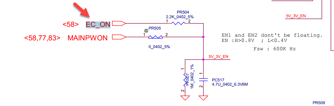

                                      Re: Acer Aspire 5 A514-54-37V6 No power and no RSMRST# present
                                      See attached.
                                      What is the voltage to ground of EC_ON ? Does this voltage remain stable while you have power ?

                                        Very stable at 3.32V when the board is powered however when I press the power button it goes down to 0v. Hmmm. I think this should remain at 3.3v right?
