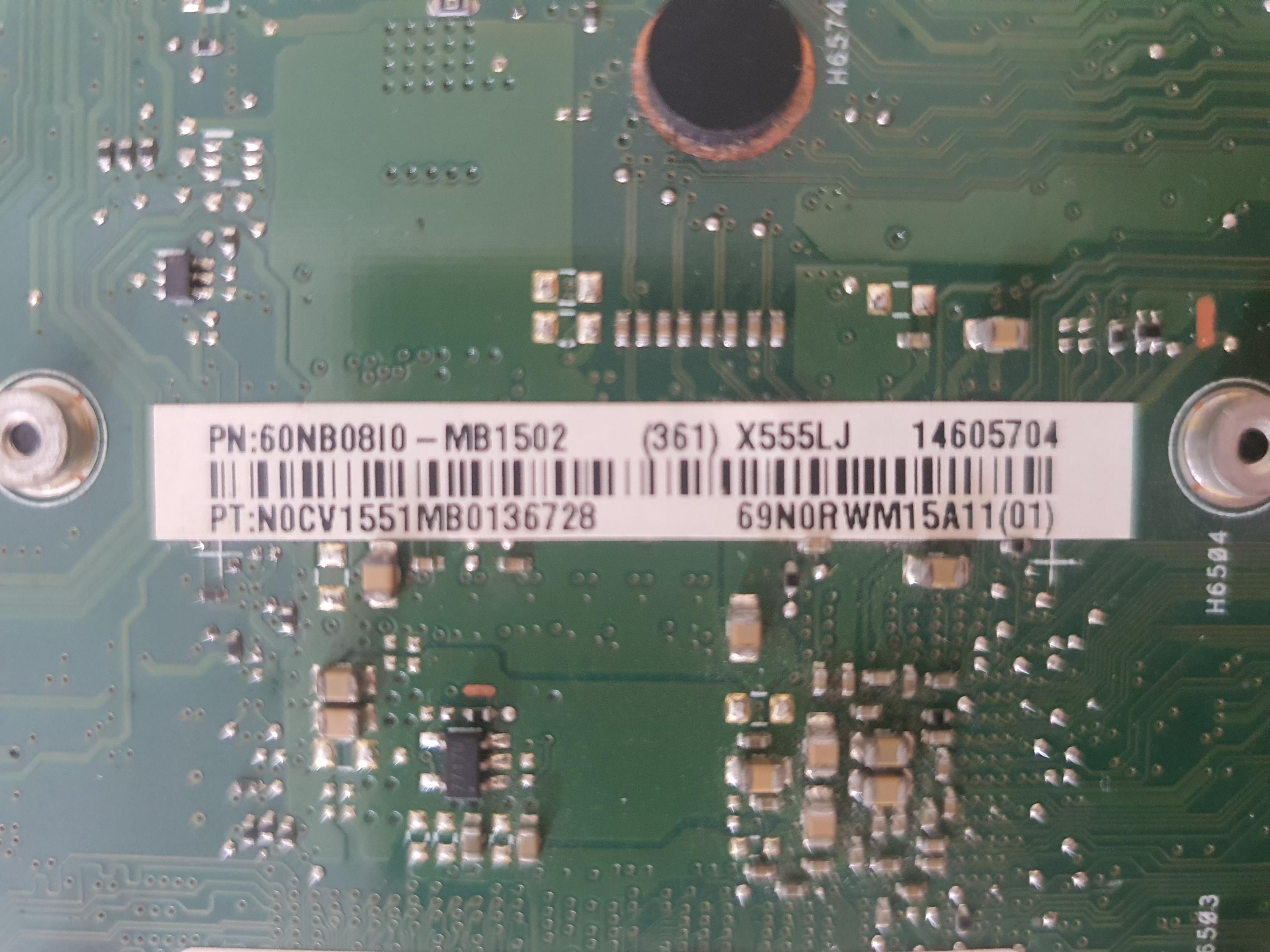

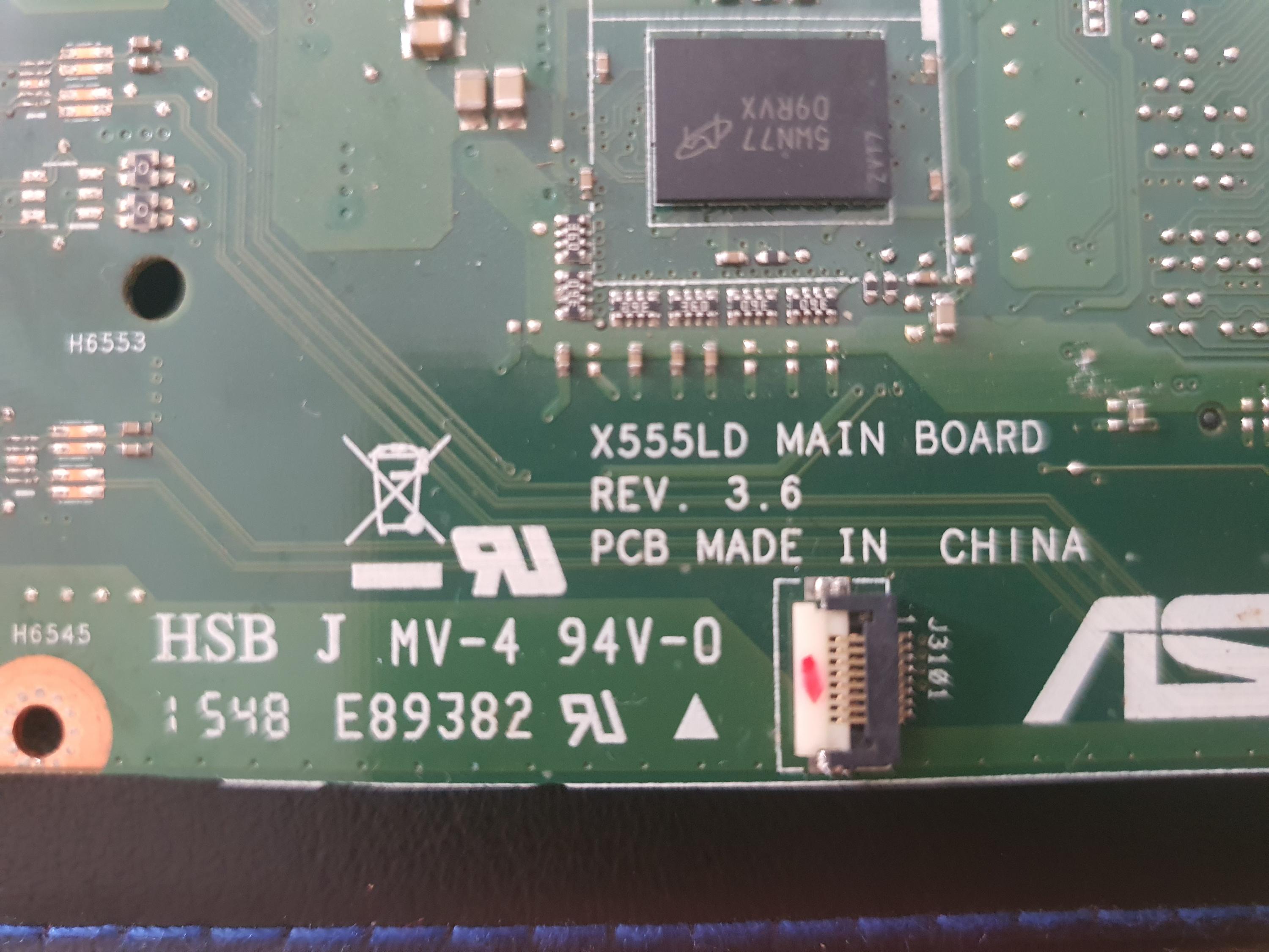

    I want to try my first component level repair on this board. It is a Asus X554L with X555LD main board rev. 3.6. I search the forum and online, downloaded any resources available. The boardview I get is not exactly the same, this main board may have many variant, not all component shown in boardview exist on actual board.
    The board do not power on, no charging light, nothing. Item already check include
    1. MOSFET PQ8801 PQ8802, source +19.5v, drain +19.5v, gate +24.3v
    2. Power switch SW5601, +1.96v, below required +3v.
    3. IC PU8101 (component with marking 2N=, Richtek RT8249C) is heating up, pin 3 +3VAO +1.98, pin 13 +5VAO +5.06v
    I read some thread, RT8249C heating up doesn't mean IC is shorted, maybe it working in that way, but I don't know where to trace next. Hope to get guidance and thank you in advance.

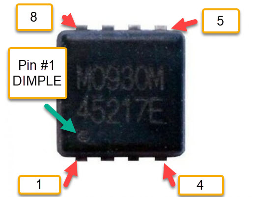

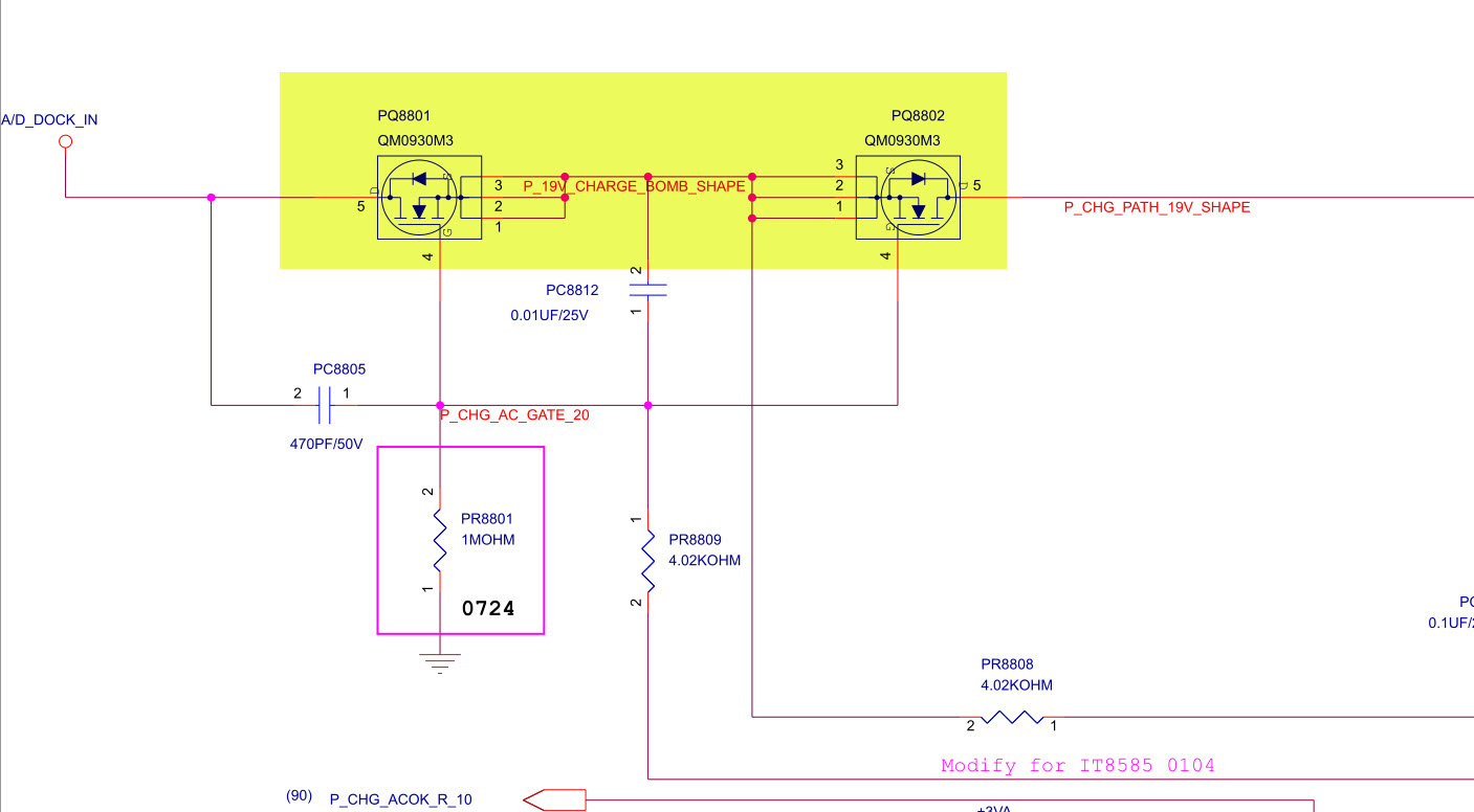

                    The mosfet marking is M0930M, I could not find datasheet, so I don't know which type of mosfet I have. I test it on diode mode, roughly guess where to contact the +ve and -ve probe. I took pin1 as drain, D
                    ______________PQ8801 PQ8802
                    S(-) and D(+) 16MOhm 16MOhm
                    S(-) and G(+) 1136kOhm 1030kOhm
                    G(-) and D(+) 16.5MOhm 16.5MOhm
                    I have no idea what I am looking at

                      Correct. See attached.
                      The highlighted parts are the 2 x DCin mosfets. They are acting like switches that allow / stop the power from your external power adapter from reaching the main power line.
                      Respectively each mosfet is enabled or disabled via the voltage on the GATE pin # 4 of this package.
                      On N-channel mosfets, the GATE pin must be HIGHER than the voltage that is being passed on the source / drain pins. That is, if your adapter is ~19v then the gate voltage is often around 19v + 6 volts (boosted by the charger IC) = ~25 volts to turn ON the mosfet.
                      Start with measuring the voltage on pin # 4 of each of these mosfets with the power adapter connected.
                      Red probe to pin #4; black meter probe to ground; meter in 20V or higher DC volts mode.
                      Post your measurements.

                        I check on this section previously, I will re-check it again tonight. In previous measurement Pin#4 is +24.3v, Pin#1 is +19.5v. Source voltage is present for both mosfet, +19.5v. Is this measurement sounds OK? Gate voltage is slightly lower but Drain voltage is present.
                        Just an additional thought. Both mosfet is interconnected for Pin#1 and Pin#4. With power adapter connected, only PQ8801 is check in this measurement?
