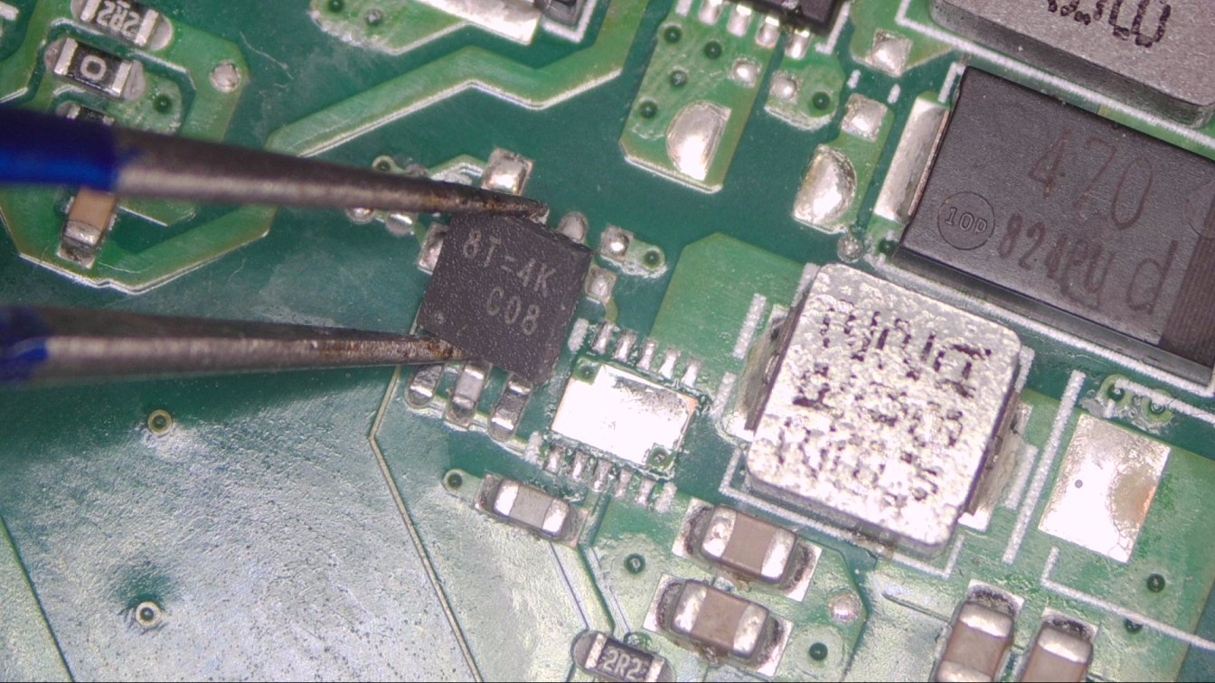

    Looking for replacement IC for this model, google search yields no replies

    Post your images to badcaps please.It would be nice to have the laptop model number and the motherboard part number as well

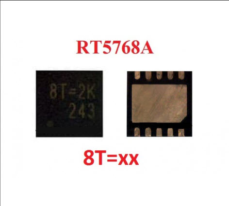

        Re: Asus Zenboook UX550VD Laptop IC identification help
        Attached.
        Richtek p/n RT5768AGQW

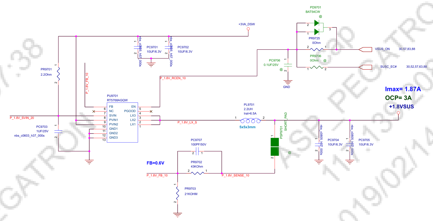

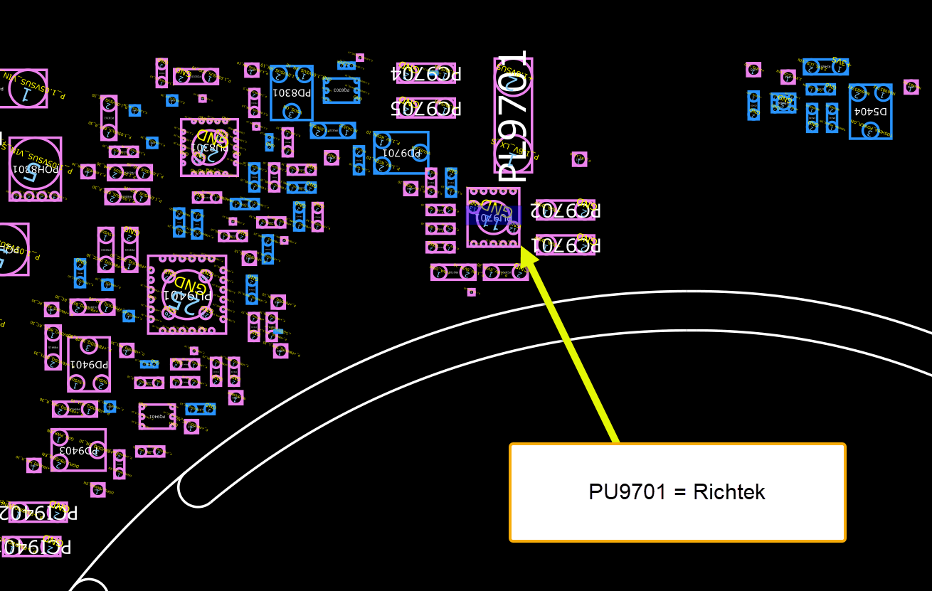

          your a living legend thanks mate, you wouldnt know by chance if theres a boardview or schematic for this model? thankyou
          • mon2
            • Dec 2019
            • 14662
            Unable to find the files under UX550VD but review the files for UX550GD. The BV looks similar to your logic board and also, the schematic features the same regulator from Richtek for the 1v8 rail.
                The above bv portion are from a screen grab of a paid sub. It is a locked pdf file with crappy resolution.
