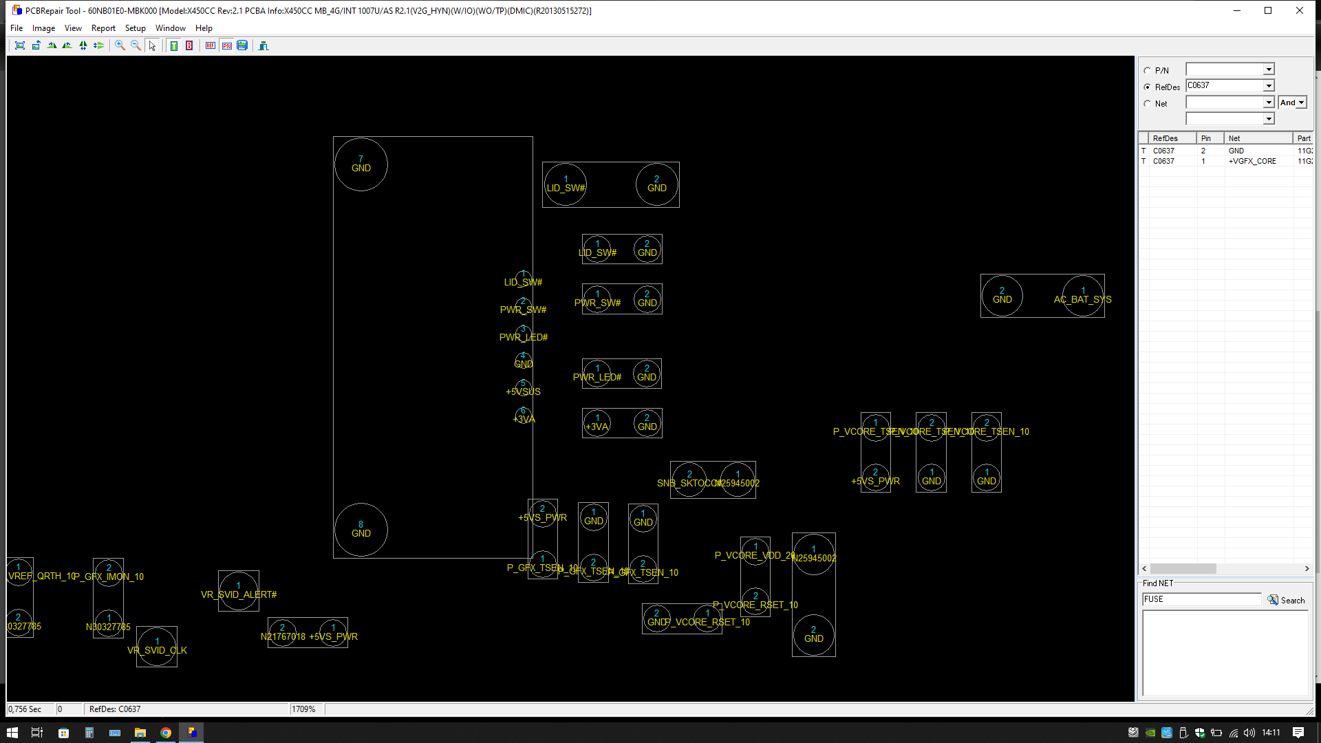

    spilled liquid on/off switch at 5v gnd connector, no response when click power button.... fuses? where to look?
    5v sus - ok
    3.3v - ok
    ???? help

      mehhh.. solved, dead magnetic sensor...jumper it and done
