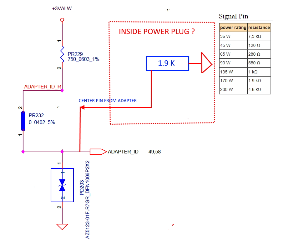

    I need to use a 175W no lenovo adapter on lenovo legion y520
    as I read on https://www.thinkwiki.org/wiki/Power...230W_11.5_Amps
    I should connect a 1.9k resistor from center pin to gnd , this create a resistor divider (1.9k and pr229) it's correct ?
    thanks

    Re: lenovo y520 adapter_id
    Yes master.
