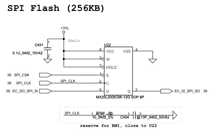

    la-6847p i have this borad it came with shorted super io ive change it form used borad now i have green light but dosent power on do i need to programme it or no kb926qf E0

    Not programmable,but it does have an external flash chip for the EC. 256KB MX25L2005CMI-12G , 25X20BVN1G , EN25F20

      now it power one but turn off in 5 seconde without displaying
