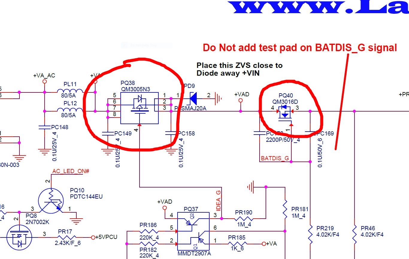

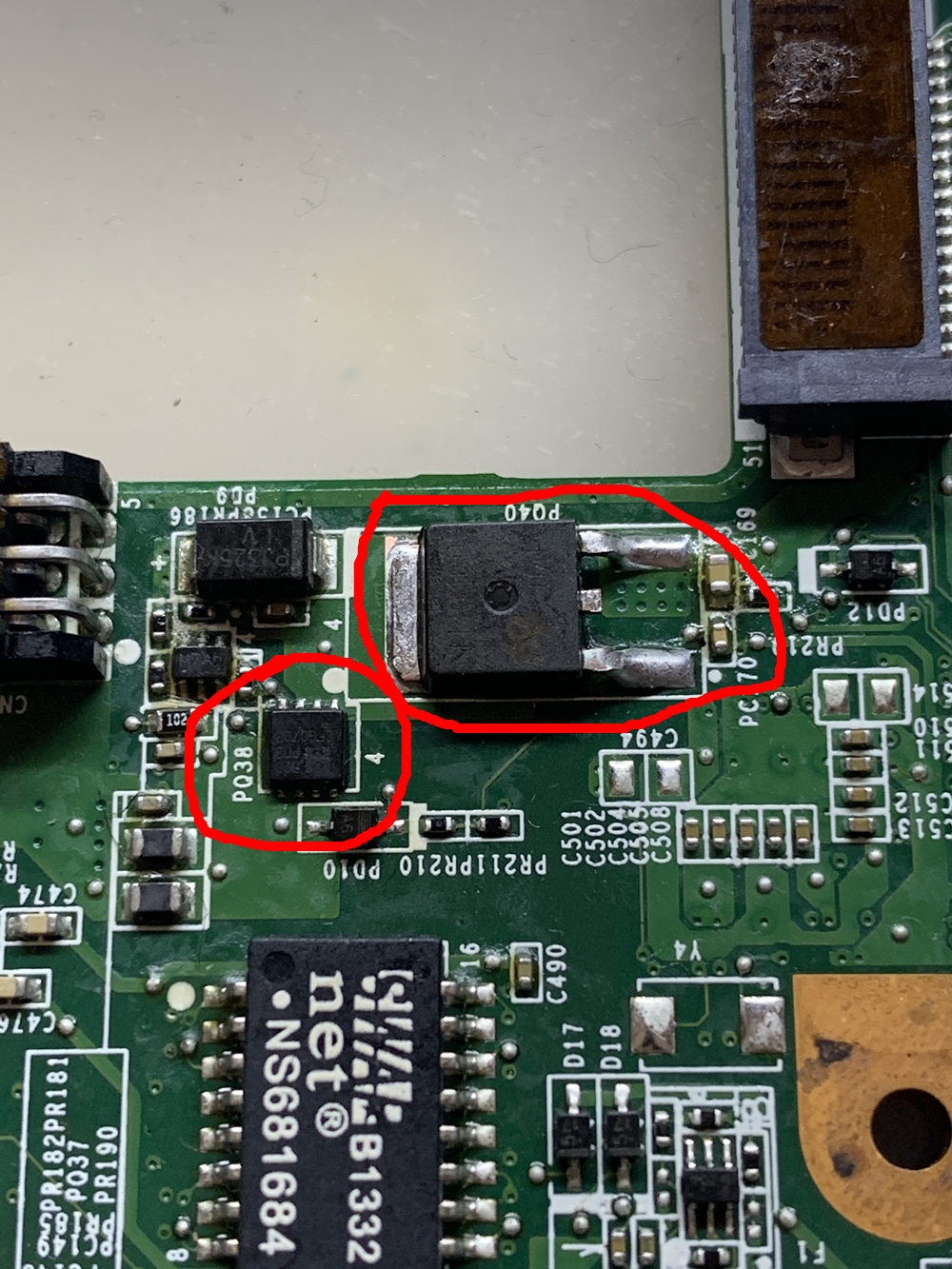

    when i press power button, amp will read 0.6a for 1 second then goes to 0.00....when i check on mosfet, gate pin getting over voltage than usual...3v and 5v also missing
    pq38 on gate get 17v and pq40 gate get 24v
    this is the schematic

    Re: HP Pavilion TouchSmart 14-B109wm Not Turning On
    The gate voltages are correct. Fault lies elsewhere.
