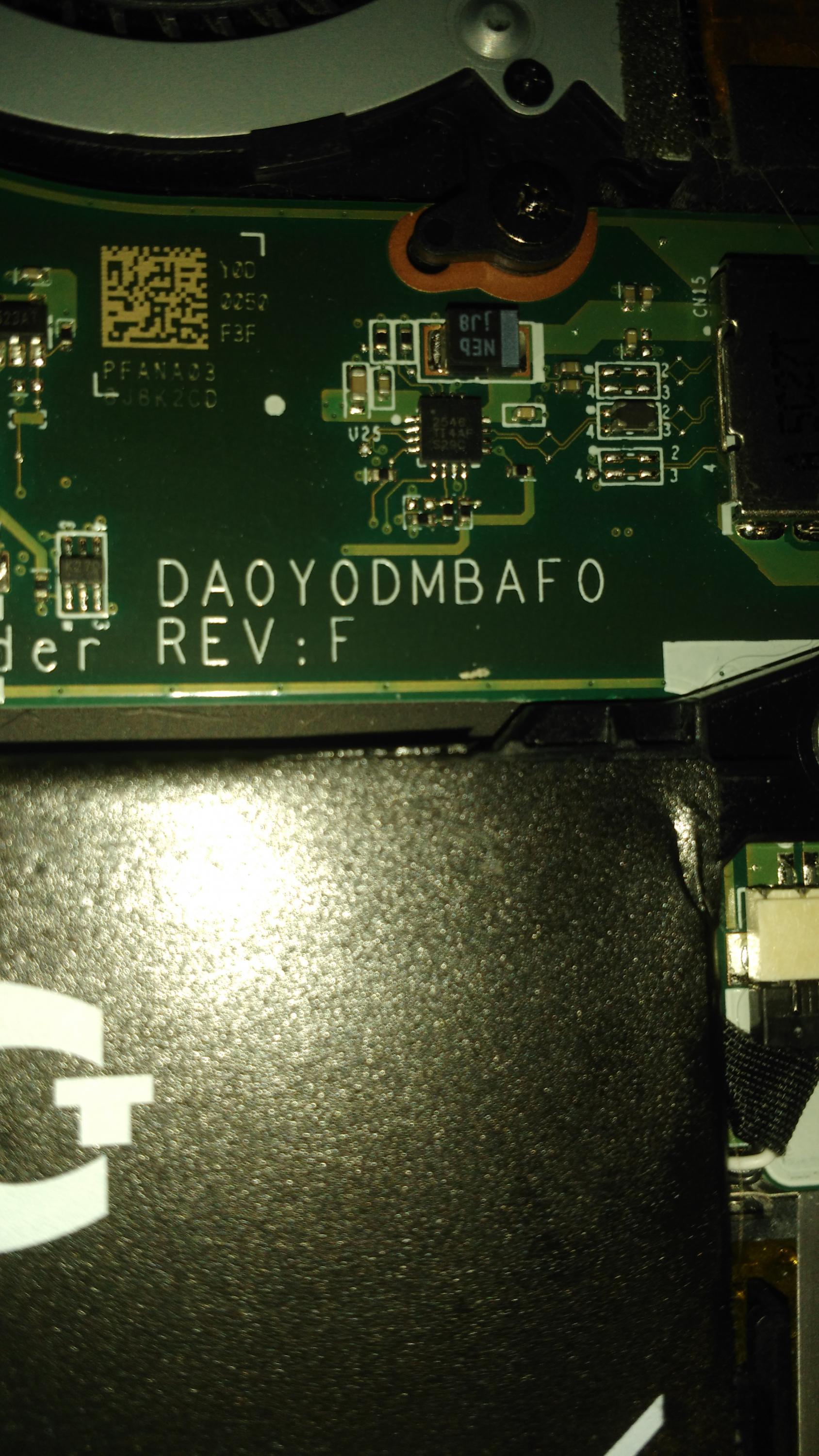

    I have a HP Spectre X360 with a blown cap and one of the trace for that cap is missing, I think. My motherboard is DAOYODMBAFO Rev. F, of all the boardview files I downloaded, none match mine, not the same for that area on the motherboard where the cap is missing, near the ssd connector.
    I just need to know the value of that cap and most important, where goes each end of that cap. I want to solder temporary an electrolytic capacitor just for testing purpose. I attach a picture of the missing cap and the boardview that don't match my motherboard, even if it's the same model ???

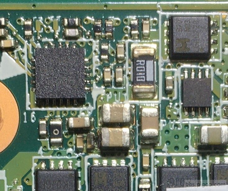

    Re: HP Spectre X360 cap identification !!!
    Originally posted by guizmo1967
    This is my first post, let's go !!!
    can you clean that area bit more and check? When I compare those 2 images, I noticed that all other parts are same except the blown area. may be Its not just only a cap. may be both cap and resistor. to confirm that try to compare the boardview with other components as well. also test their pin connectivity using continuity mode and compare with boardview. if everything match we can make sure that Im correct or not.
      That's from a good motherboard !!
      The bottom pad is GND but where goes the top pad (trace gone, I think)??
          Well, I don't have that motherboard, the picture is from the net, but I removed that blown cap myself and it was about that size !!
              here it is !!

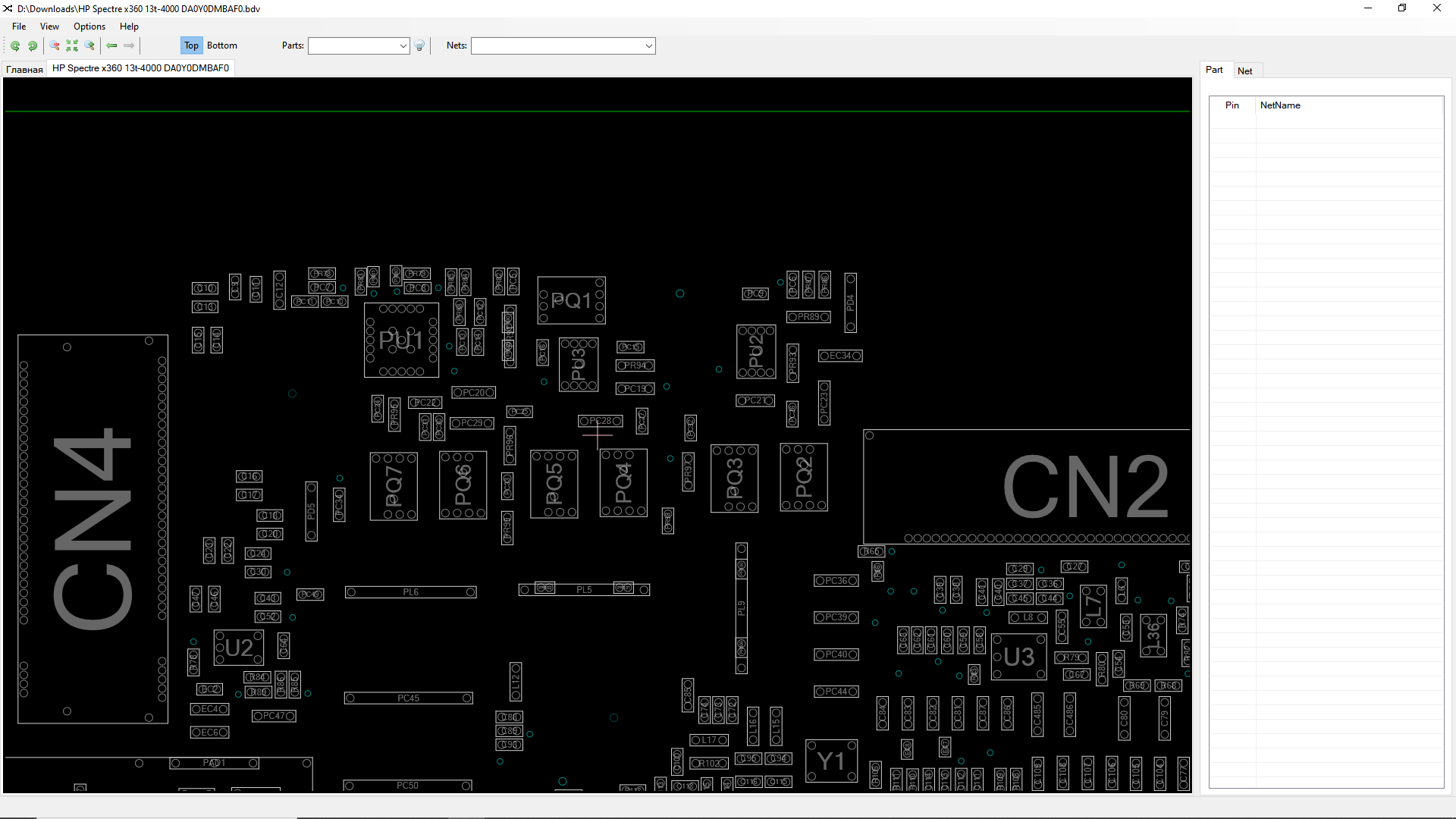

                  Re: HP Spectre X360 DA0Y0DMBAF0 cap identification !!!
                  On my motherboard, the pad (that is still there) is connected to pin 1,2,3 of PQ5 and it is ground. I THINK THE OTHER END OF THAT CAP IS CONNECTED TO CURRENT SENSE RESISTOR R010.
                  According to the schematic I have it's a 2200P/50V (PC25) that goes from pin 1,2,3 of PQ5 to a 2.2 resistor (PR96).
                  Like I said, the only boardview file I have is not the same for that area, like in the picture I uploaded !!!!
                  Should I tried to solder a 2200P/50V cap from the remaining pad to current sense resistor (R010) ???

                              How many 3V regulator on this motherboard, is it PU7 and PU8 ? PU8 does not exist on the boardview I have !!
                              If PU7 and PU8 are not 3V voltage regulator, I have no idea where they are !!!
                              They are many Nets that begin with +3V
