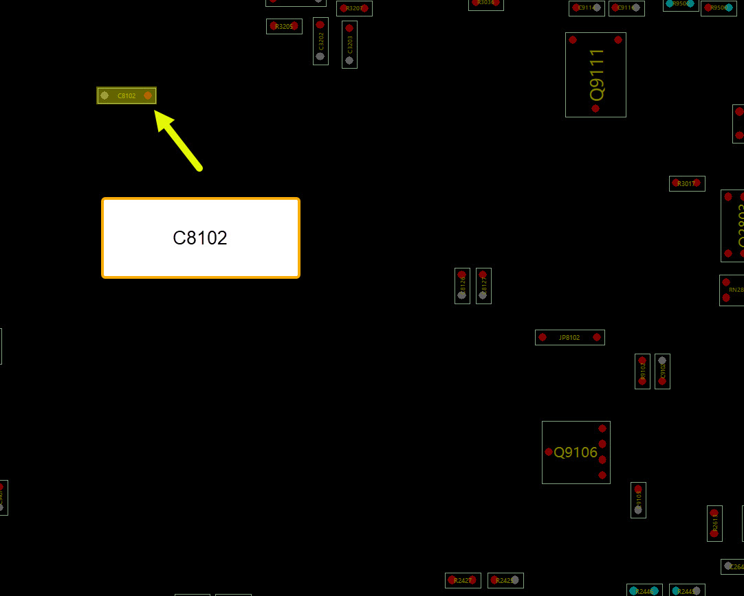

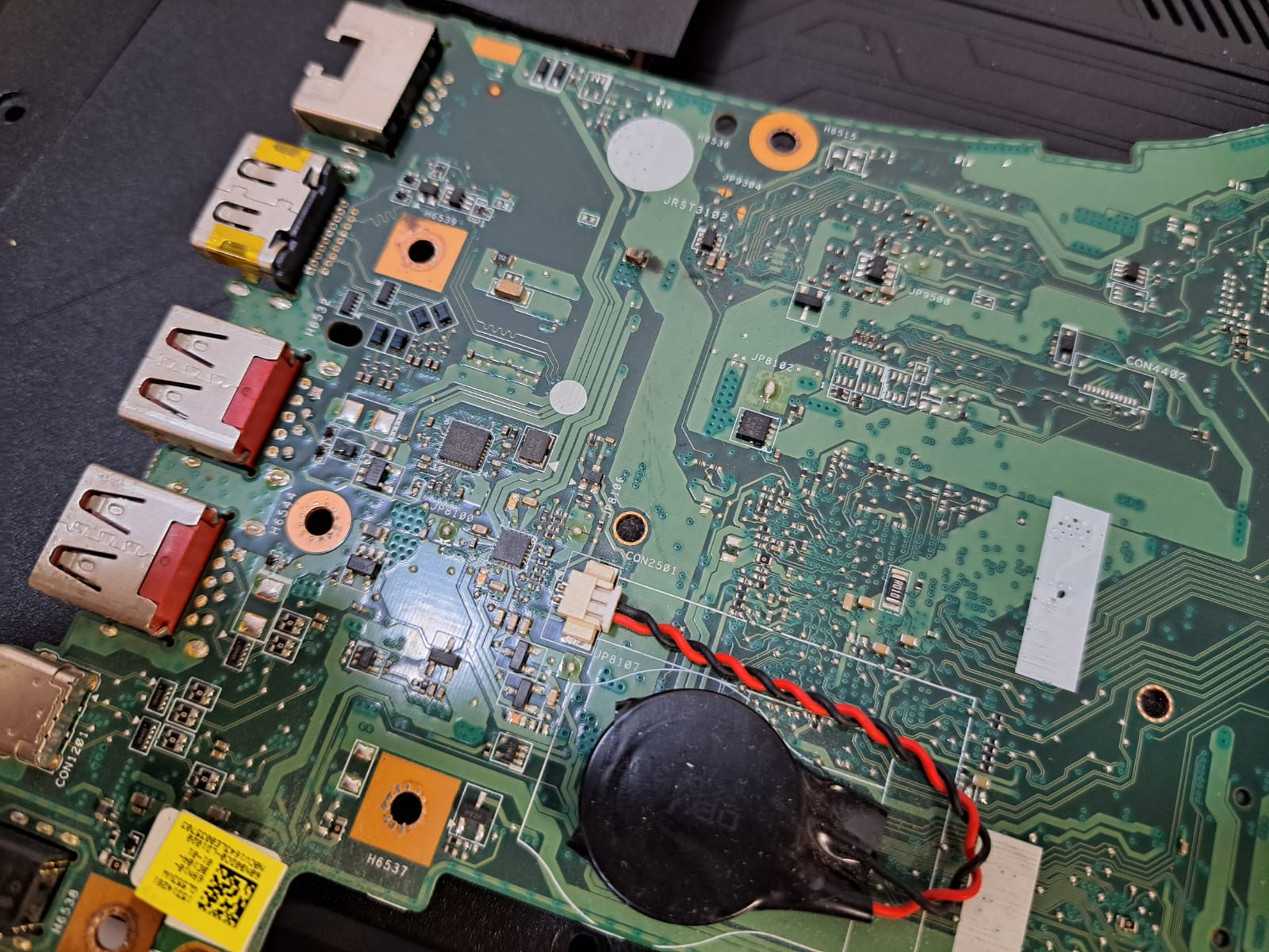

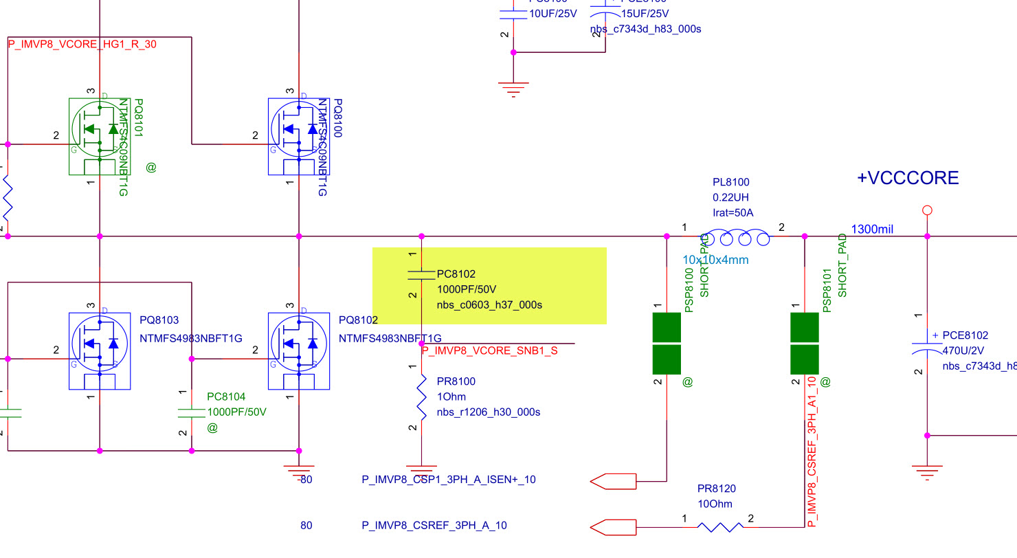

Hello Friends, Computer starts and maintains itself on if is just bios. Trying anything else, install windows our use hiren's boot, the laptop shuts down. Also found burnt damage on the laptop, one component (in foto). Any ideia what might be happening on this laptop? Thank you.
Asus gl553VW
