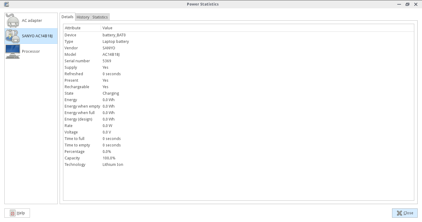

      Does the replacement battery get detected by the logic board ?
      Yes (see attached screenshot) but I've noticed sometimes not.
      When get detected, LED is solid orange and I can hear a (very weak) sort of "clack" every 2-3 seconds for about 5 minutes: in this period BT+ read 12.6-12.8V.
      After that, the weak sound disappear and BT+ falls to 1.56V

        Update: look like that the new battery is faulty because started to swell...
        I'll order a new one and report back
        Note: I've put back the original battery and now is charging a little
