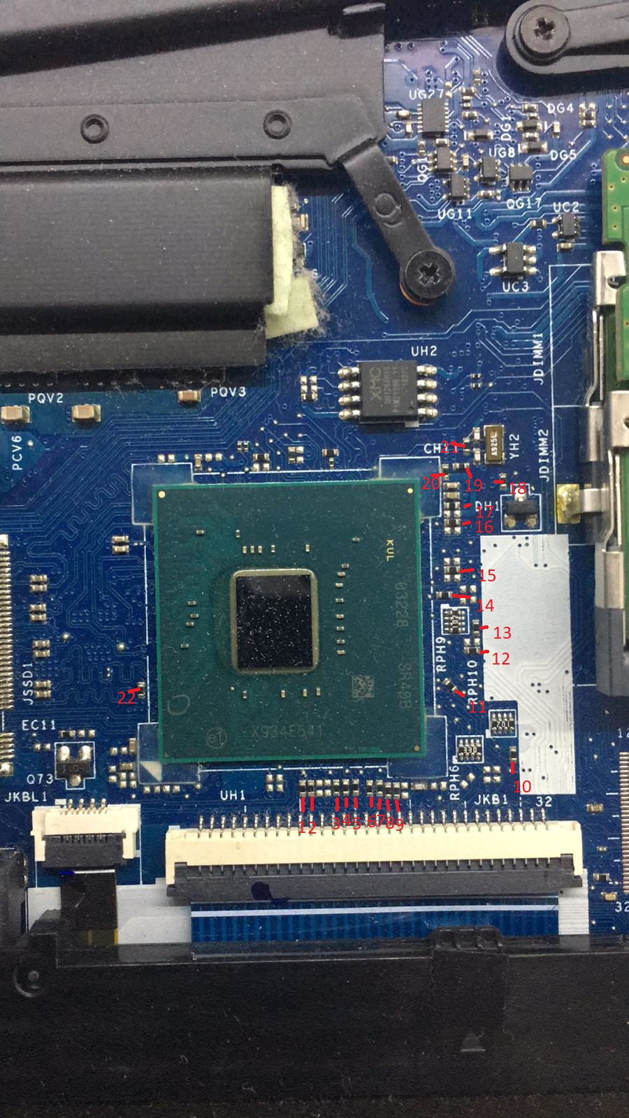

    Hello masters. I need a photo showing the placement of the components around the SR40B and the ohm values of the resistors.

      Pictures of the motherboard and the area in question (with missing components marked) might be a good start. It could be possible to assume something alone from the pics.

        Hello master, I have uploaded the photos as you said. I have determined where to place 4 resistors in the visible parts from some photos on the internet, but of the 4 resistors, 2 are 10kohm, 1 is 50kohm, and 1 is 100kohm. We need to figure out which value to insert where.

            Yes you have, but the intention of having pictures was to follow the traces to assume the rail and come to the right conclusion of the resistor value from there.
            The less you can help yourself the more clear you have to serve everything here.
            Honestly, the pics are not helpful.

                Hi, I've uploaded these so others who need it can benefit as well.
                1=0.6k
                2 3 4 5 =30 ohm
                6=17-20k
                7=4-5k
                8 9 =17-20k
                10=50k
                11=50k
                12=10k
                13=94k
                14=10k
                15=kısa devre
                16=kısa devre
                17=8,35k
                18=1k
                19=0,666k
                20=1k
                21=10m
                22=100ohm
