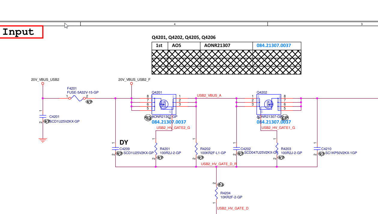

    Hi People,
    i have a really strange fault on a laptop, which i am reparing. It's a Lenovo Thinkpad L13 18834-1M.
    Visually I could see that PU4501 (TPS51393RJER-GP) was burned so I removed the IC and ordered a spare part. Looking into Schematics showed, that the IC is responsible for the 3.3V rail. I noticed, that after removing the IC there is still a short on that bus (0.4 Ohm). Furthermore PU5201 & PU4551 are also short. Voltage injection showed a huge current drawn of up to 2.5 A but with only a slight temperature flickering at U4004 (TPS22976DPUR-GP) using ethanol. I removed that IC too and the short is still present. IC appears to be fine after testing.
    Although taking the great amount of current at 3 V I could not find any component getting hot. Also CPU is not hot at all.
    Using the USB-C charger there is no input voltage present when battery is disconnected. With battery attached, I get 12V at Vin. Vin seems to not be short. EC seems to not function, since the charging LED does not turn on. However, I can confirm 12V also being present at the battery + side. So I guess it's charging. When battery is attached alone, it's less than 1 V so indicating, that the battery is entirely empty.
    Does anyone have an idea to identify the fault?
    Thank you very much in advance!
    All the best
    Cool-Oase

    See attached.
    Remove all power. No adapter and no battery.
    Meter in resistance mode.
    Check and post the resistance of the following:
    Source (1-2-3) and drain (5-6-7-8)
    Source and gate (4)
    Gate (4) and drain (5-6-7-8)
    Review the above checks on each of the DCIN mosfets.
    Post their resistance values and the scale used on your meter for these measurements.

          @mon2
          Q4201
          Source & Drain 15.22 MOhm (Meter set to 200KOhm)
          Source & Gate 100.9 kOhm (Meter set to 20MOhm )
          Drain & Gate 15.10 MOhm (Meter set to 200KOhm)
          Q4202
          Source & Drain 15.85 MOhm (Meter set to 200KOhm)
          Source & Gate 100.7 kOhm (Meter set to 20MOhm )
          Drain & Gate 15.40 MOhm (Meter set to 200KOhm)
          Q4206 and Q4205 have similar readings, i think that's why
          I rushed over it
          Thank's people!

            Re: Lenovo ThinkPad L13 18834-1M strange fault
            Can you confirm the meter scale? The readings are higher than the meter scale as posted.
            The ~100k ohms reading is considered low for the mosfet world.
            Remove the 2nd mosfet (q4202) and see if the gate-source reading changes for the first dc-in mosfet.
            Measure the removed mosfet while it is out of the circuit. Often, the 2nd mosfet gets killed in such charger designs.

              Hi there,
              the given values were correct. I simply messud up the given scale in the breckets. My Voltmeter directly outputs the correct unit.
              So I removed the Mosfet(s) and both mosfets seem to be fine. I either read nothing between gate to source & drain or shortly sth. in the great MOhms.
              Also I do not get any reading on the pads of the board, so I guess that's not the issue.
              What brings a resistance of about 0.4 Ohm?
