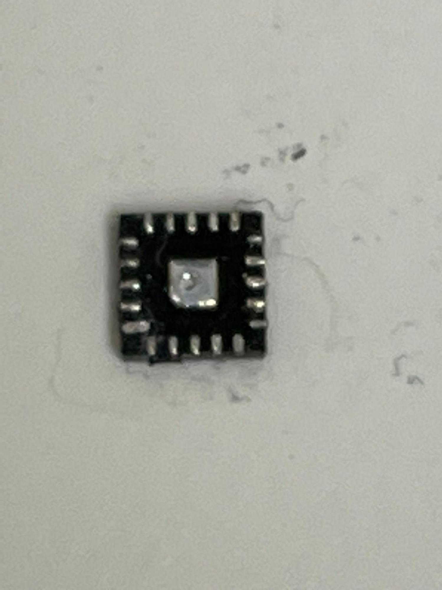

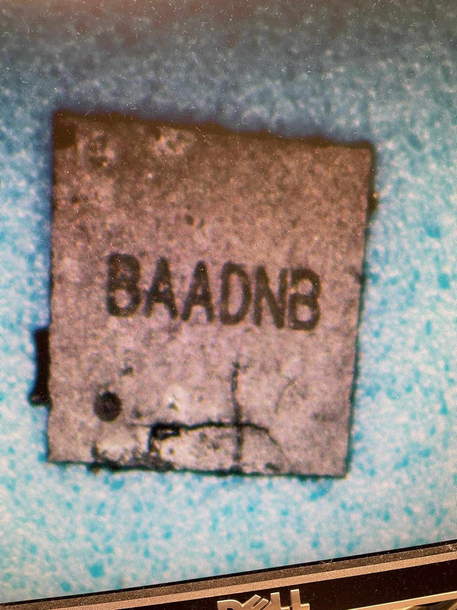

    Acer Nitro 5 AN517-54 LA-L181P
    BAADNB
    Chip Masked Need Chip actual Chip Info.
    Need motherboard schematics or the chip info.

    Re: Acer Nitro 5 AN517-54 LA-L181P
    p/n Silergy SY8286RAC
    Source from Aliexpress.
    Datasheet is attached.
    Here is a store we use:
    https://www.aliexpress.com/item/3290...d=J0vDSjppbf4G
    PS: Share the full markings from your device so that the vendor can confirm the replacement will function as per the original part.
    Comment: The above p/n is a match for your damaged device but the attached PDF as an 'A' as a suffix so there may be a small difference in the datasheet.
      The datasheet is here https://www.silergy.com/cn/productsview/SY8286RAC Marking BAA***
      It wasn`t available the last time i checked. https://www.badcaps.net/forum/showpo...1&postcount=12
        Thank you @SMDFlea. I will cherish the prize and do not wish to forfeit them but do we know if:
        The RAC is the same as the "ARAC" version?
        The datasheet is for the ARAC. The actual component is the RAC.
        The AliExpress stores reference the RAC version.
          • 21868
          The RAC and ARAC are different.The RAC pin 12 is not connected .
          The ARAC is marked AWR.
          The Ali part you referenced is the right one
