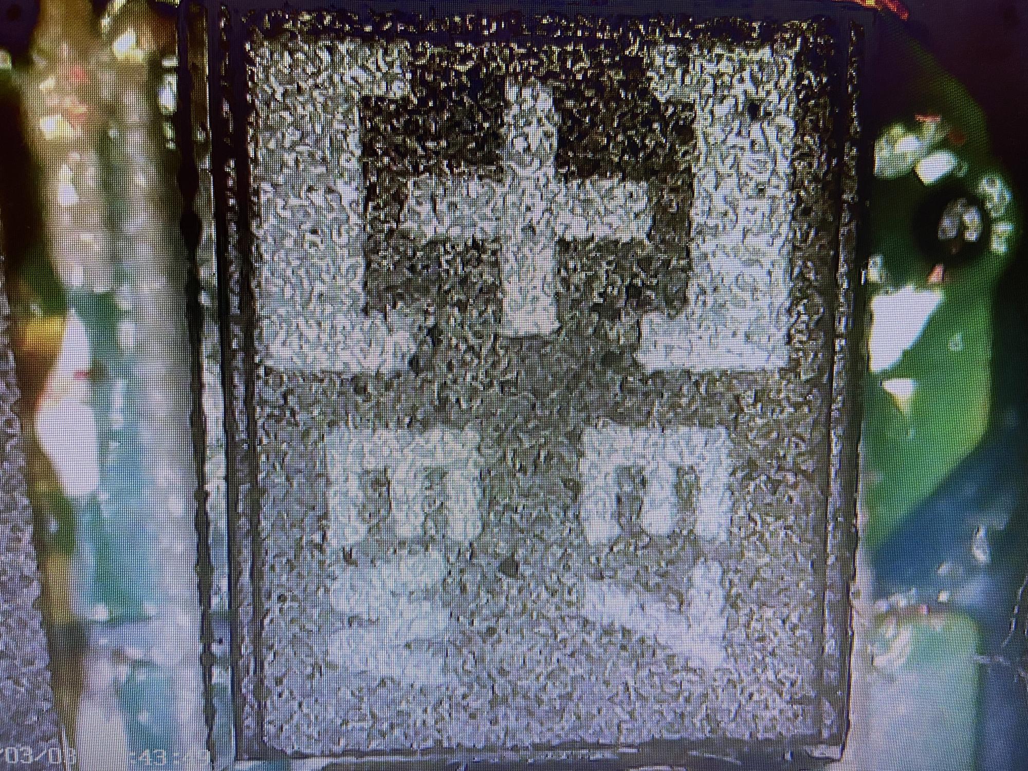

    Trying to diagnose a ASUS issue. I seem to have located some shrapnel and what looks to be a missing part. I believe its a replica of the attached part below.
    I can't seem to identify the part. Not sure if its a cap or inductor. My google-fu is pretty weak it seems. Anyone familiar with this manufacturer or part that can lend me a hand?

    Re: ASUS Q407i Component Identification Help
    Still in training under Sensei Bolo Yeung but inductors do not have polarity.
    This is a polarized e7 case tantalum capacitor.
    Zoom out in your picture so we can review what is nearby to locate a suitable value for the part.
      Seems I might be able to answer my own question... I'm thinking this is a tantalum cap. 25V 15uf.

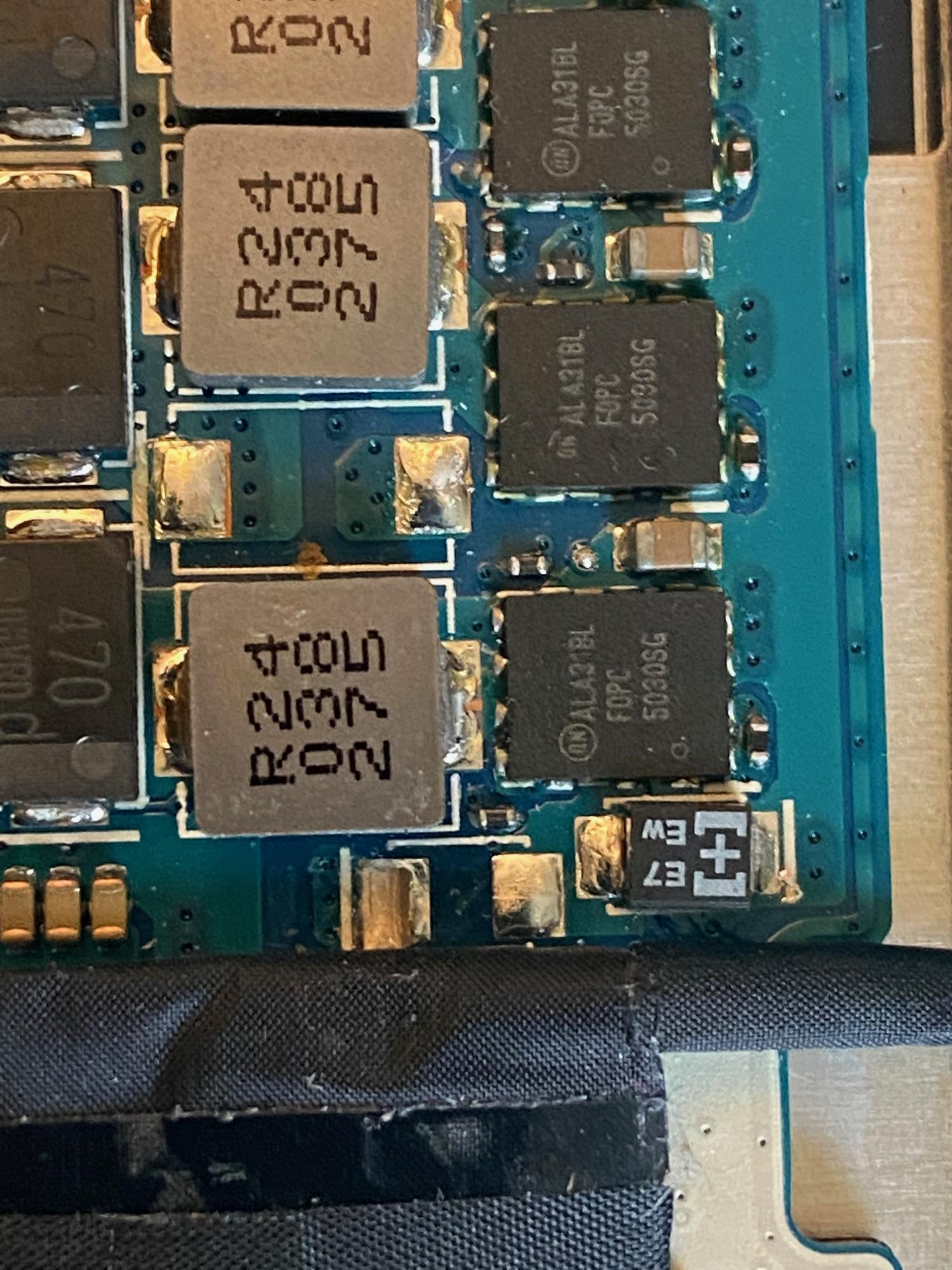

        Larger view attached. You can see the part to the left on the picture is missing. There is a single leg still soldered. It looks like the other side was never fully flowed and made inconsistent connection. Eventually it zapped. This is my current working theory

          I was able to find a full picture of the mb online
          https://ibb.co/fpRWWxx
          in the upper right quadrant, you can see the area from my picture and it clearly shows a cap missing.
          The PC does boot up -- but will hang/black screen at a random time after booting (usually 2-3 minutes but sometimes as quick as 10 seconds).
          Stanger still -- I am able to boot to a USB Ubuntu image with no problem and no hangup. It seems only when using the NVME drive that this occurs. I've already attempted to change out the NVME drive itself. No change in problem.
                Yes, that is quite possible. Try this:
                1) remove all power -> meter in resistance mode (lowest scale).
                2) use the meter probe with one lead on the missing capacitor -> the other meter lead to ground. Is the resistance ~0 ohms ? If yes, THAT pad is the capacitor's GROUND pad. Make a note of it when you receive the replacement capacitor.
                The tantalum caps are POLARIZED so the '+' MUST be on the pad that is NOT ground.
                3) Now use the meter probe on the '+' pad of the logic board and use the other meter lead on the NVME connector. Start on one side and continue to measure for each pin on the soldered connector. Do you see any resistance values ~0 ohms ?
                If yes, then you know for sure the missing capacitor is used to filter the power rail of the NVME.
                Measure the physical size of the missing capacitor area and be sure that your replacement is the same size. From earlier post, the 'E' code should define the size of the part.
                The voltage of 25V is ample since the NVME will not be this high of a voltage rail.
                PCIe bus uses 3v3 and 12v rails ONLY. We design 99.99% of our products to use only the 3v3 rail but either way, your end products will be 12v or under in operation.
