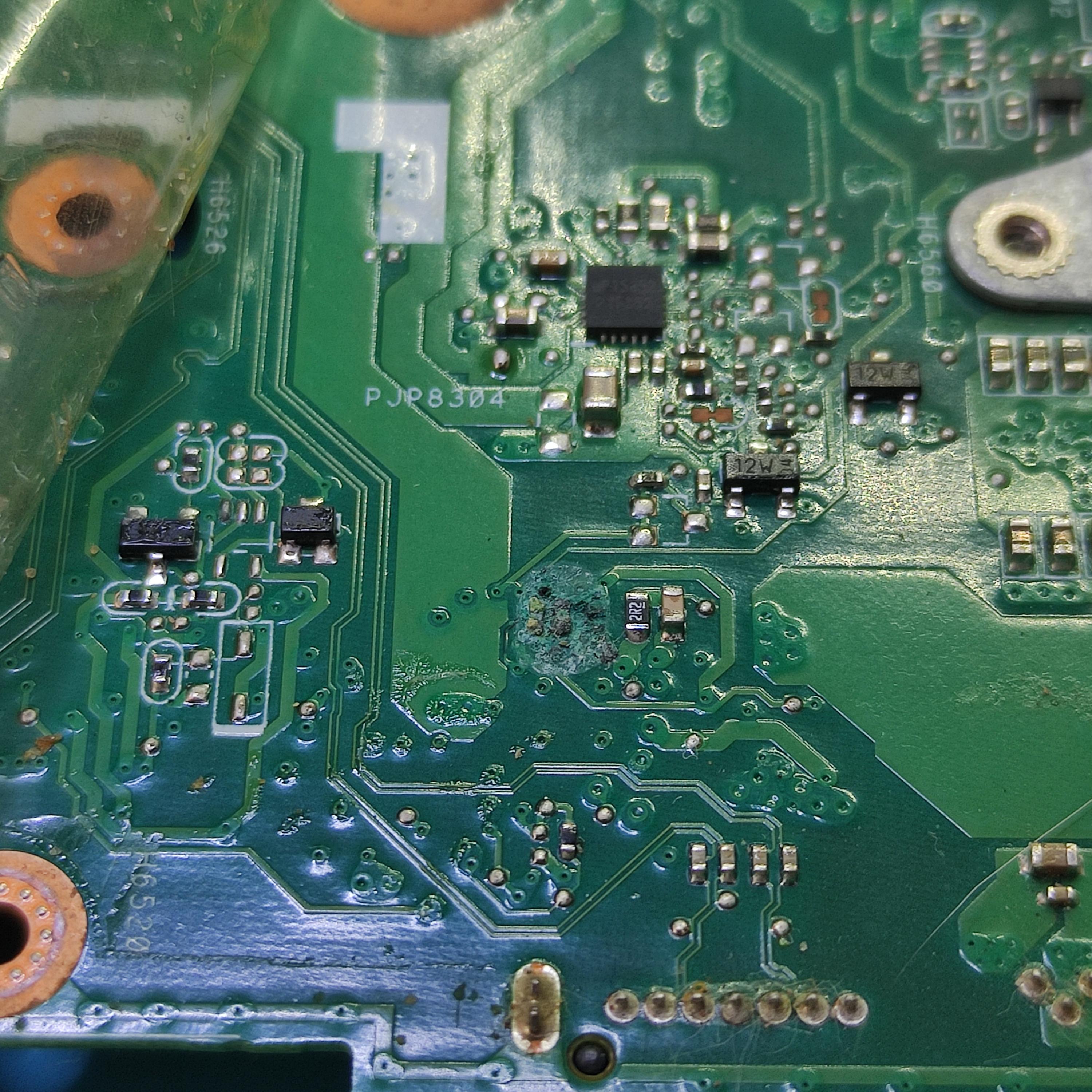

    Have a X550CC motherboard with some slight liquid damage. There are 3 corroded resistors; PR8512, PR8513 and PR8516. The first one (PR8512) is missing off the board, but very well have fallen off. I don't have a donor lying around to compare to.
    The boardview gives me no indication what value these are. So if anyone has one of these boards lying around to measure what values these resistors are it would be greatly appreciated.

    https://www.badcaps.net/forum/showthread.php?t=108688

      Thank you, this boardview is different to the one I had and does show the values.
      This section is under a plastic sheet so I'm thinking it's more likely to be a dead bug decomposing etc.
