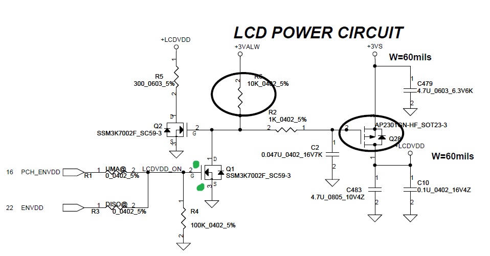

    Hi everybody,
    I have a problem with this Aspire 5750G P5WE0 LA-6901P Rev. 2.0.
    Everything works normally, but displays only on the external monitor and not on the integrated one.
    I found a short in the Lcd Power area, exactly on the Motherboard pitches of Q1 2 and 3 in short (with component detached).
    No voltage arrives on the LVDS connector on pins +LCDVDD 24 and 25.
    I think the enable of PCH_ENVDD is missing, but I can be wrong.
    I have an identical card in perfect working order, so I was able to do all the measurements, but I couldn't solve anyway.
    Is there any way around this problem?
    Can anyone give me some advice?
    I'm afraid the problem is serious, but I await someone more experienced.
    Thanks to anyone who wants to participate.

    I was thinking something.
    At the moment R3 is missing and from the scheme this would lead ENVDD to Q1.
    What if I move R1 to station R3? Could this work or am I in trouble?
    I noticed that by removing R1 the short on the pins of Q1 disappears.

        Try this (only for testing) - remove R1 and be sure R3 is not present on the board.
        Then with a wire, connect pin #2 of Q1 (2N7002 mosfet) and connect it to the +3VALW rail.
        This will then turn Q1 ON and emulate the signal that appears to be missing from the PCH_ENVDD signal line.
        BTW - if R1 is stuffed, then you have UMA mode on the logic board. Is this how the logic board was assembled ?

                Remove this gate wire used for testing. Do not stuff R1.
                Reflow Q1 with flux and low air pressure.
                No power to the logic board.
                Check resistance to ground on pin #2 of this mosfet.
                What is the resistance?
                Consider to replace Q1, it is a very common part. This is the 2N7002 device.
                Of concern is why the gate is not being driven through R1 and the upstream PCH signal.
                The short between pin #2 and #3 of Q1 should not be there. I recall a pull down resistor on the gate - remove it. Presently do not have the schematic loaded but check this resistor as well to fix this shorting issue.
                You can also check the diode mode reading of the pch output pin. No power. Meter in diode mode. Red meter lead to ground. Black to the floating R1 pin that is to the PCH side.

                    I did the tests you suggested.
                    With R1 detached (if I understand correctly) on pin # 2 of Q1 resistance to ground OL.
                    Then test in diode mode on pad # 1 of R1 (always detached) 1108.
                    The output pin of PCH_ENVDD is on R1.
                    In fact I imagined it was serious, just because Q1 is not driven and does not activate LCDVDD_ON which would turn on the display, if I'm not mistaken.
                    Even if you want to replace Q1, the short remains anyway, the main problem is that.

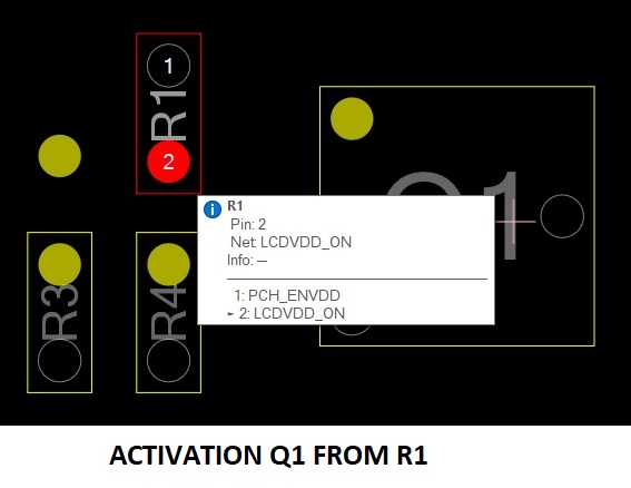

                        The short comes from pin # 1 of R1, which would be PCH_ENVDD, with or without Q1 the short is always present.
                        But that ENVDD which is on pad # 1 of R3 (R3 is absent), cannot activate Q1 equally?
                        Because at this moment it is as if it were deactivated, given the absence of R3.
                        On pad # 1 of R3 comes ENVDD, if you close this point, on the boardview, it tells me that it would activate LCDVDD_ON, just like it does with R1.
                        If I close this point, could it not activate Q1?
                        But maybe I'm saying nonsense, I attach pictures.
