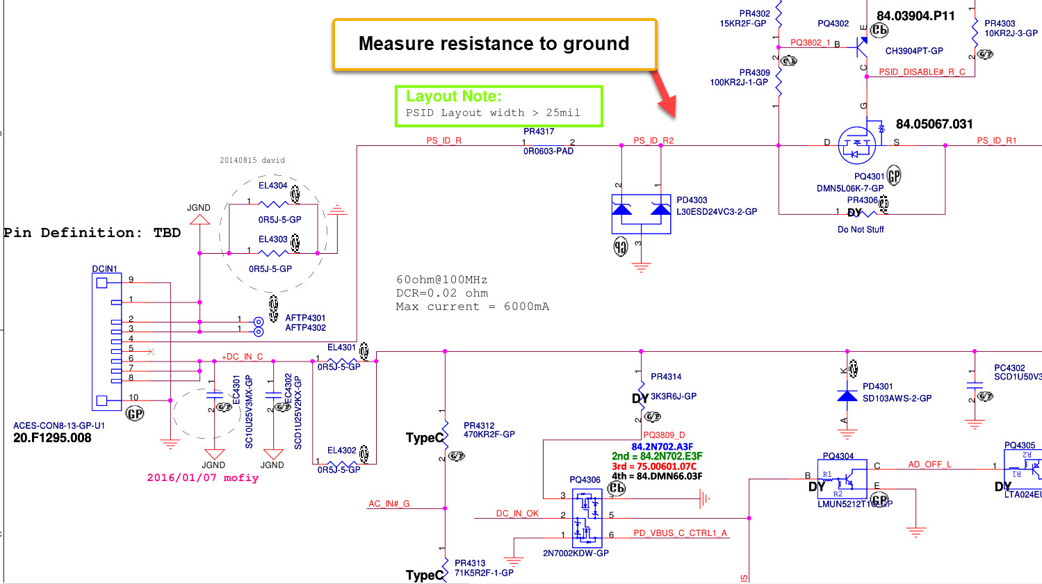

          Today I tried with the original power supply, the dell test tells me the power supply does not work at 100% and it does not work well battery but close to replacement, although it still does not charge the battery and the performance is very slow, on the connector of the mobo to the power jack I detect 19.5v and 3.20v on the central. What can I do? Thank you
          • mon2
            • Dec 2019
            • 13987
            Re: Help Notebook Dell 15 5568
            Remove all power.
            Meter in resistance mode.
            See attached. Check the resistance to ground of PS_ID_R.
            So meter lead on the dual ESD diode (PD4303) and other meter lead to ground.
            What is the resistance ? Also, post the meter scale used for this test.
