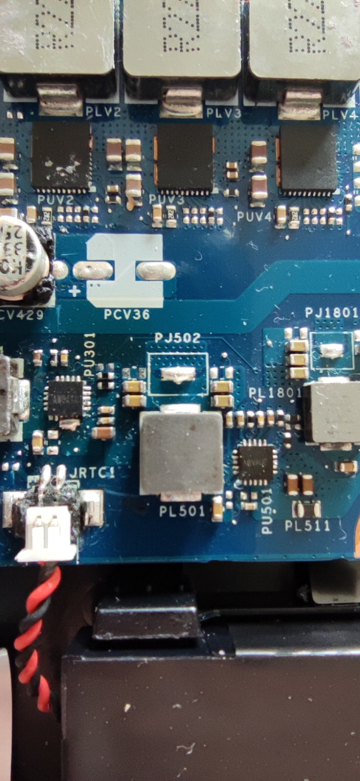

    Hello
    Got the above laptop I am trying to diagnose/repair.
    Got 19v in all places of the board it seems. However I am definitely missing 5v as I also have a working version and 5v is not present in places it should be on the working one with just the charger plugged in. I have found a large black capacitor on this line shorted to ground.
    I was thinking of voltage injection into this capacitor but being a relative noob on laptops I would appreciate some advice please.

        Re: Acer Nitro 5 an515-55 dead laptop no lights
        Hope, that that wasnt an inductor. Can you provide a photo of board and that element?
          Just added a photo of the coil removed.

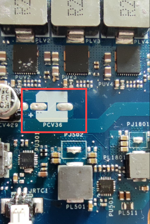

            Was the part @ PCV36 removed ?
            That is an electrolytic capacitor footprint.
              I didn't remove it, however I have a working version of this laptop that does have that second capacitor in place. It does have a slightly different version number, I assumed it was because of this. I bought the laptop second hand as non working and it has definitely had some work in this area.
