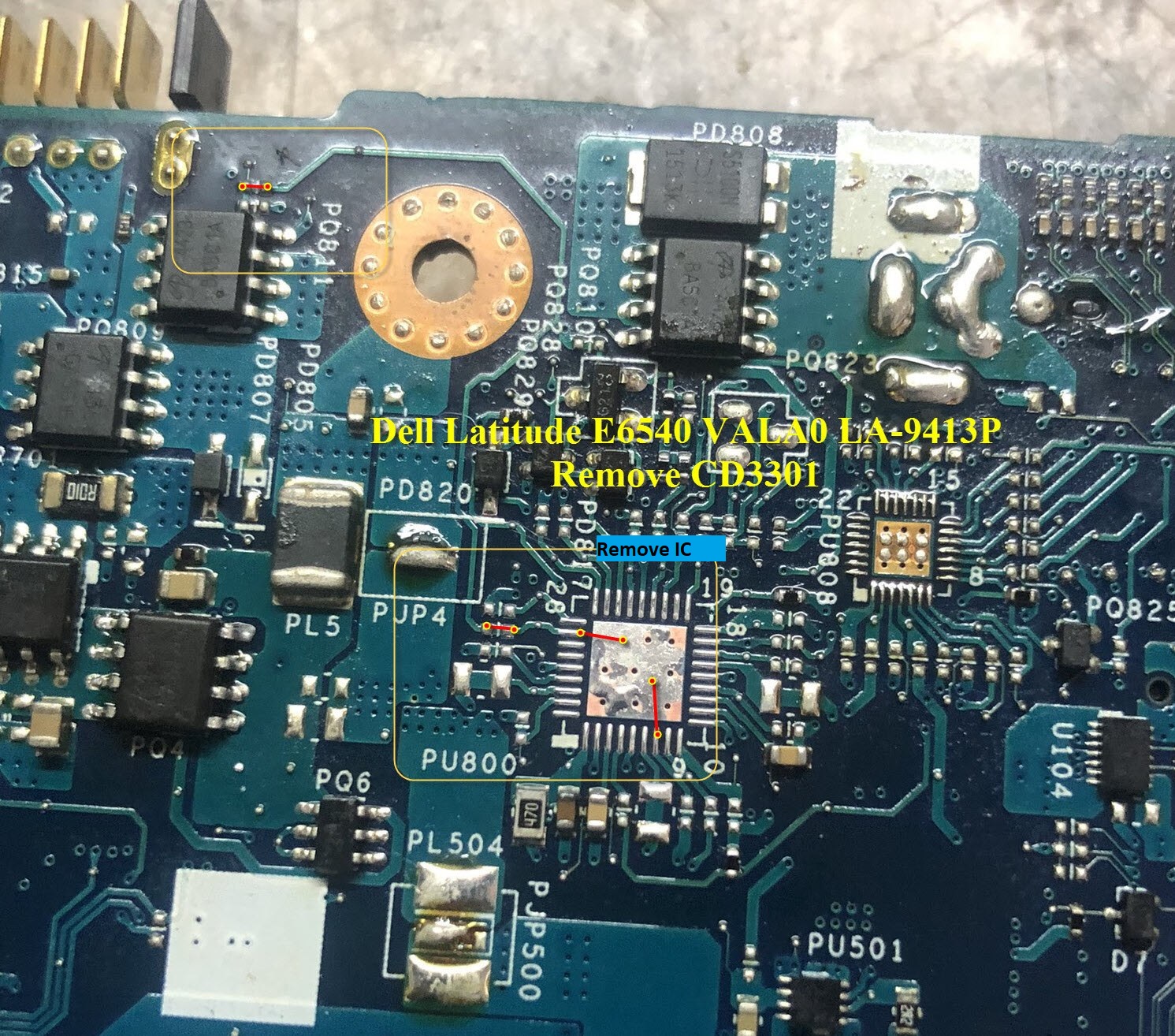

    Dell e6540 - vala0 la-9413p power issue
    ic pu800 cd3301 damaged and there is burnt traces
    under it how to make the laptop power on without this ic

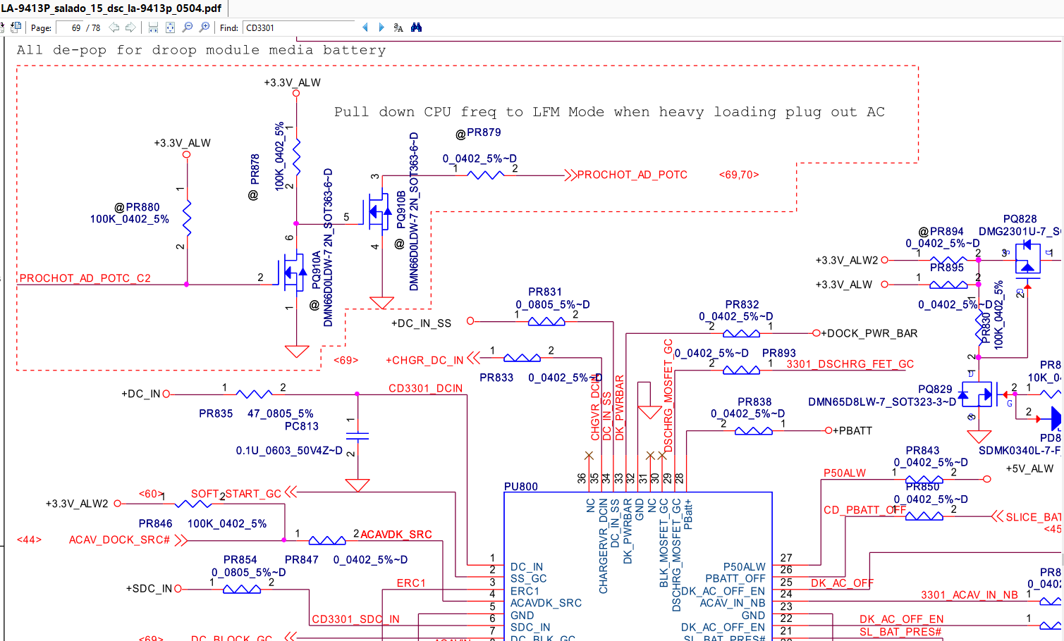

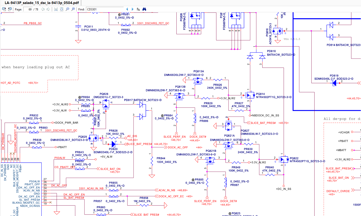

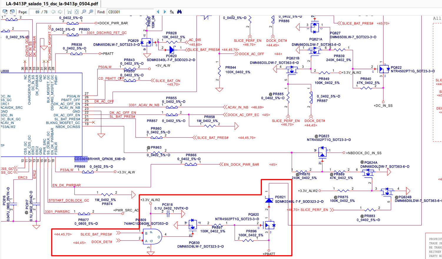

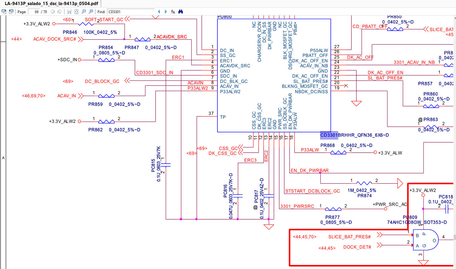

        Re: Dell e6540 - vala0 la-9413p power issue
        See attached. From my paid (locked) sub.
