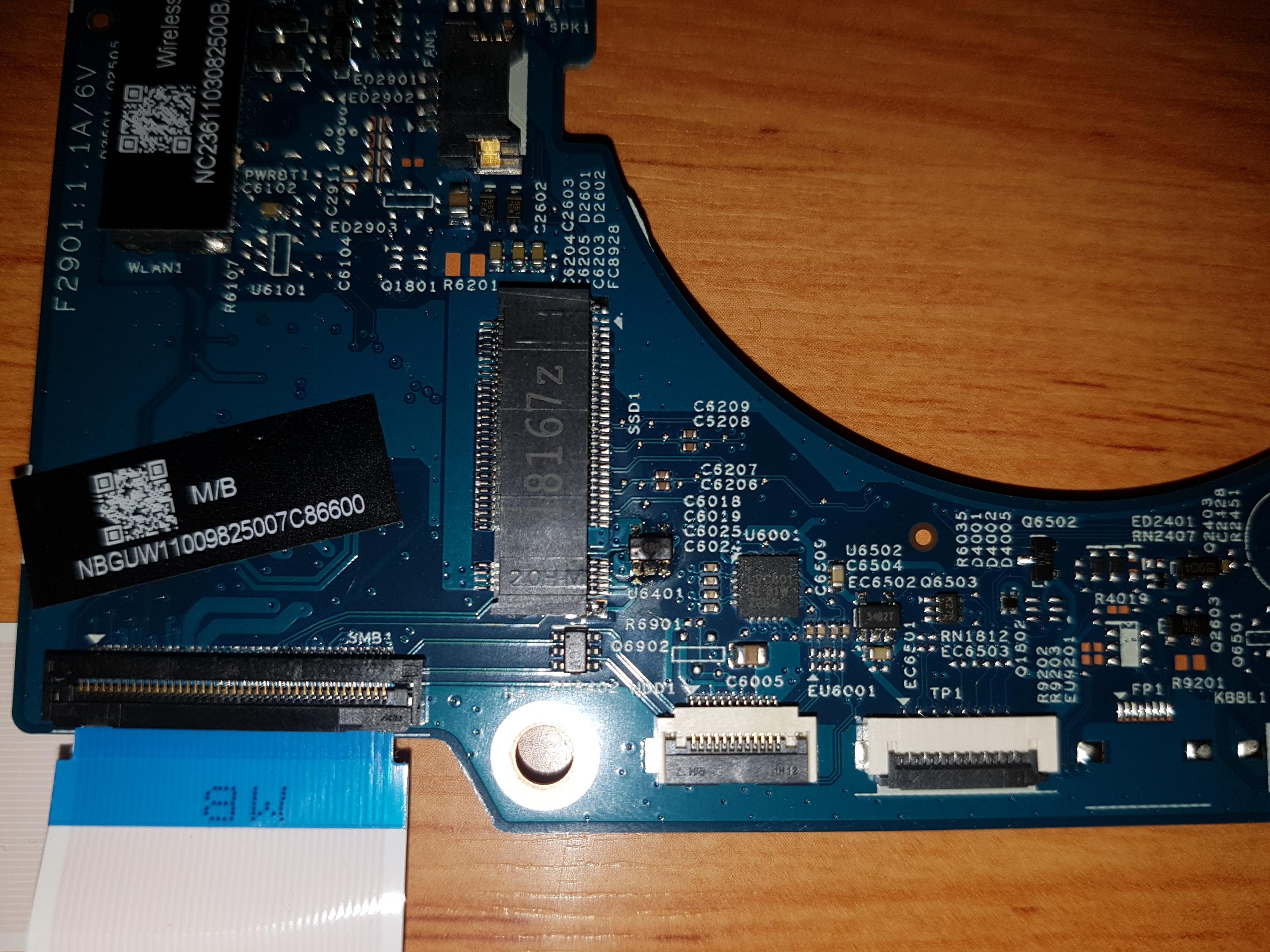

    I've got a problem with the same model.
    Acer Spin 3, N17W5;
    MOBO: Slinky MB 17893-1
    Does anyone have maybe a schematic and/or boardview?

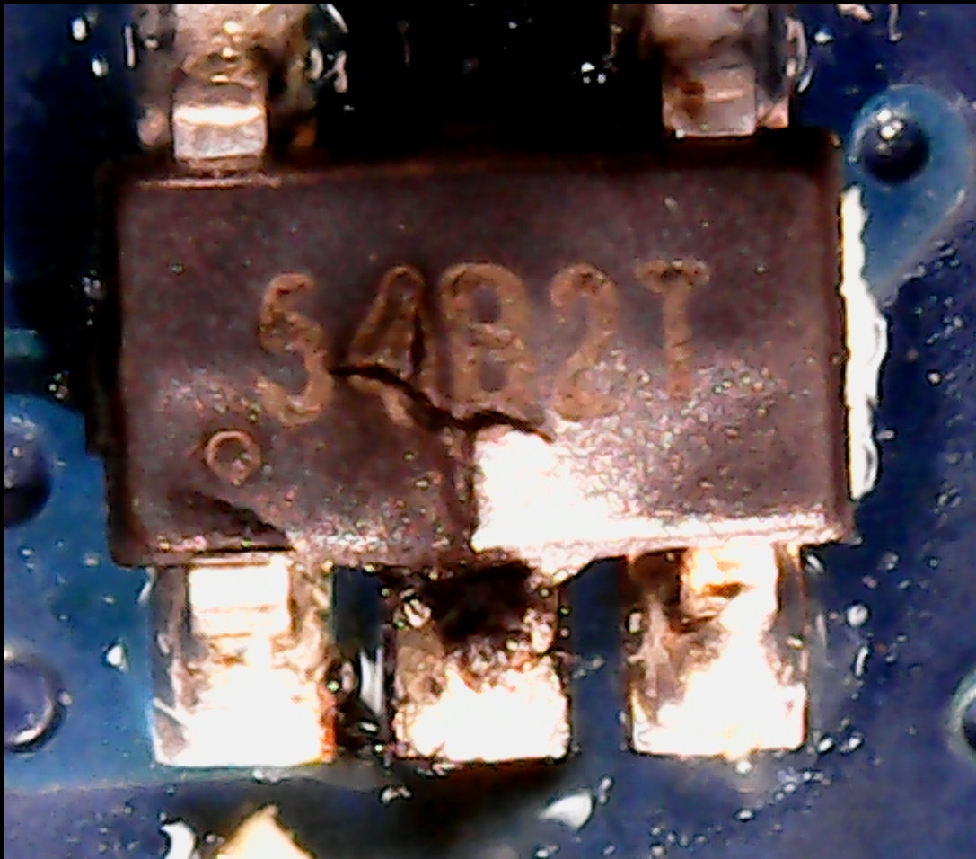

    I've got a burnt component.

    Re: Slinky 17893-1 Schematic needed
    Which component is burnt out ?
    Have access the attached which may be similar ?
    Update - Found a schematic - which part are you after ?
      Its U6401, but more important is why it blew up...

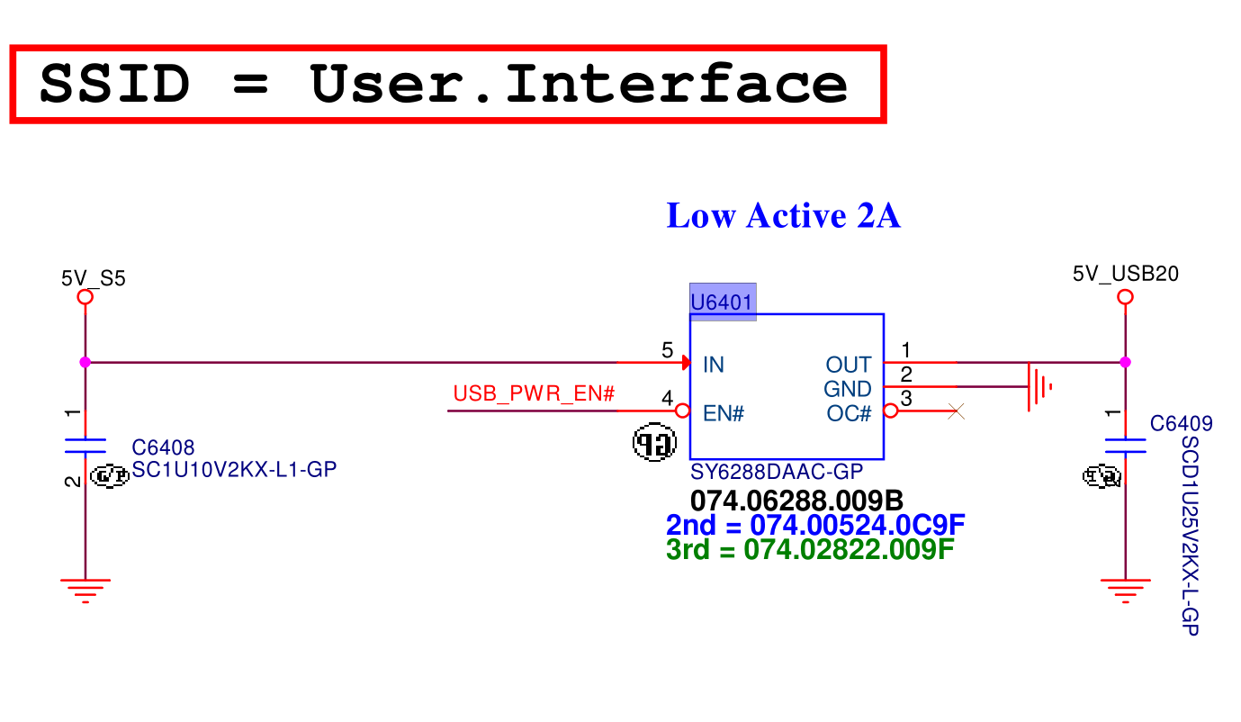

        U6401 = Silergy SY6288DAAC.
        It is a common USB load switch that can be replaced with many others including Diodes, etc.
          I've desoldered it, and pin 4 has 9 Ohms when measured to ground...
          I think its too small. What do you think? Maybe its shorted somewhere else?
          This blew up, when user pushed the "battery reset" button on the daughter board which also has 1 USB 2.0 port, audio jack, sd card reader, LED's and power switch (so it must be connected).
            Is this on the logic board with the defective U6401 part removed ?
            If yes, then the EC component may be defective.

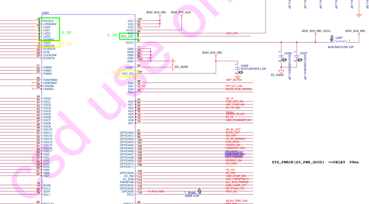

            USB_PWR_EN# is driven by U2401.

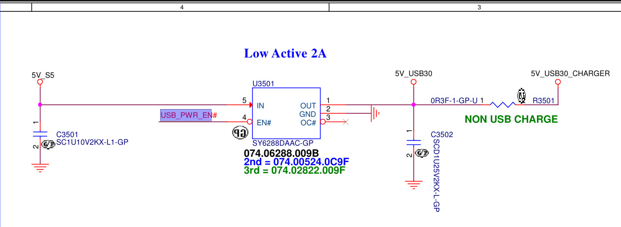

            Locate the next USB load switch @ U3501.
            What is the resistance to ground for pin # 4 for that device ?
              The U6401 probably powers the daughterboard USB 2.0.
              U3501 pin 4: 9 Ohms resistance to ground without desoldering.
              It's on the opposite site of the board, and its for USB3.0.
              Next to it, theres one more EU3503, with 6 pins, probably for second usb 3.0, and pin 5 has also 9 Ohms.

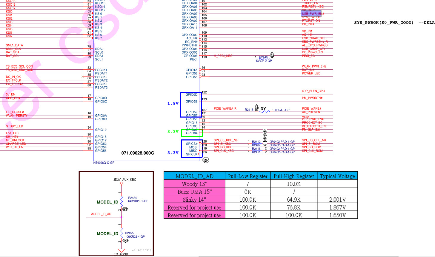

                Can you please send a screenshot of the Daughterboard schematic? its connected to IOCN1, theres a battery reset button, and U301 IC, and few other.
                I'm thinking that maybe something there is broken.

                    Re: Acer Spin 3, N17W5 MOBO: Slinky MB 17893-1
                    I've desoldered the U6401, and tried to run the motherboard with small amperage, and the U3501 near USB3.0 gets to 120 degrees celcius very quickly. So something else is wrong here. Is there any way to get the schematic for this board?
