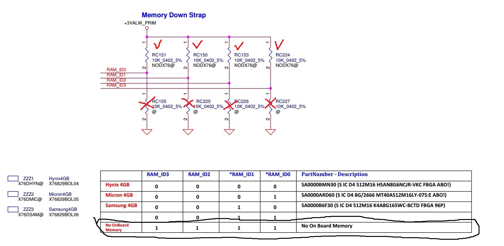

    acer a315-56-31 la-j801p-rev 1.0 disable RAM

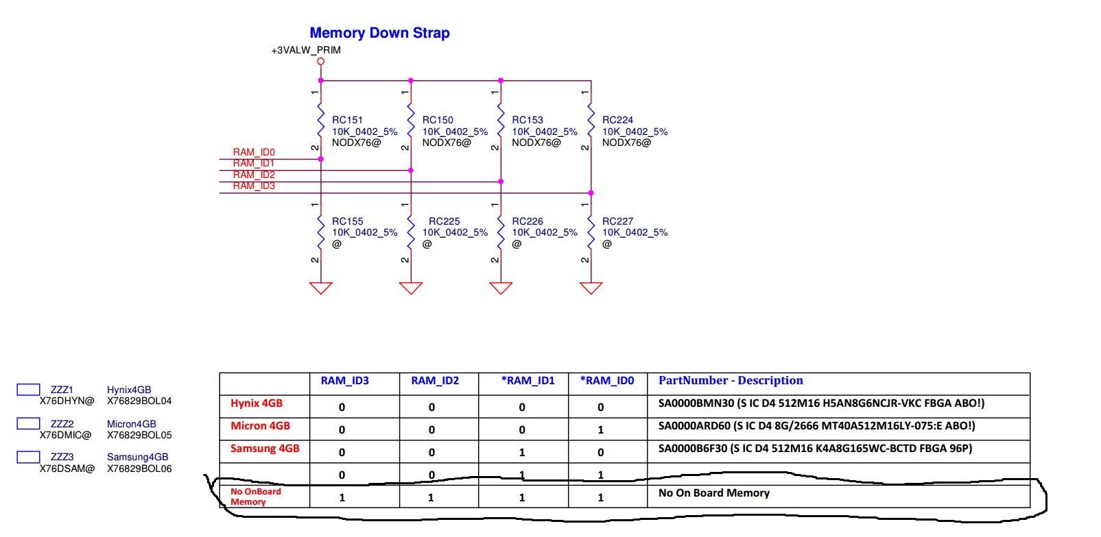

    Hi everyone ....
    acer a315-56-31
    la-j801p rev 1.0
    how to properly disable RAM ?.. . bios flashed but no change .. problem no image .

    Re: acer a315-56-31 la-j801p-rev 1.0 disable RAM
    Originally posted by Djamalhan
    Hi everyone ....
    acer a315-56-31
    la-j801p rev 1.0
    follow page no.12 in schematic
      I already tried this option .. there are more thoughts ?
      • mcplslg123
        • Jun 2015
        • 7262
        • india
        That's the only option to disable ram and it works. Either you are doing it wrong/understanding it wrong and/or you have another problem. Please specify what resistance combination you have shifted.
          problem . no picture .power is everywhere .. looks like cpu problem ...
                Originally posted by wws911
                hi how did you do it?
                i dont understand what is need to be moved
                1= high logical level signal
                0= low logical level signal

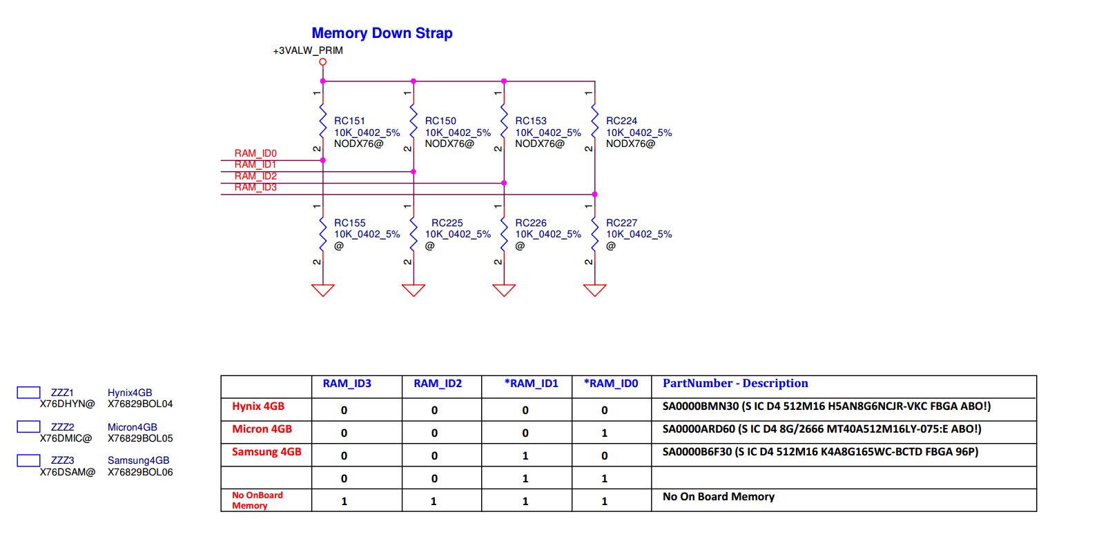

                  FH5LI LA-J081p REV:1.0
                  How to disable on board ram wich resistors
                  please help
                  • mcplslg123
                    • Jun 2015
                    • 7262
                    • india

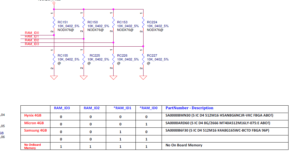

                    Page 12 of schematic has the table for disabling onboard ram.
                    Both schematic and boardview is available on this forum.
                    However, if you still can make it out, specify the ram markings on your motherboard.
                    • SHIBIL MA
                      • Sep 2021
                      • 29
                      • πŸ‡ΈπŸ‡¦
                      RC151 shifted RC RC155
                      RC150 shifted RC 225
                      RC153 shifted RC226
                      RC224 shifted RC227
                      WORKING DONE
