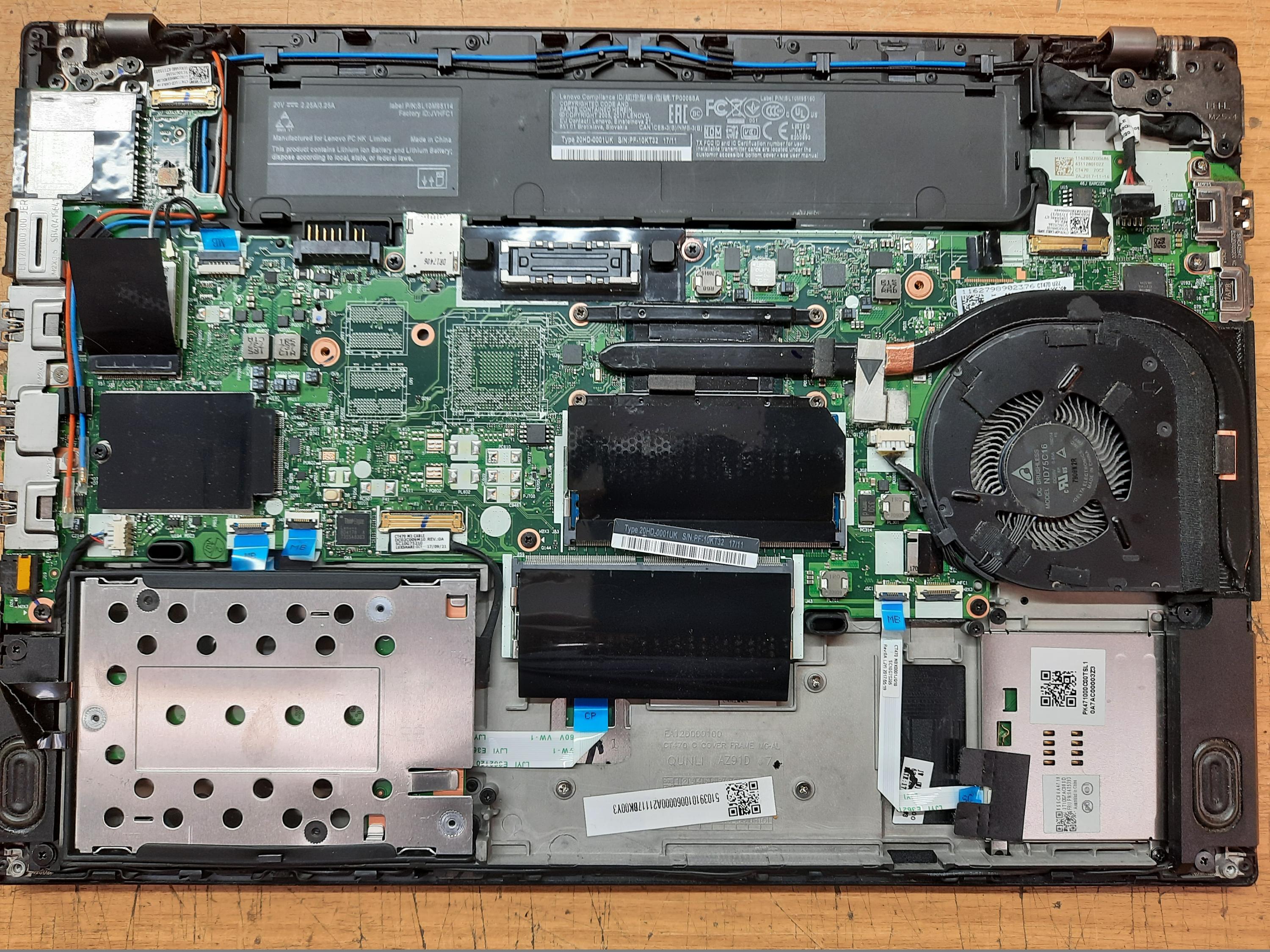

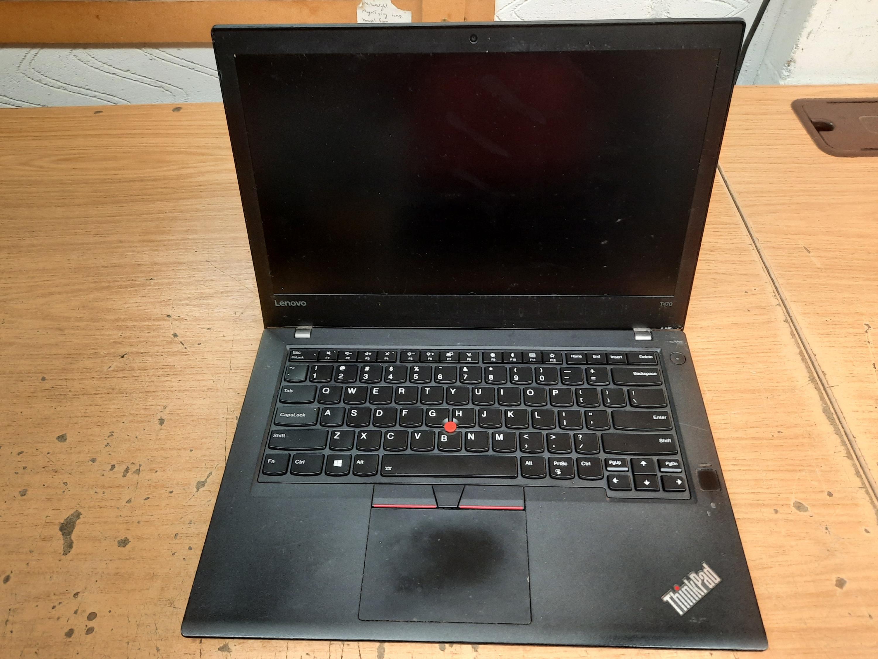

    Hi all
    Laptops not really my thing , but here we go .
    Can take signal out to a monitor & display present .
    Also can see a very faint image on the laptop display .
    Customer has already replaced entire display , thinking backlights had failed , but that doesn't seem to be the case .
    Hoping for a protection fuse ,but could potentially be the inverter drive circuitry .
    Anyone experienced on these ?

    Find the motherboard part number and look for the schematic on the forum,look for the fuses at the LVDS connector.Did the full display have another LVDS cable

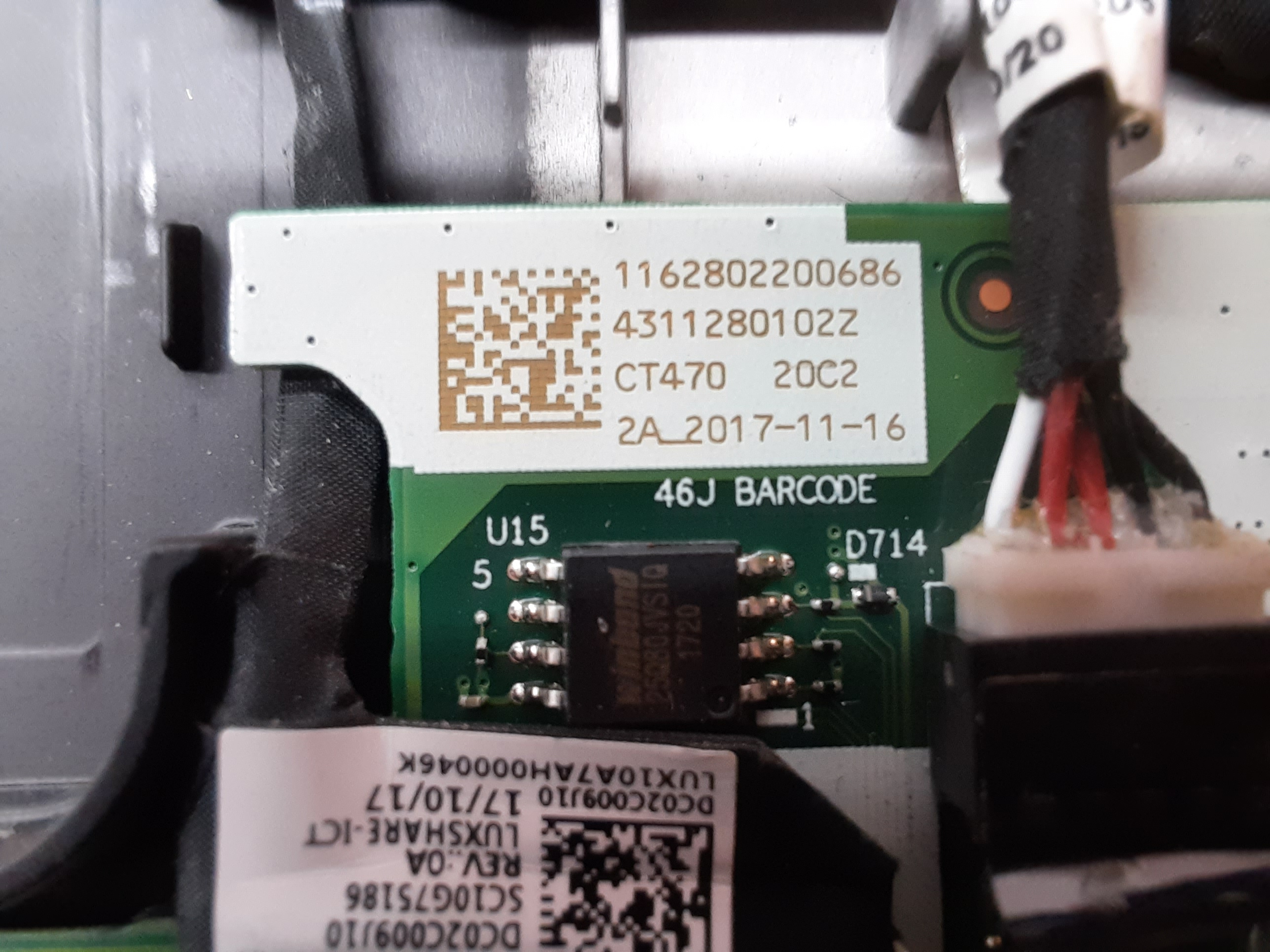

        Re: Lenovo T470 ,no backlights advice.
        Hello again
        What number am i looking for ?
        Please see attachments .
          3 amp fuse marked P o/c
          • zen
            • 511
            Well fuse replaced , but still no backlights .
            Just trying to work out a point i can check supply from , now that board fitted back .
              Hi, what voltage do you have on pin 23 of your LCD connector?
                Hi , will check , but looks like i'm now having different issue .
                Seems to be cycling , as the fan start / stops .
