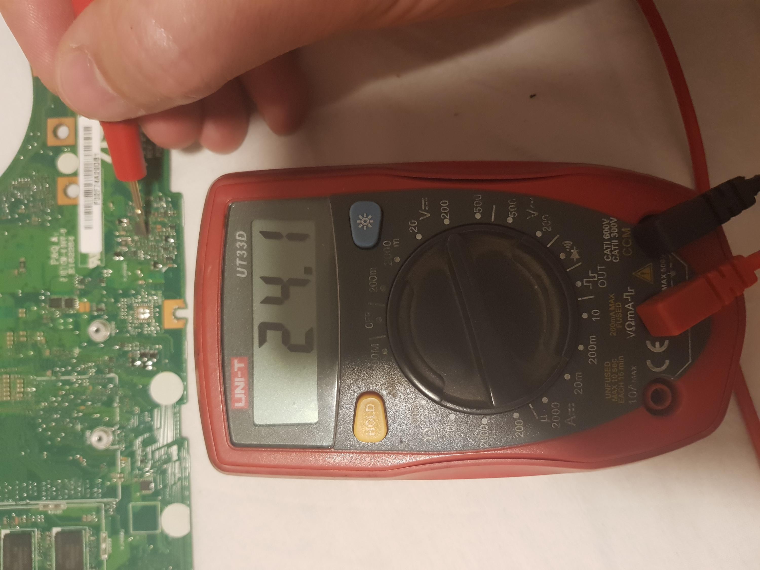

    Re: Asus pro p3540fa
    Code:
    ACDRV Not sure, multimetwr show 1
    Hi. The '1' is the way your meter is reporting that the voltage scale is too low. Switch to the next higher scale on your meter and test again.
    Perhaps you are using the 20 volt scale?
    This is a good sign. Note that to turn ON the mosfet, the gate voltage should be about 6 volts higher than the voltage being passed through the mosfet between source & drain.
    The charger IC boosts the adapter voltage to drive the gate pin if all is well.
    Monitor the voltage on source. Then drain after the confirmation of the true gate voltage. Post your readings.

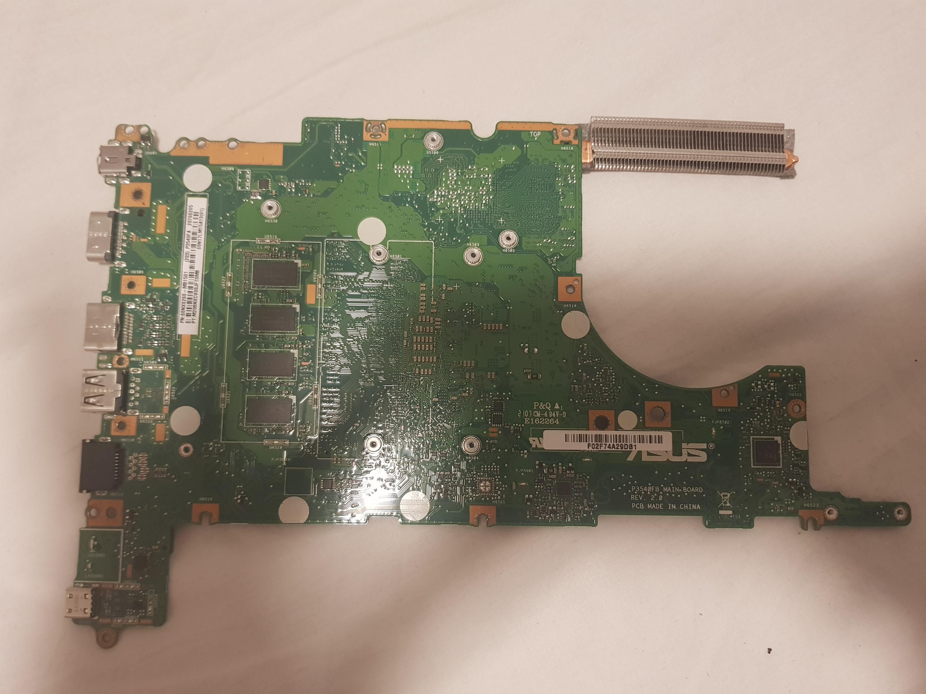

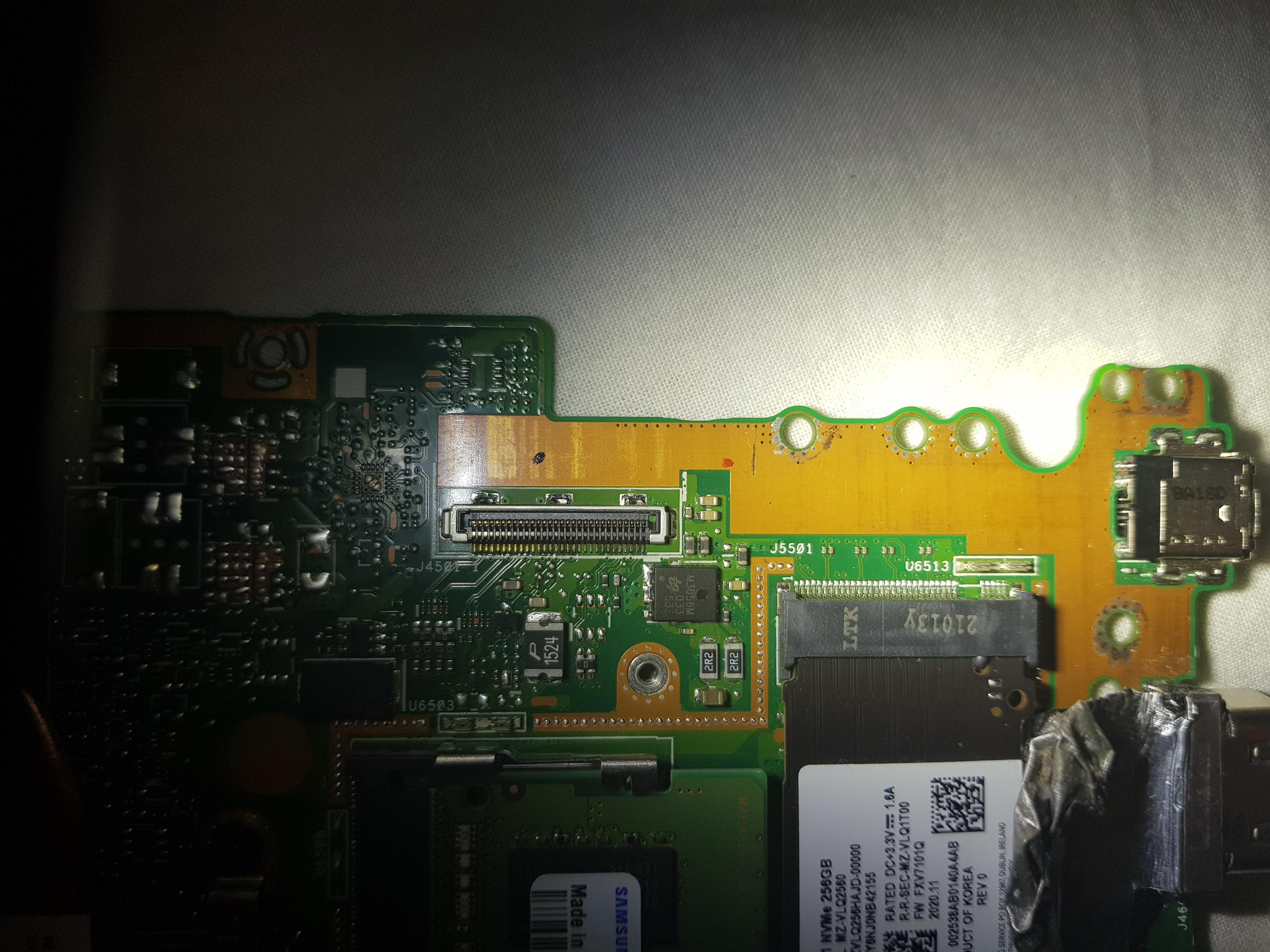

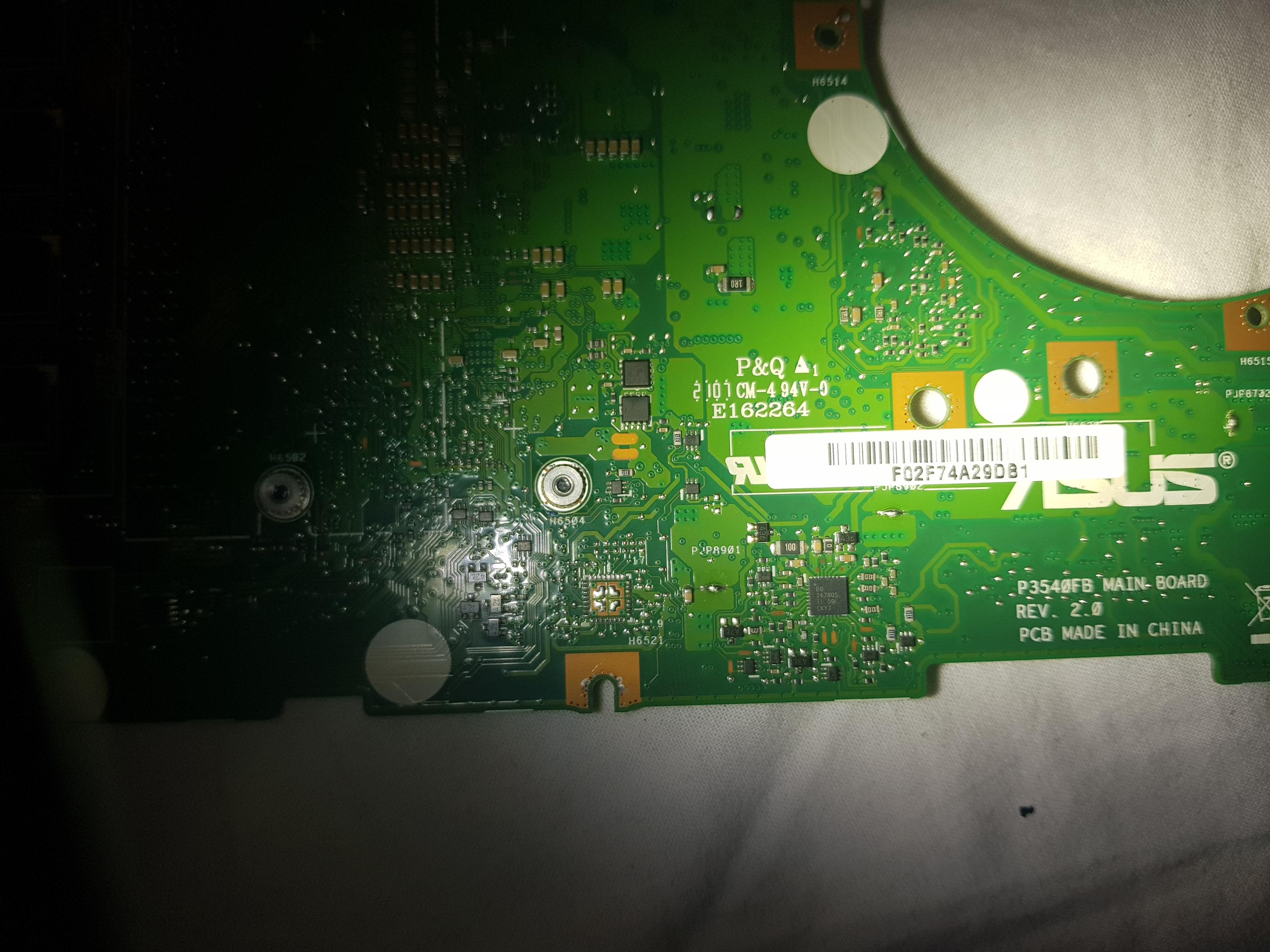

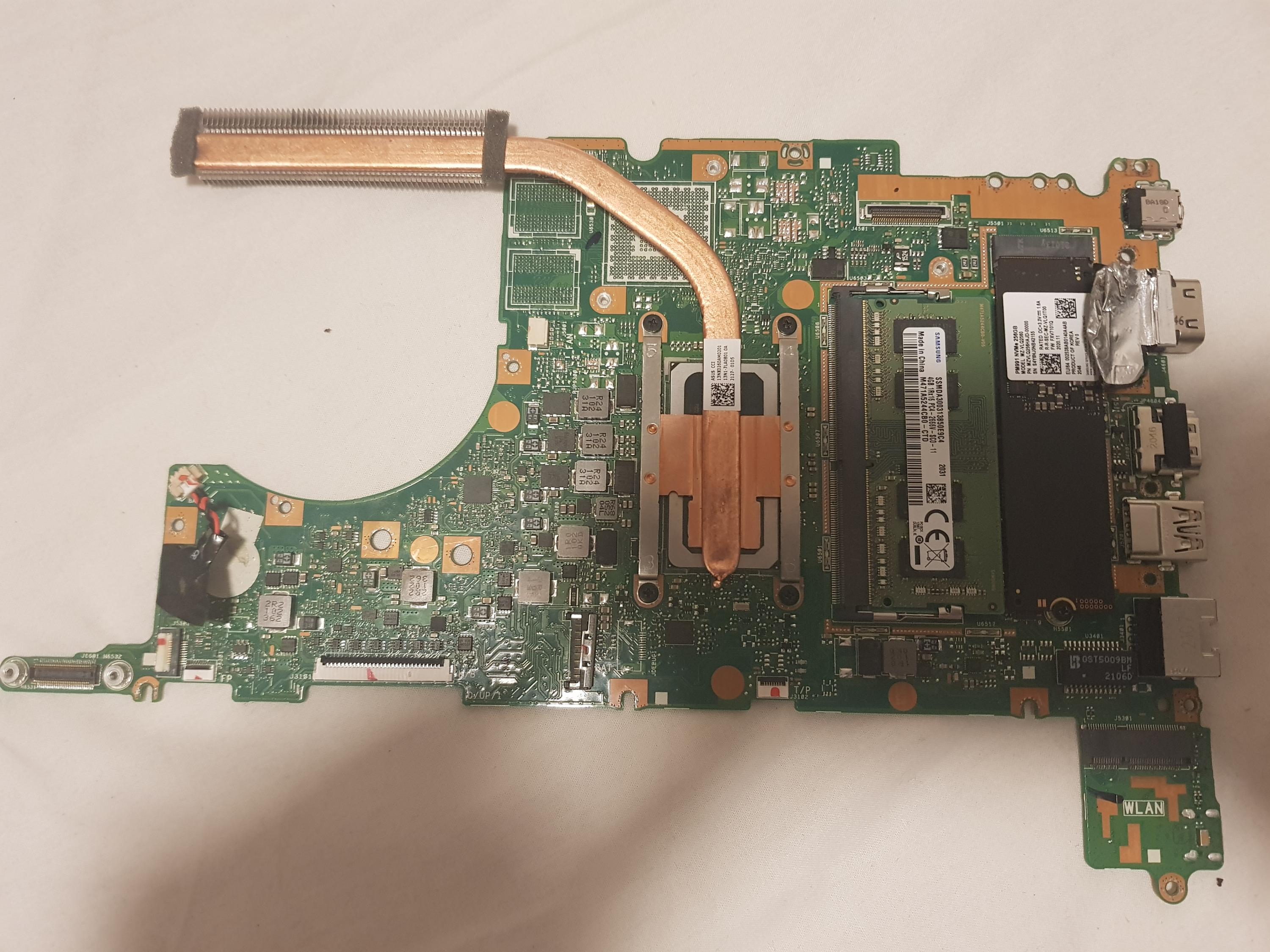

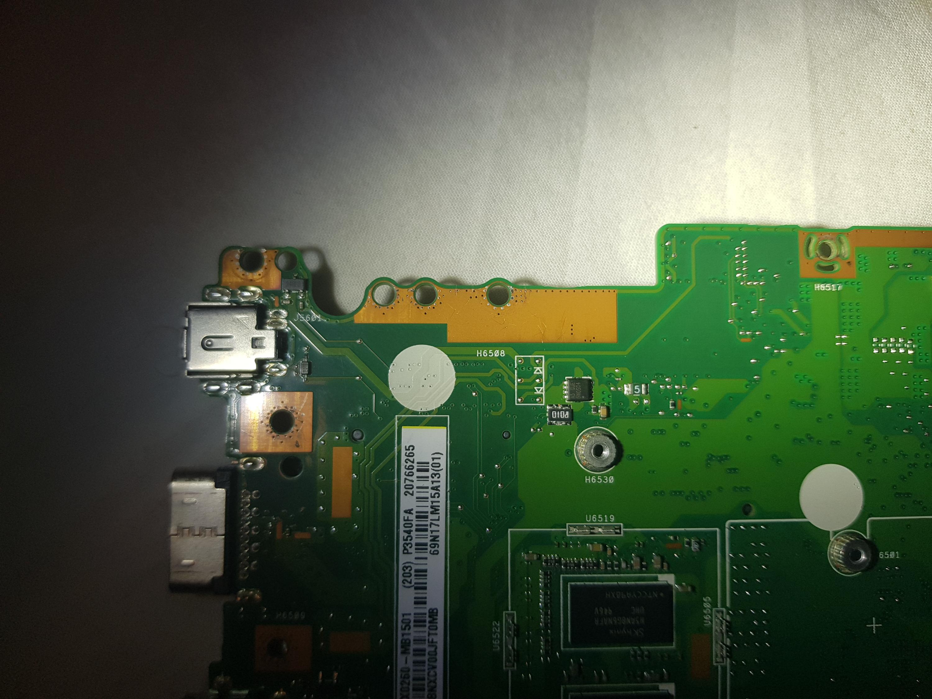

      Thanks for your help.
      It was actually less on the multi-meter as you suspected
      voltage is 24V.
      the question is on which mosfet's gate i should expect this voltage,
      I am attaching photos of the board
      • mon2
        • Dec 2019
        • 13994
        Can you post some pix of the charger IC area (bq24780S) ?
        The mosfet will be a 8 pin device (4 on each side; black in color) and will be near the DCIN connector for the adapter.
        This is the first mosfet on the logic board to receive the adapter voltage.
        One side will be DCIN adapter voltage; GATE = 24V (good voltage for ON); other side will be DCIN adapter (perhaps a bit less but about the same).
        The ANOTHER similar mosfet will follow.
        Check the voltage of the 1-2-3, GATE (4) and 5-6-7-8 pins of the SECOND mosfet.
        Often pin # 4 = GATE = same as the FIRST mosfet. Confirm the gate voltage and see if the mosfet is passing through the adapter voltage like mosfet # 1.
        • koby058
          • Jan 2017
          • 373
          • israel
          well, i know what a mosfet is but thanks any way
          the charging IC is in the bottom of the back of the board
          the first mosfet is on the top right of the board S=19.2v D=19v G=24v
          the second mosfet is on the top back of the board and have 19 on S,D, and 24v on G.
          i would like to mention that i have 19v on the buck converters on the front bottom left of the board

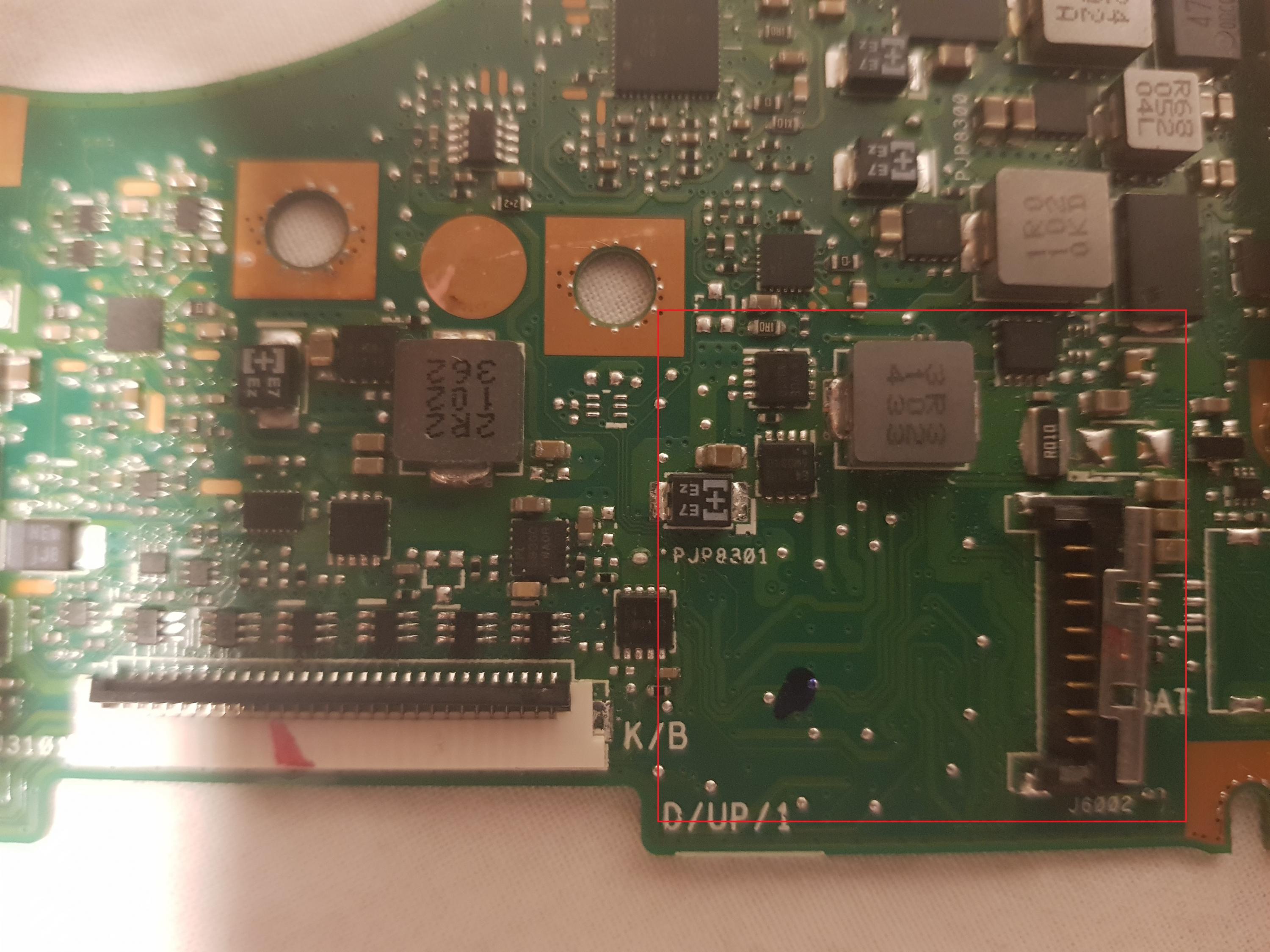

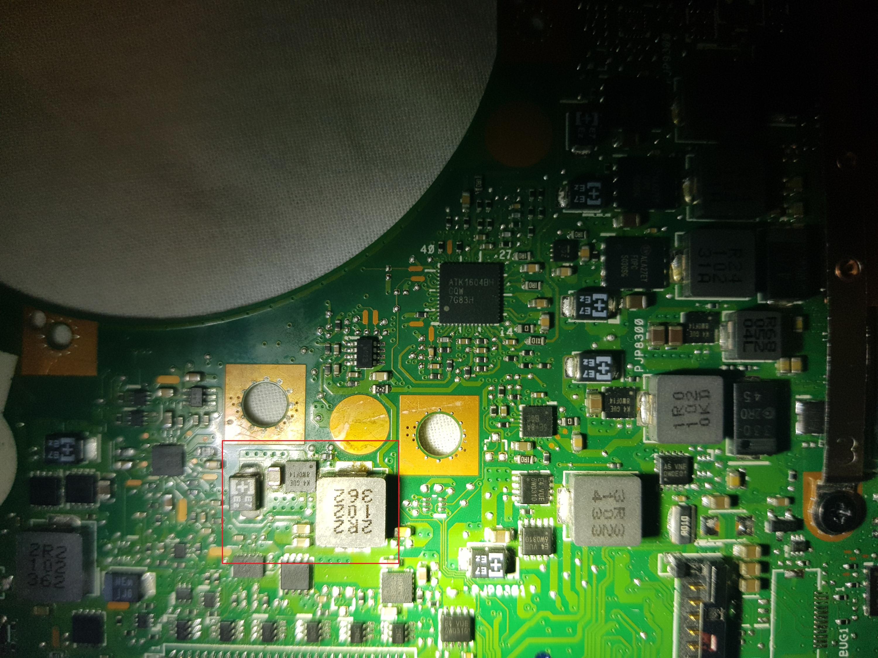

                                i have encountered a weird behavior, for a few minutes after disconnecting ac adapter, i have a short on this coil (after a few minutes short disappear ).
                                when injecting power the mosfet between the coil and the capacitor is getting hot.
                                i have tried to remove the brown capacitor short remains, the capacitor resistance was in mega ohms area
                                attached picture
                                any suggestion ?
