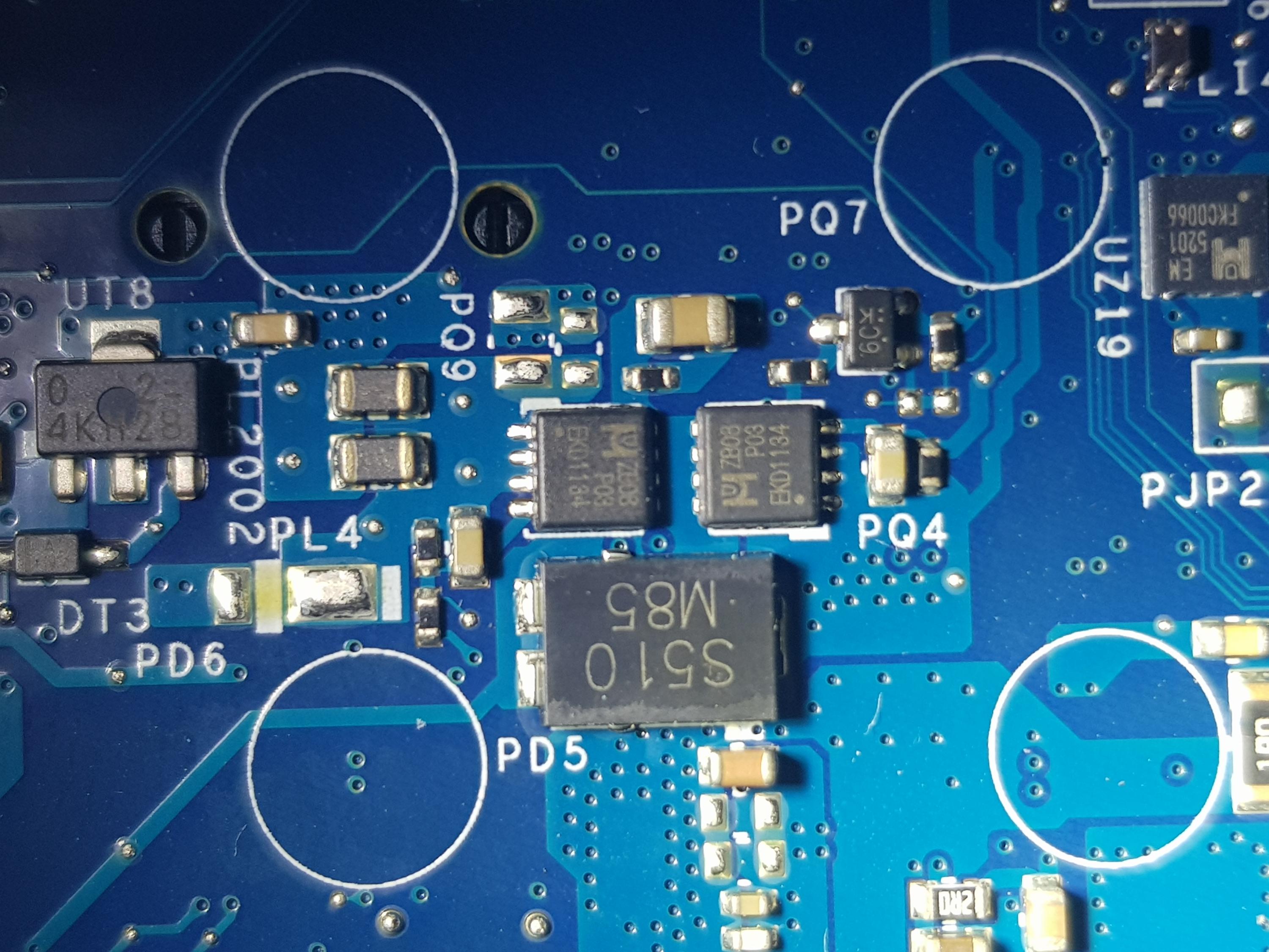

    I have this laptop that is not powering on.
    tested 19v @ dc in. 3v @ power button
    board model DDP70 LA-F701P
    How can i inspect the issue ?

    Re: Dell latitud 5491 no power on
    Hi.
    1) do you have any schematics for this logic board ? Cannot locate it in my database.
    2) either way - proceed to locate where the DC adapter is mating to the logic board. You should see 2 x mosfets near this aread + charger IC.
    Take some close up quality pix of each for a review.
    Also post the markings from the topside of each mosfet & charger IC.

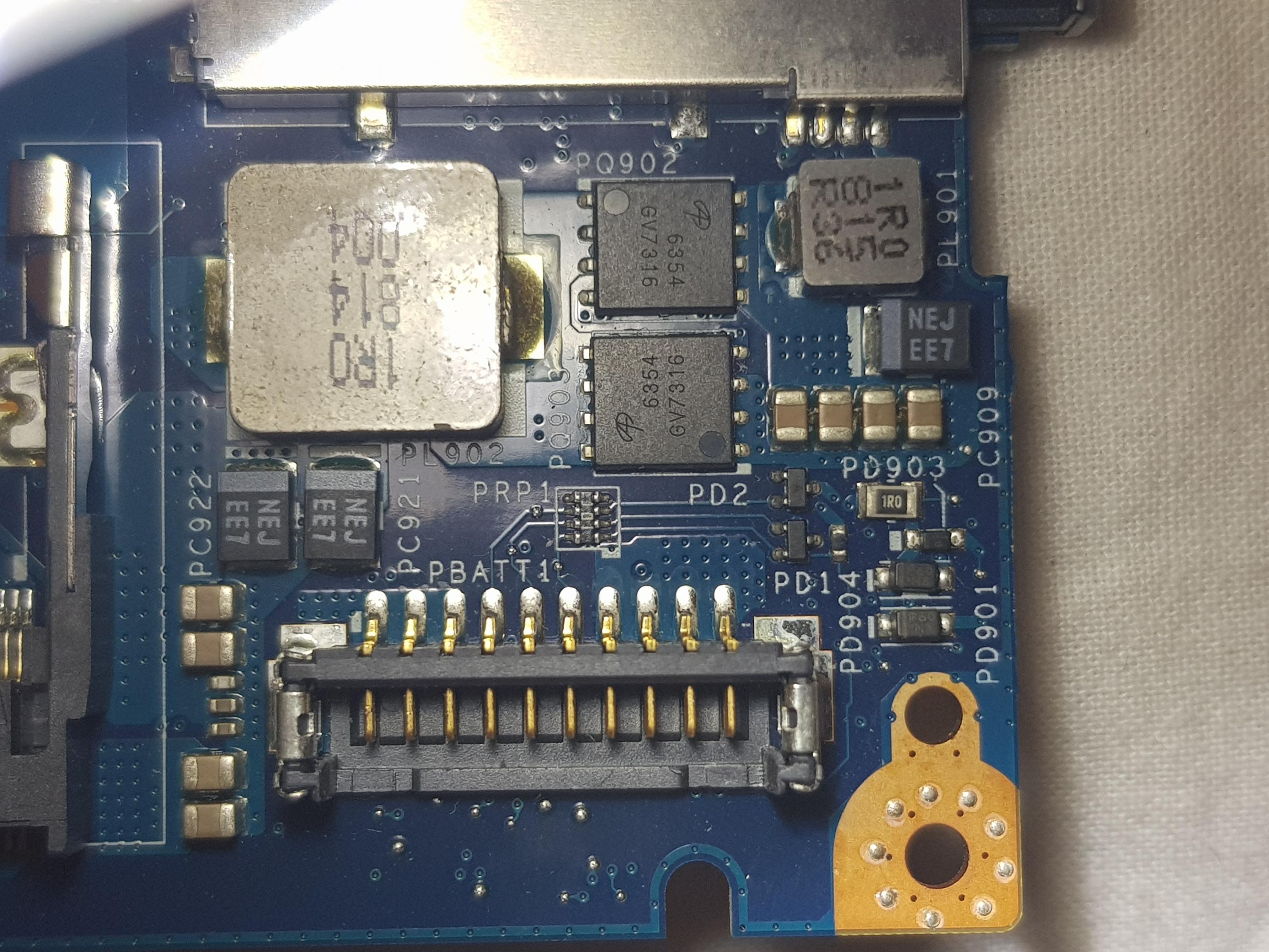

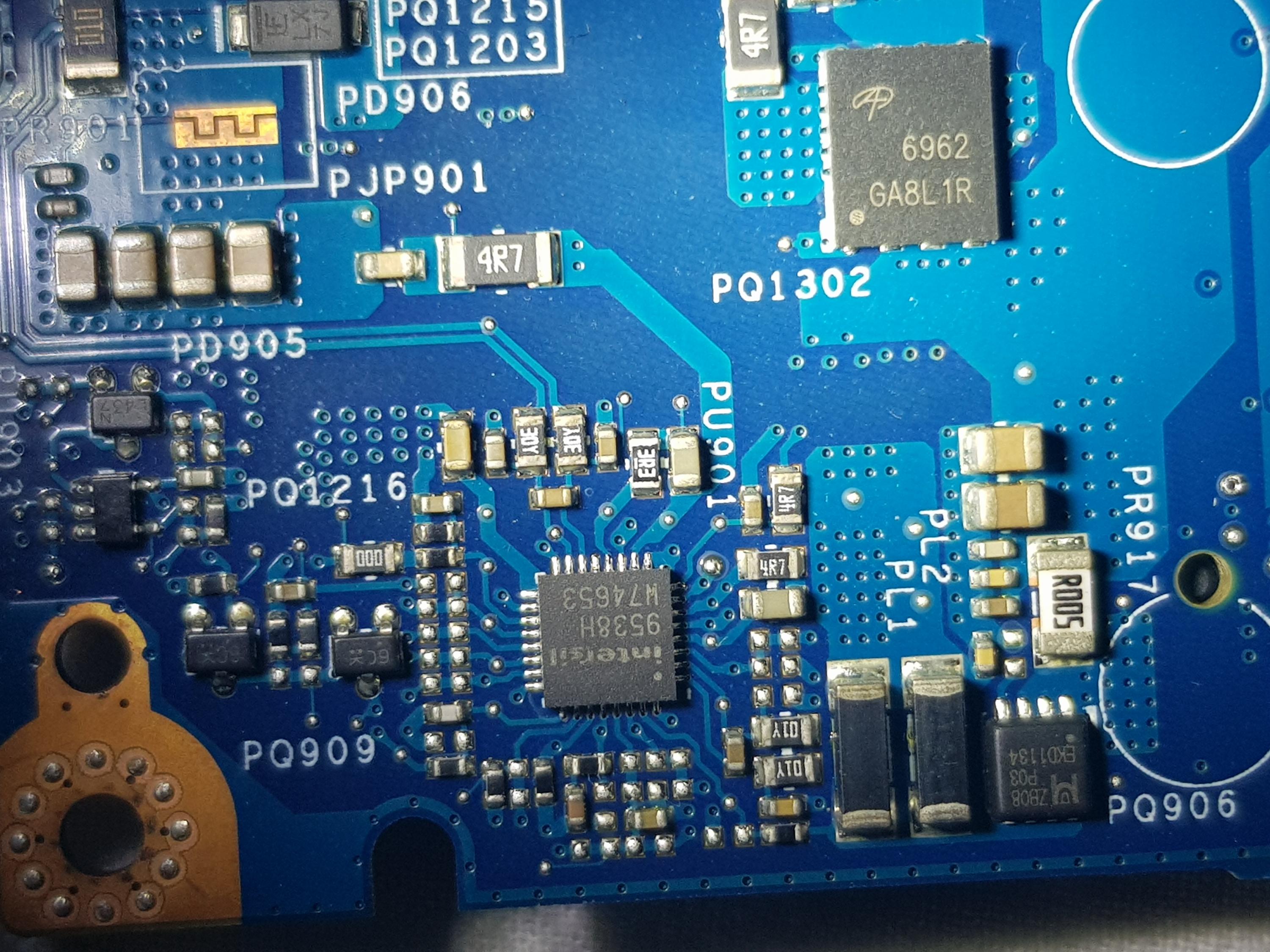

      Hi mon2 , long time no see
      unfortunately no schematic could not find it on google as well.
      here is two pics i hope its the correct area
      EDITED added the correct photo

        if i send incorrect photos or missing info, please correct me or let me know.
