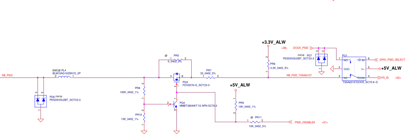

    Check the voltage of the adapter ID leg with the adapter connected.
    Next, remove all power. Meter in resistance mode. Check the resistance to ground of the same adapter ID leg.
    See attachment.
    Possible that the ESD / clamp diode is shorted and preventing communication of the adapter ID detect logic.

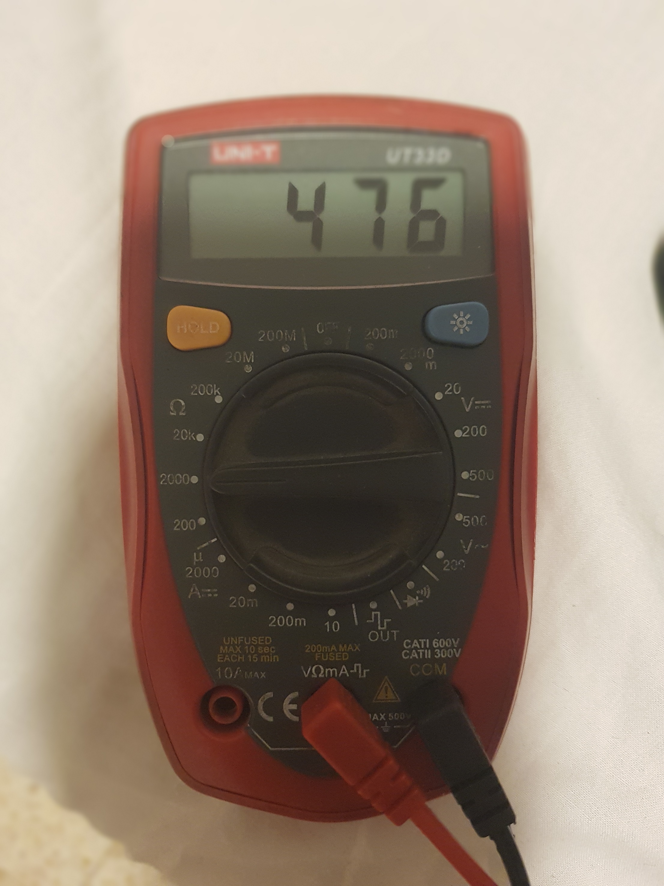

      Re: DELL latitude e7470 does not recognize dell charger
      Thank you for the help
      voltage was 0.66v
      attached

        However, we need to do some tests to determine where the fault lies on your logic board. The issue could be a defective ESD diode or perhaps the switch @ PU1.
        In the video, the tech found the fault @ EC IC by SMC (UE2).
        With the resistance checks to ground, it should be possible to locate the defective component.

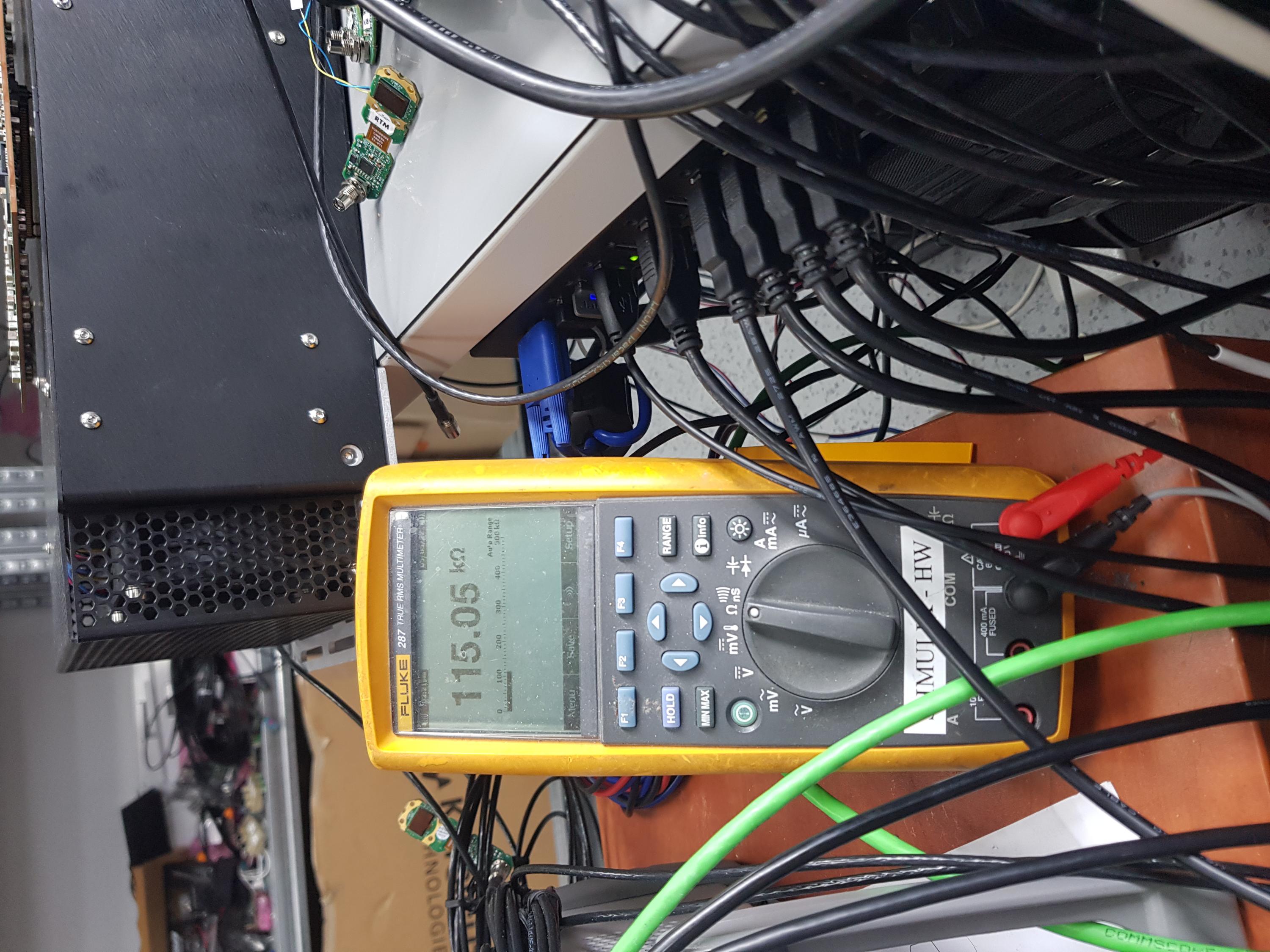

          Sorry, made a mistake
          attached resistance mode
          • mon2
            • Dec 2019
            • 14262
            That is a low resistance. Remove PD6 off the logic board and check the resistance to ground again.
            NOTE: DO NOT have power to the system when you measure the resistance.

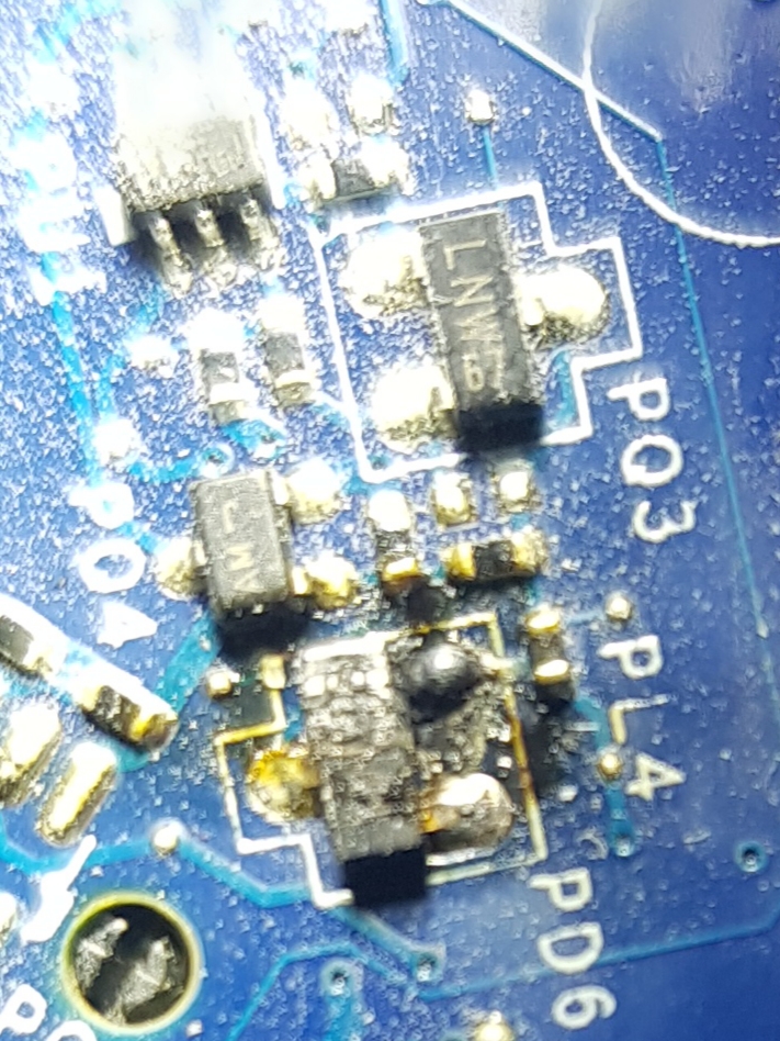

              I guess it is blown
              Today i will not be able to remove it, so i will ping after i have removed it
              should i order this diode ? or it can be bypassed ?
                Yes sir - indeed it is
                Use hot air and flux to remove it.
                Then check the resistance again. Very likely the root cause of the detection not working but there may be other faults. The part is very inexpensive but first remove it to check our understanding.

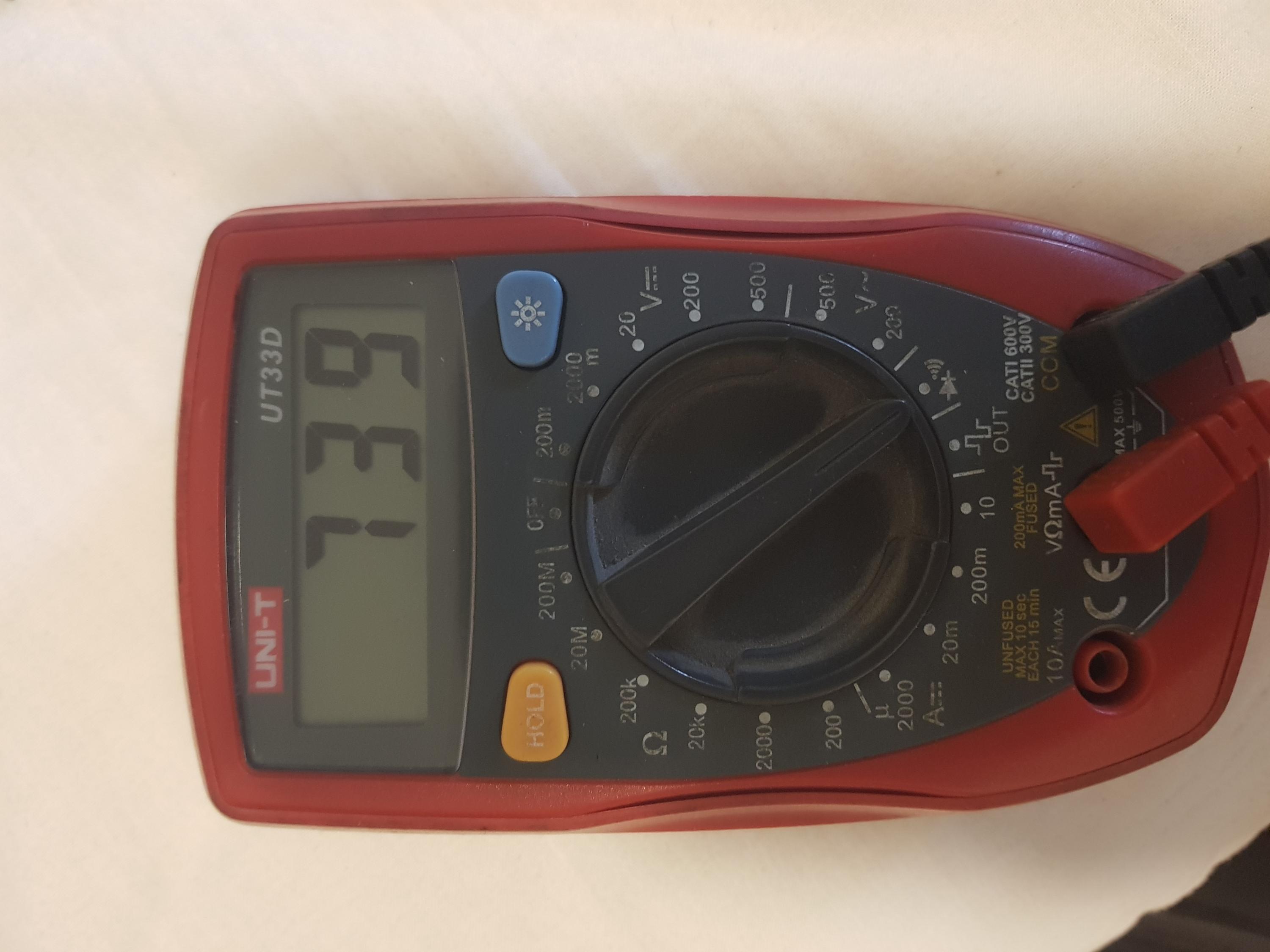

                  Hi
                  I have removed it and clean the area
                  attached new measurement
                  • mon2
                    • Dec 2019
                    • 14262
                    Good reading. Test again with your adapter.

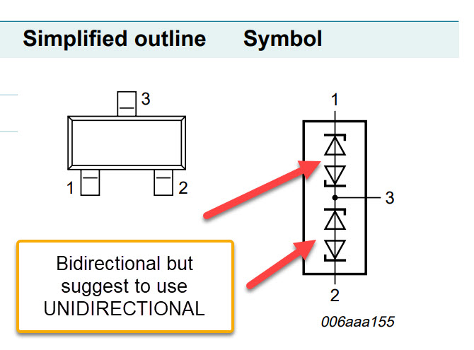

                        I think you should as these parts are sacrificial under harsh events. The component took a hit to (ideally) prevent damage to the components downstream on this circuit.
                        For now, you can use the laptop and it should identify the charger provided no other damage occurred due to the surge event.
                        On the diode referenced in the schematic - see attached datasheet.
                        Note that the internal graphics of the diode are NOT the same as shown in the schematic of the logic board. Specifically, there are double-headed diodes inside the PESD5V0U2BT (NXP is the mfr); yet the schematic shows a single diode on each pin.
                        That is, in my recommendation, this diode should have been a UNIDIRECTIONAL ESD diode on this rail. Such a part will only allow for POSITIVE voltages to pass through and block negative voltages. If the POSITIVE voltage threshold is breached, the part will attempt to clamp the surge. Every part has a max limit before it 'blows up'.
                        The part used on the logic board is BIDIRECTIONAL and allows for a POSITIVE or NEGATIVE voltage rail to pass through. The negative side is dangerous to such circuits.
                        Rephrased another way, why would this line need a negative voltage for communication of the adapter ID ??
                        For the above reason, suggest that a SOT-23 unidirectional 5v0 dual diode be used here. It will drop in place and perform its task of surge protection.
