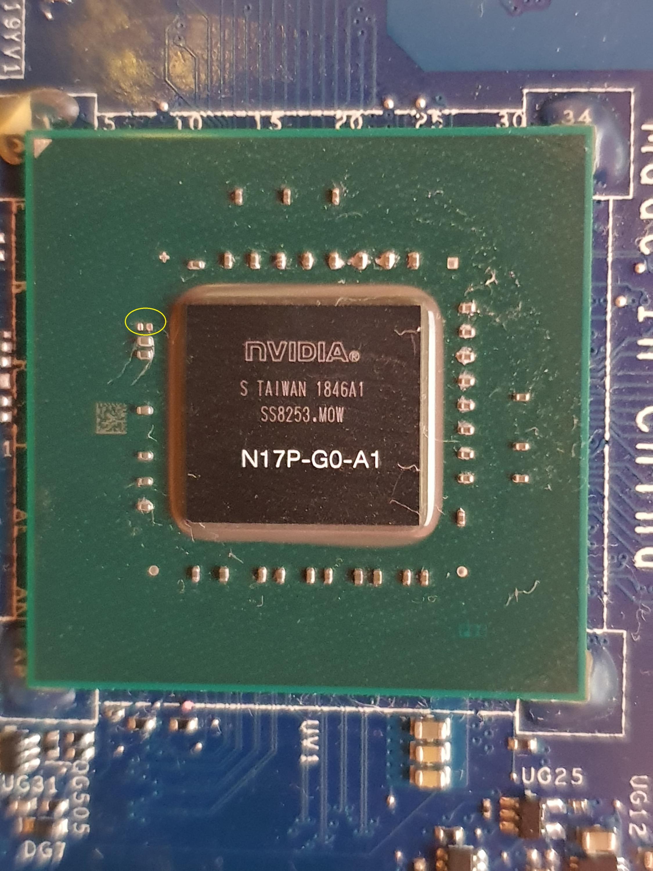

    Capacitor value from N17P-G0-A1 ( GTX 1050 ) - scraped from surface :(
    Hello, if anyone know what is value of that missing capacitor circled in yellow.
    It is nvidia gtx 1050 N17P-G0-A1 chip
    Thank you really much for help
  • madfreak
    • Aug 2012
    • 135
    • Poland
    Re: Capacitor value from N17P-G0-A1 ( GTX 1050 ) - scraped from surface
    If someone will search for that also it is 100nF 10V in 0201 size.
    • Sunie Nizami
      • Mar 2025
      Hey, I scraped a couple off by accident too. Removed and measured adjacent ones and they all do appear to be 100nF
      May I know how you figured it out? Were you actually able to find a board schematic or something?
