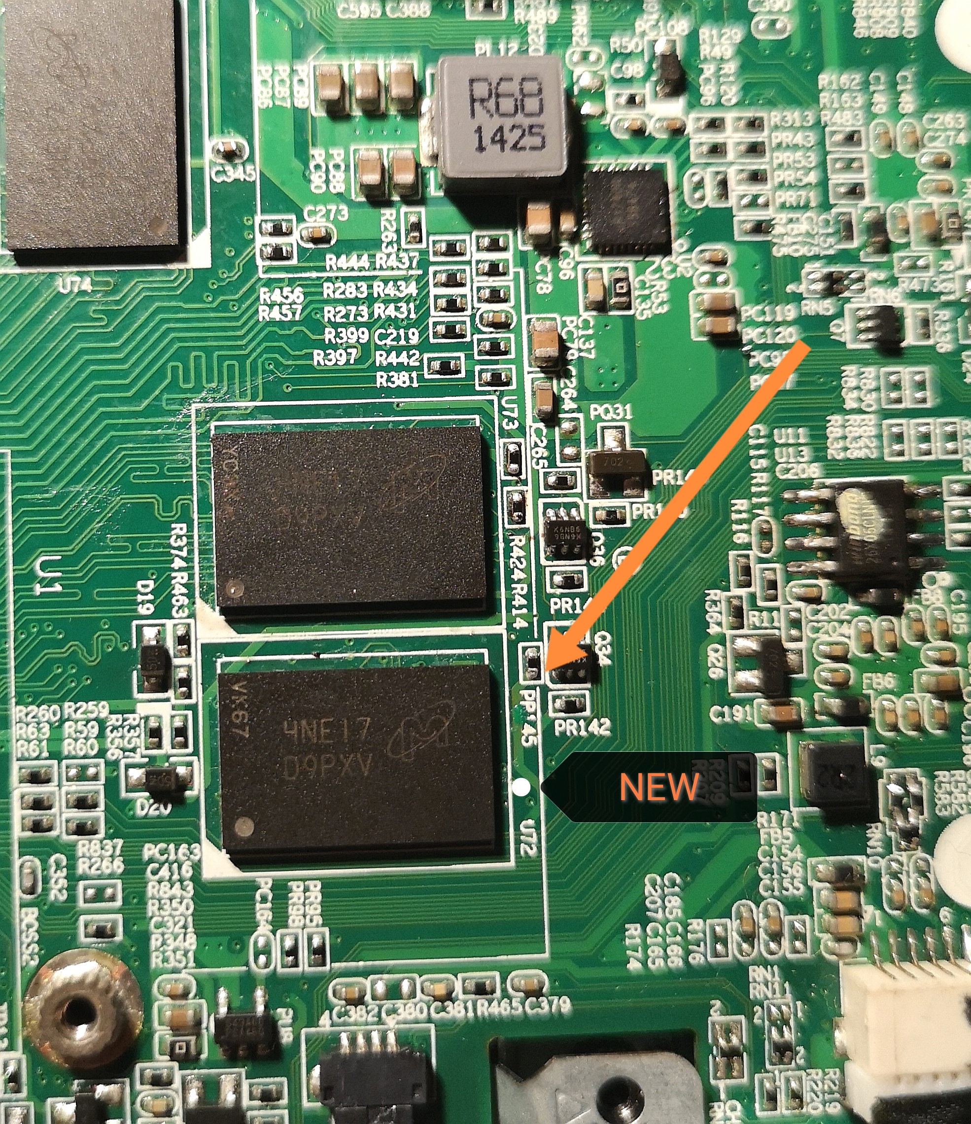

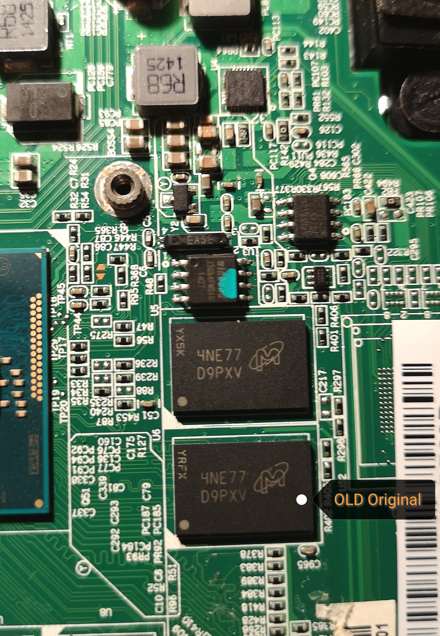

    I have a Lenovo S20-30 with 2GB RAM. I soldered a RAM on the motherboard (same reference as the original one) and unfortunately, the motherboard only detects 2GB.
    Should I modify the BIOS so that the system displays and detects the 4GB of RAM?

      Thank's for your reply,
      Here is a picture of the reference
      D9PXV MICRON BGA

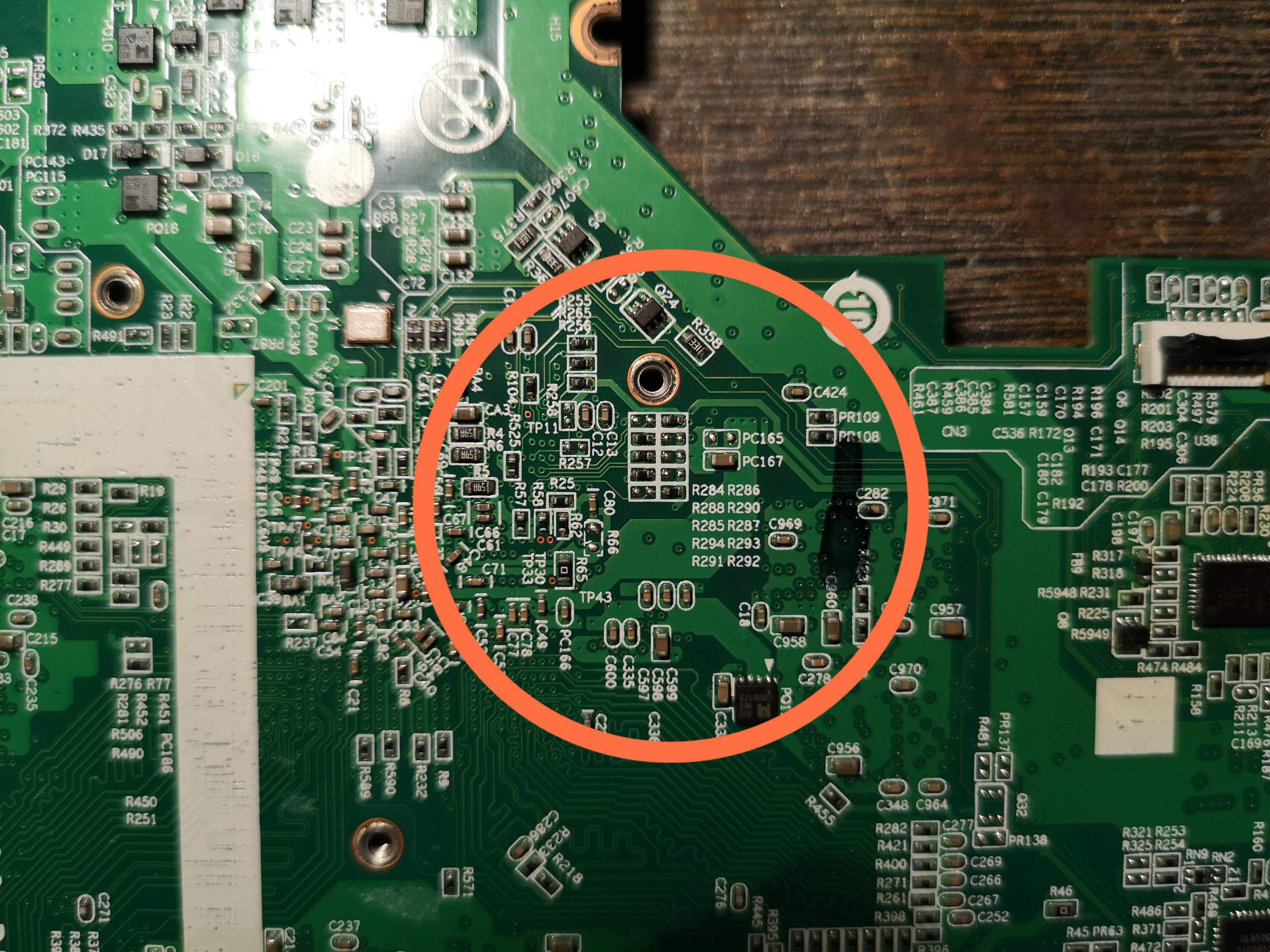

        On page 9 of the schematics, you need to configure the resistors for the new Micron memory, removing some and adding other resistors for the SDRAM configuration.

            Here is a screenshot of the area for GPIO
            When I move the R286 to R284 it does not work. The PC starts but no image.
            Could you help me if there is another combination?
              Re: Modify RAM 2Go to 4Go for Lenovo S20-30
              I think you should take R294 out and put it at R293.
                ...still the same

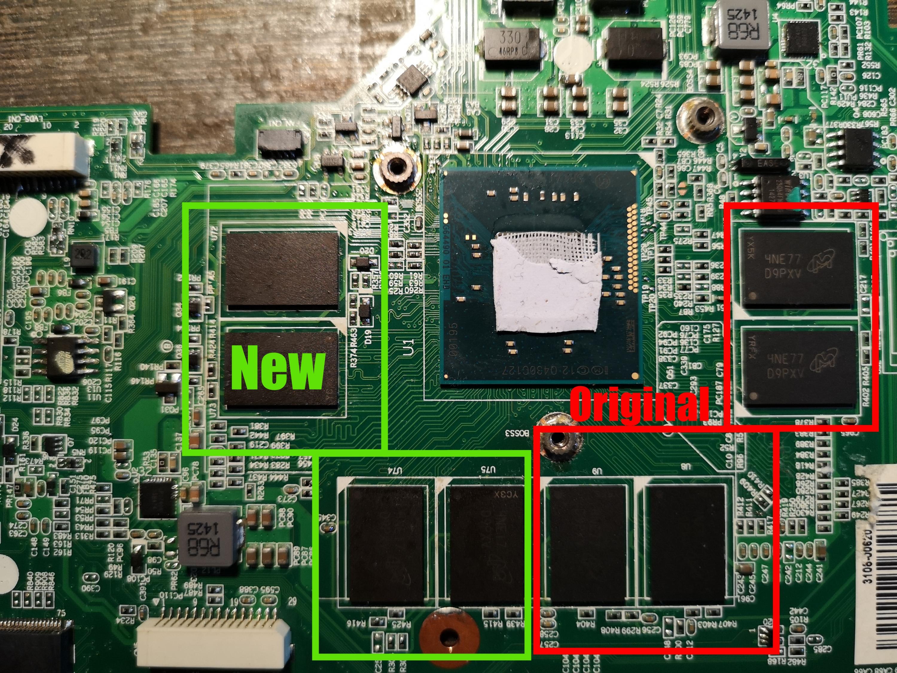

                        You have 8 circuits for memory, U5 U6 U8 U9 U72 U73 U74 U75. Originally which circuits were present and which were added.
                          U5 U6 U8 and U9 was the original
                          U72 U73 U74 and U75 was added

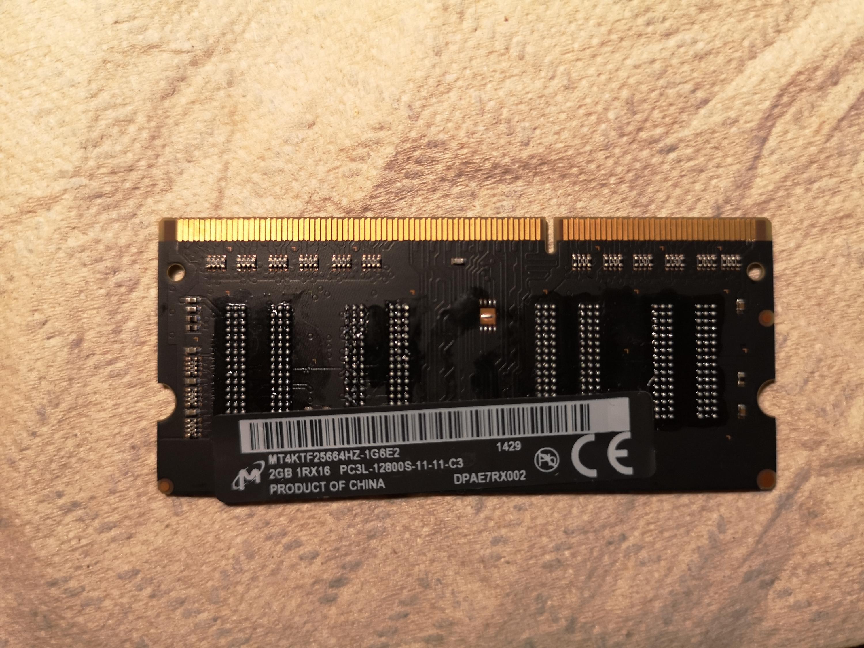

                              I used this RAM to pick up the chips
                                at this point one of the new chips may be damaged. personally even if the work is so much I would try to replace the working chips (old 2g), one at a time, with the new ones and see if it displays (with 2g cdefault conf)
                                  That's exactly what I thought and we'll see what happens
