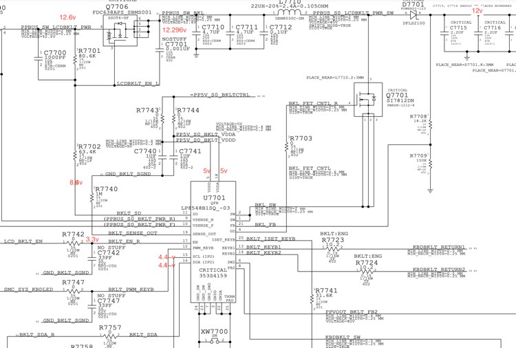

    I have MBP 2013 15" 820-3787 with no backlight with an image but sometimes intermittently working then off if restarted.
    It sees the screen with 5v on PP5VR3V3_SW_LCD
    PPBUS_SW_LCDBKLT_PWR = 12.6V
    PPBUS_SW_BKL = 12.296V
    PPVOUT_S0_LCDBKLT - 12v
    On U7701 5v on VDDD & VDDA
    BLK_SD is 8.9V
    BKLT_EN is 3.3v
    SCL and SDA is 4.4v~~V
    Voltage reading in such.

    Good measurements.
    U7701 looks to be defective. Replace it and post your update.
    You can source these from AliExpress.

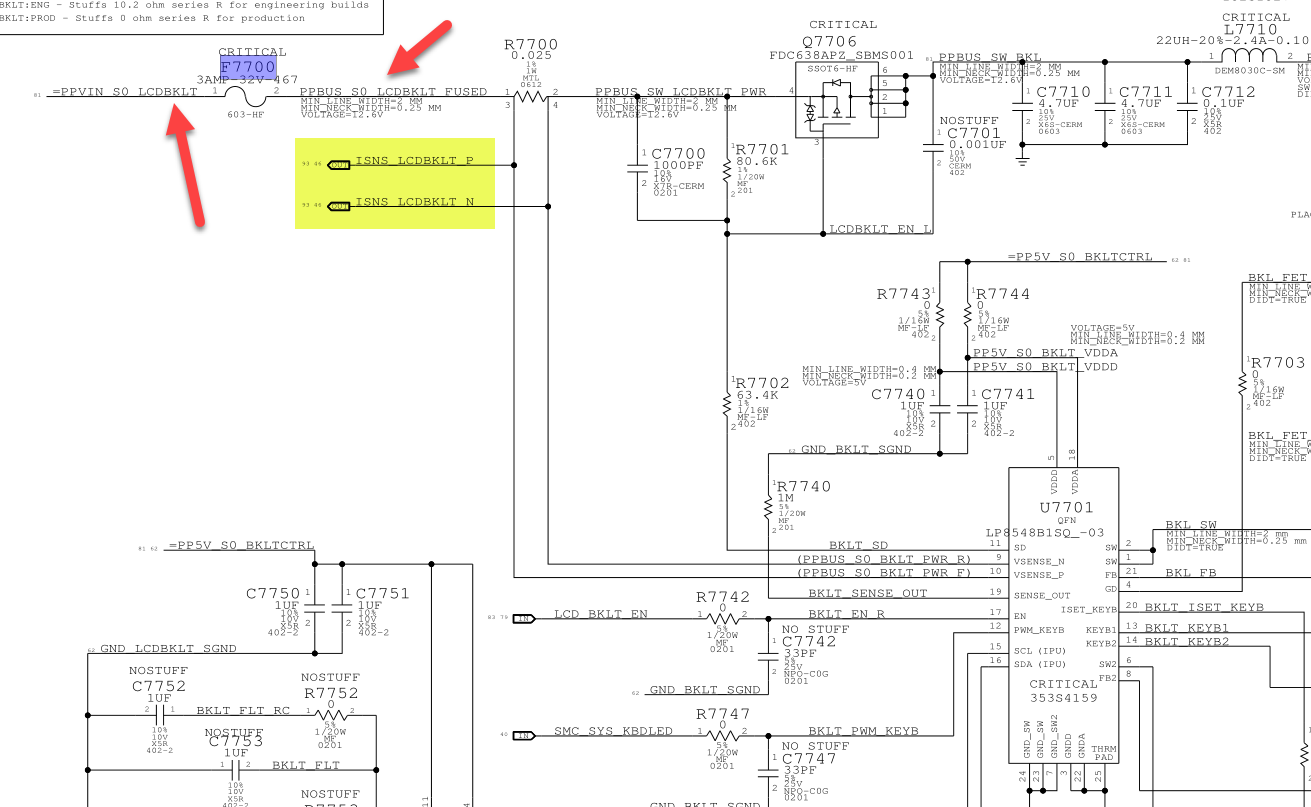

        Measure the voltage on both sides of fuse F7700.
        If the voltage is present on BOTH pins of this fuse, measure and post the voltage readings of the following:
        ISNS_LCDBKLT_P
        ISNS_LCDBKLT_N

          ISNS_LCDBKLT_P = 12.56v
          ISNS_LCDBKLT_N = 12.56v
          I noticed BKLT_SD is not pulling to ground. when i touch multimeter leads red on ground then BKLT_SD on black backlight turned on. then off if turned off?? replace u7701 again?? but i got backlight when touch?? also no keyboard backlight voltage help pls

              I replaced it again with a new IC I double-check the connection and no shorts are found.
              R7700 and U7701 are connected = 12.56v
              LCD_BKLT_EN = 3.3v
              BKLT_EN_R = 3.3v
              BKLT_SDA = 4.9v
              BKLT_SDA = 4.9v
              Feedback resistor are good i can adjust brightness when jumped on BLKT_SD.
              PPVOUT_S0_LCDBKLT =45.7v is supposedly 55v??
              LCDBKLT_EN_L = 11.9v
              BKLT_SD = 7.7v wrt gnd
              R7702 & R7701 are good also
              PPVOUT_S0_KBDBKLT = 15.5v is supposed to be 40v???
              also tested SMC_LID is good when i placed the magnet it turned off then I had to jump the BKLT_SD to turn it on again
              head scratch what did i do wrong. also -04 version compatible on -03 version. because i have a original -04 from a1502 2014 tho just wondering

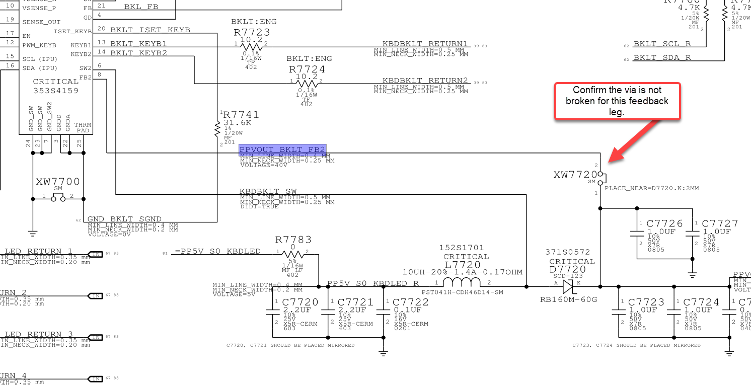

                          See attached - confirm the feedback leg for the keyboard is not damaged. This trace appears to be a via from one side of the PCB to the other so confirm the trace / via is not damaged. You can remove all power, meter in resistance mode -> check the resistance from one side of the PCB to the other side (check at the via).

                            BKLT_SDA = 4.98v
                            BKLT_SCL = 4.96v
                            BKLT_SDA_R =4.92v
                            BKLT_SCL_R = 4.92v
                            I2C_BKL_1_SDA = 3.3v
                            I2C_BKL_1_SCL = 3.3v
                            it has continuity from PPVOUT_S0_KBDBKLT to u7701 pin 8
                            also i got LCD backlight =46v but not KB Backlight = 5v

                              Swap out L7720 from a donor board. If available, also D7720.
