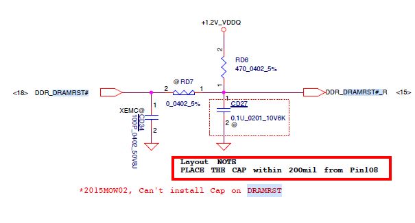

            Re: Acer Nitro AN15-51 (Board LA-E911P) Powers on No display
            Update:
            I have Checked DRANRST line and to the best of my knowledge/ability I think its ok.
            I checked the pull up resistor at RD6 and found the value to be 464Ω (see attached picture) this is within spec, so I'm still stuck.
            I guess I need to step back in the startup procedure and see if other lines/signals are present.
            Thanks for the info mcplslg123 much appreciated
            • mcplslg123
              • Jun 2015
              • 7262
              • india
              Was 1.2V present on both sides of RD6??
              • BlkMolly
                • Jul 2021
                • 22
                • US
                On power up of board (power button pressed) 1.2v is present at pin 2 RD6, The other side of RD6 pin 1 shows 125mv suggesting the line is being pulled down.
                The only oddity's that I have found is H_CPUPWRGD is only 1.1v (is this still regarded as high) and isn't H_CPUPWRGD suppose to be high after DRANRST is high, in the start up sequence? (this is with my limited experience on board level repair so I maybe way off)

                • mcplslg123
                  • Jun 2015
                  • 7262
                  • india
                  H_CPUPWRGD at 1.1V is good. So DRAMRST# is pulled low and thats a problem. Ram reset is done by processor. It could be bios issue so i'll strongly suggest to flash bios first and the new bios should be known good+me cleaned. You can make a request in bios section while posting your original bios backup there. Experts there are very co-operative and will respond to your request.
