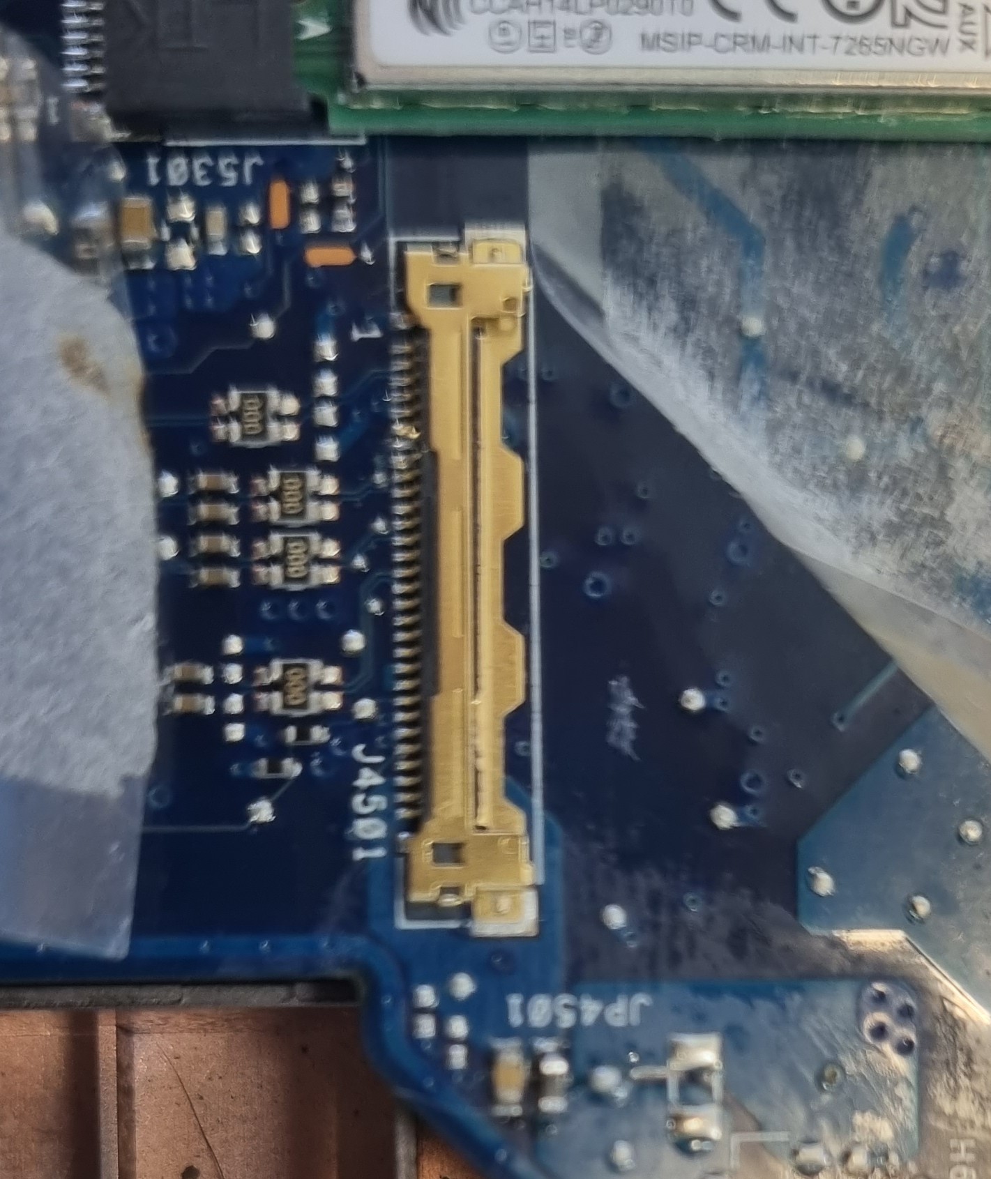

Asus GL552V / GL552VW REV 2.0 / Help with display FPC connector
  • GfilipeZ
    • May 2021
    • 43
    • Portugal
    The connector of this laptop was damaged by our customer during an intervention. Shorting the Display Backlight and the webcam's audio circuit.
    I am not able to identify the correct connector model. Nor am I able to find suppliers in Europe or China.
    Can anyone help.
    Thank you in advance for your attention.
    Best regards.

    Re: Asus GL552V / GL552VW REV 2.0 / Help with display FPC connector
    Count the number of pins on the connector.
    Post the value.
    This is a LVDS connector and the original design was by Hirose. There are tons of clones in Asia on AliExpress.
    https://youtu.be/7fzLKHzc1Ik
    I think you will have 30 contacts but confirm it.
    https://www.laptopscreen.com/English...S/ROG~GL552JX/
    US $7.30 | 10pcs Brand New LCD LED LVDS Cable Connector 30 pin For Macbook Pro Retina A1398 A1425 A1502 2012 2013 2014 2015 Years
    https://a.aliexpress.com/_mqI6mtq
    US $0.81 10%OFF | Brand New A1502 LCD Connector for MacBook Air 13" A1370 A1465 A1466 Lvds LCD Connector A1425 A1369 LED 30 Pins 2010-2011 Golden
    https://a.aliexpress.com/_mr5XYAo
      Post the value.
      Yes, it's 30 pins.
