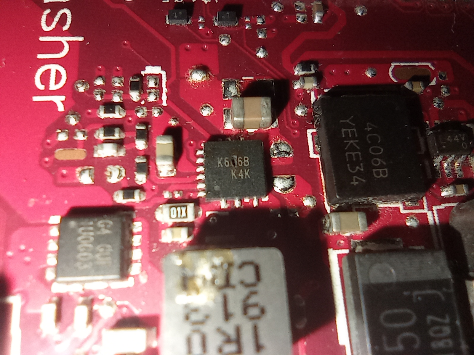

    I have a blown chip in my ROG GA502DU and need help identifying it. It am not sure what character is in the middle one.
    I used the post about IC Marking Codes and Datasheets (https://www.badcaps.net/forum/showthread.php?t=90619)
    And the most closest I can find with marking similarities are in the Richtek post
    (https://www.badcaps.net/forum/showpo...84&postcount=2)
    I found 3 that had a product code with "K6" which are:
    RT9167A-21CBR
    RT9170-21CX
    RT9819C-27PVL
    but I checked the pins and they are not the same as the one on my motherboard. I attached the datasheet I've found online for these chips
    Do you guys think that one of these is the same with the blown chip?
    if not please suggest where can one.
    Will greatly appreciate the help!

    It might be a RT6228AGQUF https://cdn.badcaps-static.com/pdfs/...6284293d22.pdf ,marking K6= .Its definitely none of the ones you posted,look at all the pin configurations in the datasheets carefully .

      Thank you! I checked the datasheet and it kinda checks out.

        May I know how you found the component? I looked in to the thread posted but didn't find it. I want to search without posting a thread in the future so I wont be a bother.
