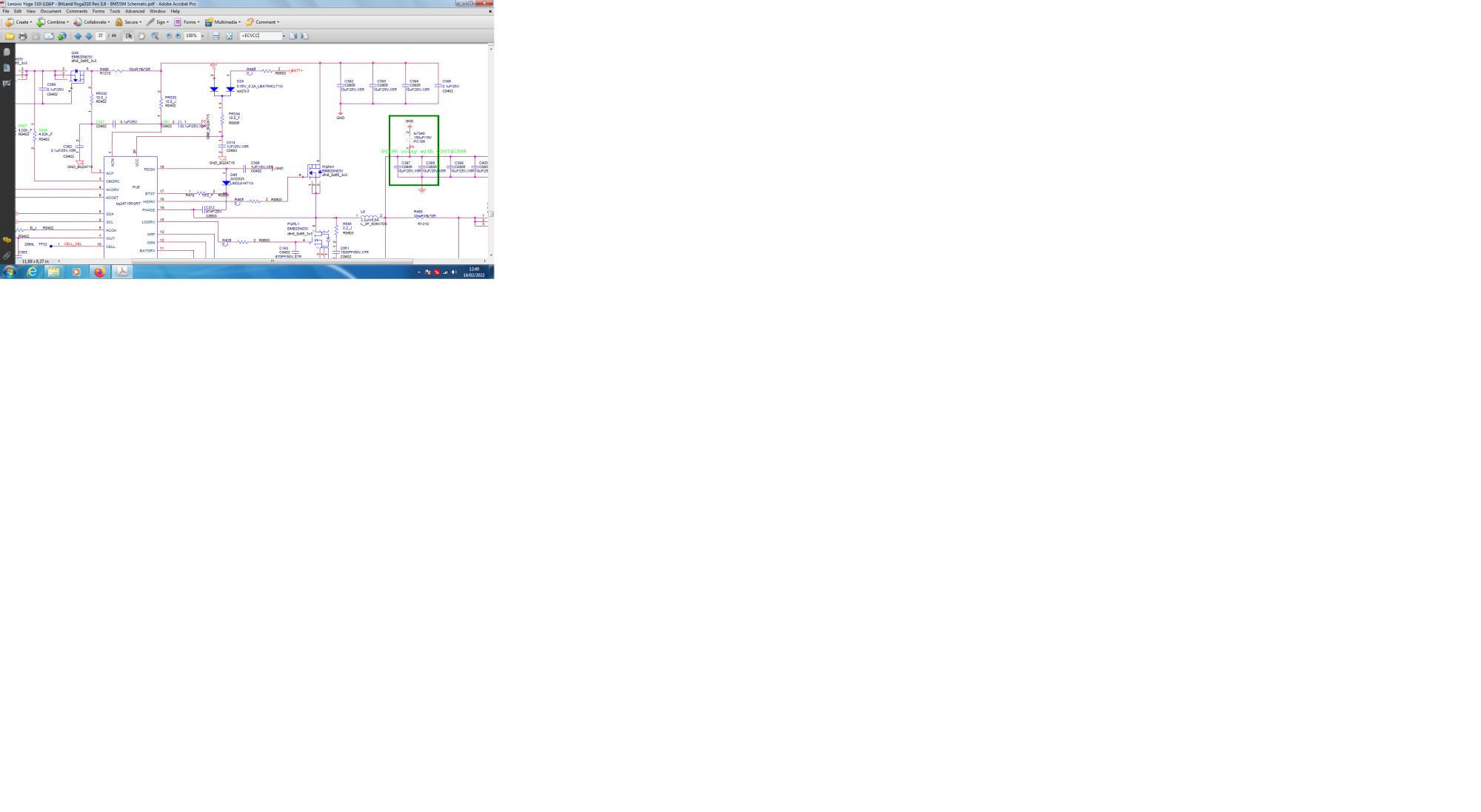

    I have a lenovo yoga 310 laptop, the problem is that the laptop can work normally when using a battery or using an adapter only, but if you use a battery then plug in the laptop adapter, it immediately restarts
    please help me

    Check dc-in mosfets+discharge mosfet( for battery) for short by measuring S-G/S-D/D-G

      I have checked all the MOSFETs, nothing short, even I have tried to replace all the MOSFETs and the bq24715RGRT ic
