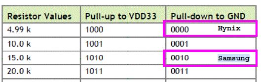

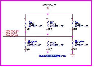

    Hello.
    I am asking for help in changing the configuration of the motherboard. Originally there were Samsung K4W4G1646D-BC1A VRAMs. Have been damaged. They were replaced with HYNIX H5TC4G63AFR-11C together with the GPU core. Laptop sees dedicated graphics, but not memory. I can't figure out how to change the settings on the motherboard. Please, someone indicate exactly where and what the resistor should be.
    Motherboard - 15221-1.
    Maybe someone has a VRAM Hynix and would share photos.
