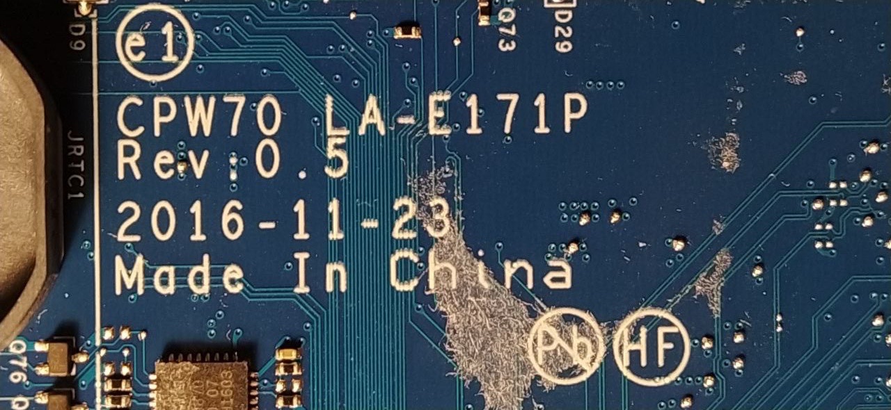

Hp Zbook 17 G4 (+5VS short) CPW70 LA-E171P

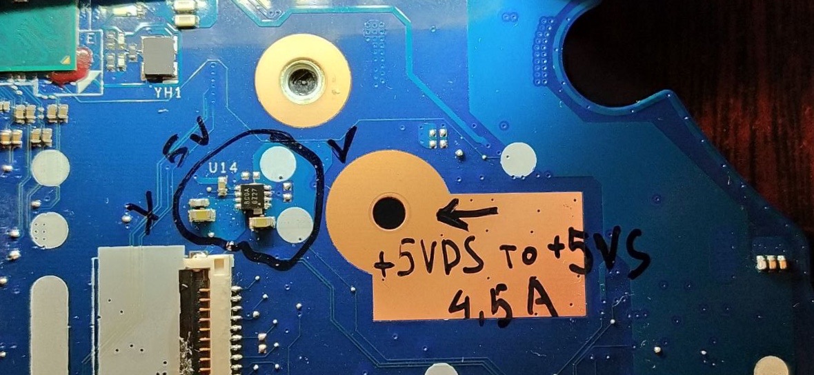

    Hey there! After some troubleshooting I have found that U14, which is marks as BC0A, but actually TPS22965DSGR_SON8_2X2, is getting hot and blinking from hot to cold. Some protection scenario
    The problem is simple. After passing switch, there is a short somewhere. It could be a charging controller, it could be a lot of different ICs which requires +5vs or one faulty component.
    Recently I watched a lot of repair by northbridgefix at YouTube, and most of repairs were made without voltage injection. I am afraid to inject voltage as my 0.8 v power supply is broken and I do have a 1.3v only for injection. I remember that the best option is 0.9-1.0v for injections.
    Maybe there is the other way to fix without burning components?
    U14 looks clean and Normal, so I think that problem is not there, also ic shutting down after few second and looping that again... on of..
    Thanks for advices!

    +5VDS to +5VS Transfer (TPS22965) is activated by PCH signal "SLP_S3"
    Running on +5VS:
    o-HDA_SYNC Isolation Circuit
    o-A lot of capacitors
    o-Caps near ODD and HDD connectors
    o-A lot of LDOs
    o-sound codec controller
    o-usb power?
    o-DP to VGA convertor?
    o-SD controller
    o-Battery charger BQ24
    TPS22965 Datasheet
    https://cdn.badcaps-static.com/pdfs/...a5cffae8d7.pdf

      Re: Hp Zbook 17 G4 (+5VS short) CPW70 LA-E171P
      Meter in resistance mode (2k scale is ok). Remove all power / no battery.
      Measure & post the resistance to ground on the Vout rail.
      What is the reading ?

        Finally found few capacitors which were dead. Also somehow the soundcard ic was shorted (part of it). Also the capacitor close to charger ic was dead. So after desoldering 6-7 capacitors and soundcodec, the short was gone and laptop even posted. But that's shutting down after 20-30 seconds. The pch is extremely hot, about 70-85c or more. I think that something at gpio of pch is faulty. I think that one of LDOs is also dead. I am not sure but will measure voltage on nearby ldos
        Good news. That repair was done without voltage injection. Yeah that's a waste of time and a lot components was desoldered and putted back. But I think that this is the safest way

          Sound codec is fine. VREG capacitor was dead. Actually there was not a short, but VREG dead capacitor. multimeter cant measure capacitence, but at ohm mode it can be charged to infinity. If charge it by 1.25 V it shows 10-45 ohms short
          Also a partial short detected at 257, 259 pins of Ram, that comes from PL44 coil (2D5V_S3 - VPP)
          All SC22U6D3V5MX caps are dead... I even dont imagine what was done with this laptop
