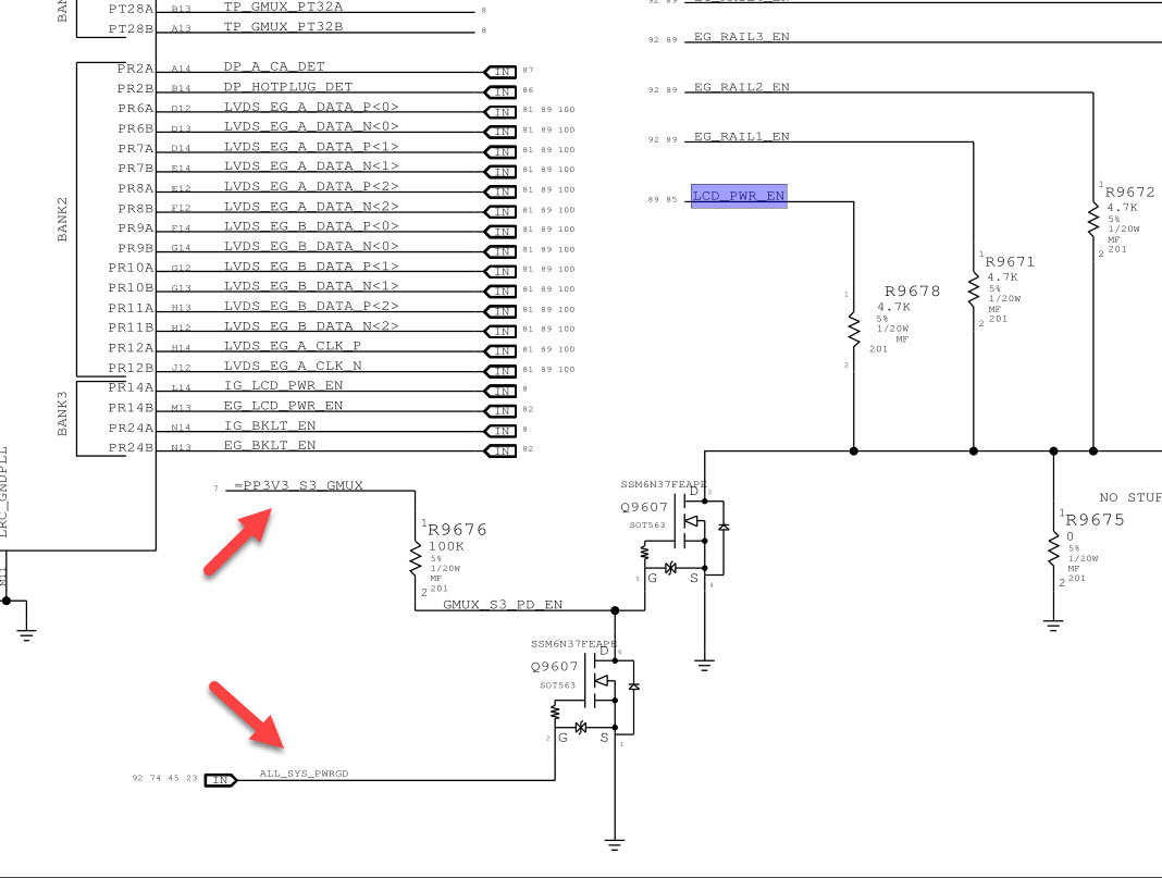

    Hello everyone.
    My own macbook pro from 2012 just decided it had enough. There is no image on the screen (screen dead, no backlight, no image whatsoever even with a torch behind the apple logo), there is no image on external via thunderbolt/DP adapter.
    There is chime though, there is also all the controls from the keyboard, so it is possible to control the backlighting of the keys.
    I had problems for the past year or two with the display, showing a green line (single pixel) or two, maybe three. But nothing that I took seriously as I had always used an external display.
    The computer is mine since new, I got it with the optional "hires" matte screen.
    Never seen water, always took good care of. A few scratches on the case, no dents, no serious damage.
    So as I was probing the motherboard for voltages it happened that the display got turned up, showing the logo and I got the folder icon (because I removed the SSD), tried to turn off and on a few times, the display lit up like new most of times, the fourth time then it went dead again.
    So the board is not to throw away yet.
    I checked the LVDS connector and i got on the following pins:
    1 - GND
    2+3 - PP3v3_SW_LCD - 0volt (expected 3.3volt)
    4 - PP3v3_S0 - 3.3volt
    5 - NC
    6 - LVDS_DDC_CLK - 3.3volt
    7 - LVDS_DDC_DATA - 3.3volt
    8+9 - LVDS_CON_A_DATA - 0.3volt
    21 - LVDS_CON_B_DATA - 0.3volt
    31 to 36 - LED_RET - 0volt (expected 0.5volt)
    38 to 40 - PPVOut_S0_LCDBKLT - 0v
    I also checked on the U9000 and got this on the following pins:
    1 - 0volt (expected 3.3volt)
    2+3 - 3.3volt
    4+5 - 0volt (expected 3.3volt)
    6+7 - GND
    What should I check next? Can you give me any hint? I really don't want to give up on this machine, it served me well and I am sure it could serve me for at least for another two or three years.
    Thanks in advance...
    Martin

    Hi.
    The enable for your LCD panel is off (pin # 1 of U9000). See attached.
    Post the voltage readings for the MUX selector circuit.
    Next,
    Guessing some power rail may be failing. Start with removing all power / no battery.
    Meter in resistance mode (2k scale). Check and post the resistance to ground of each and every coil. Each coil is linked to bulk caps and a power supply rail. You may be borderline facing a bad cap on one of these rails. Checking for a very low resistance to ground. CPU rail will be low in resistance by design.

        So, got a little time today and measured the next things.
        Q9607:
        pin 1 - gnd
        pin 2 - 3.3V
        pin 3 - 3.3V
        pin 4 - gnd
        pin 5 - 0V
        pin 6 - 0V
        R9676
        pin 1 - 3.3V
        pin 2 - 0V
        R9678
        pin 1 - 0V
        pin 2 - 2.6V
        R9671 to R9674
        pin 1 - 3.3V
        pin 2 - 3.3V
        L9621
        pin 1 - 0V
        pin 2 - 3.3V
        • hypergl
          • Jan 2022
          • 14
          • Slovenia
          Re: 820-3330b board with no image
          Finally I found the problem... It was not a Cap or Coil... It was U8900, so the chip delivering the power to the discrete graphics. Found a script on how to disable the Nvidia graphics and I also set Csrutil to disable. Right now I'm using the laptop only on integrated graphics and it's working just fine. Maybe someday, if I have the need to, will get myself on changing the U8900.
