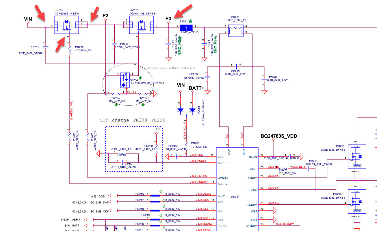

    It has problems with akku charging. Sometimes the akku is not detected / detected, but no charging...
    It don´t matter if old or new akku.
    Someone in Ebay offers the repair - so the failure is known.
    Perhaps someone knows how to fix it?

        Re: Lenovo Yoga 720-15ikb / LA-E552P Akku problems
        1) Have the original battery charger ?
        2) With a known good battery ?
        3) Start with checking the voltages in the first 2 mosfets. Meter in DC mode (20v should be ok). Measure and post the voltages on each mosfet pin.
        See attached.

          Original charger, 2 original batteries. The next days i will go on testing. Thanks
          Someone on Ebay offers a repair for that failure. So the problem should be nothing new.
