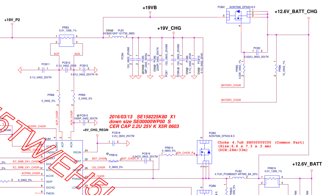

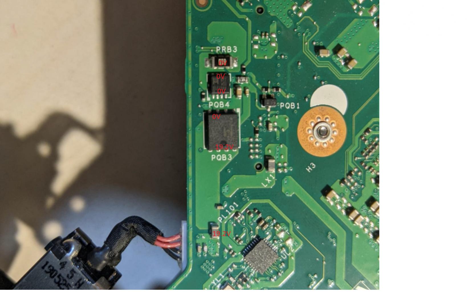

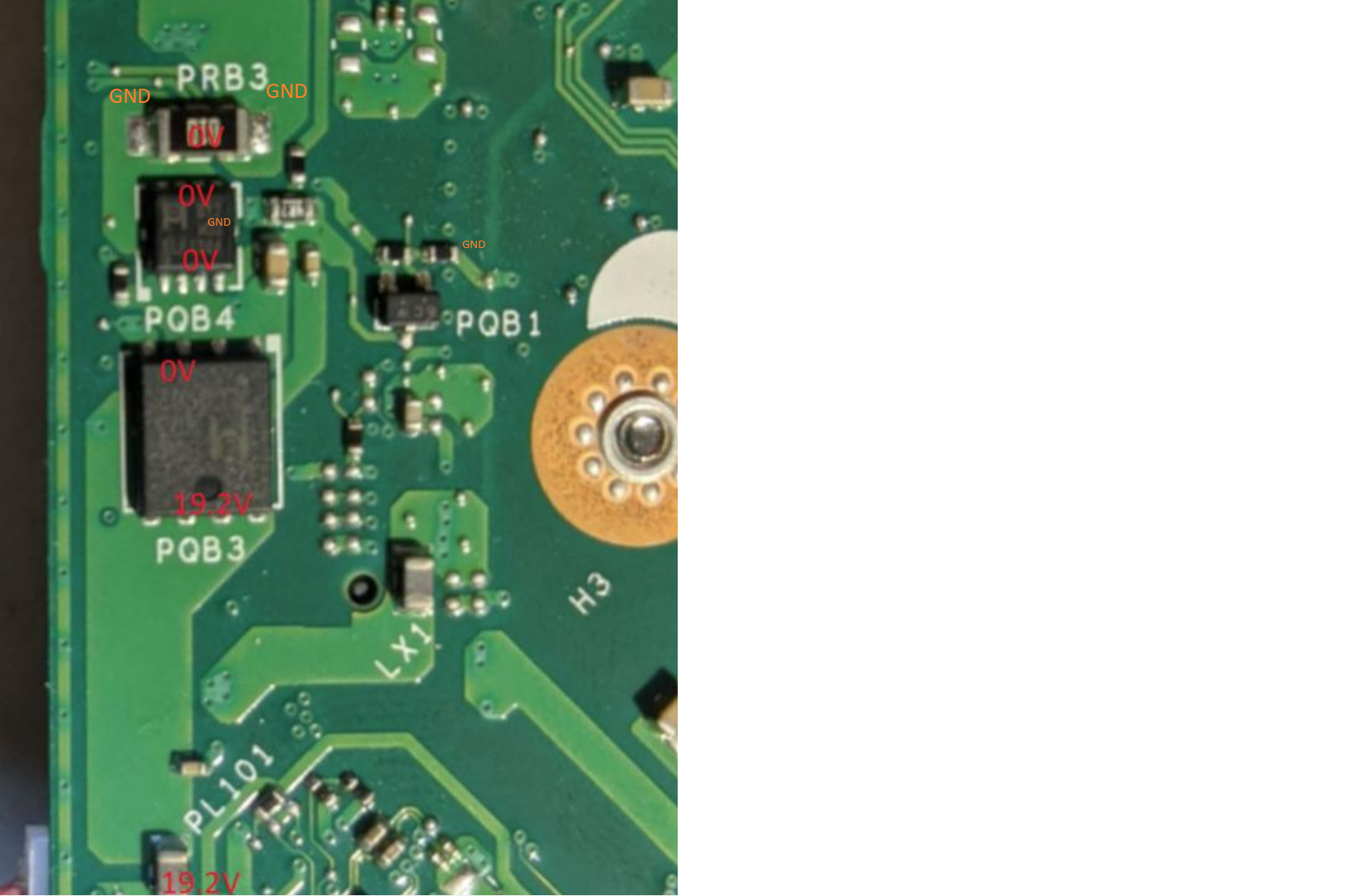

    Hello, I got an Acer N19C2 that doesn't show sign of life. It was working properly and died while I was typing. No charging LED.. nothing, so I opened it and I found schematics on this forum,
    https://www.badcaps.net/forum/showth...ighlight=EH7LW
    which is awesome.
    Using my multimeter, I can see 19V on PQB3 but not on PQB4. Does that mean for sure that this Mosfet PQB3 is the problem ?

        So I have HBP. PRB3 is short to GND. I will try to remove it
        • samstown
          • Mar 2021
          • 122
          • Switzerland
          Re: Acer - N19C2 - MB EH7LW - Sudden death
          so I removed PRB3, that's a resistor ? Can I just short it to test?

                ok, I don't get anything after Mosfet PQB3. Power rail is not shorted. So I'll remove this PQB3

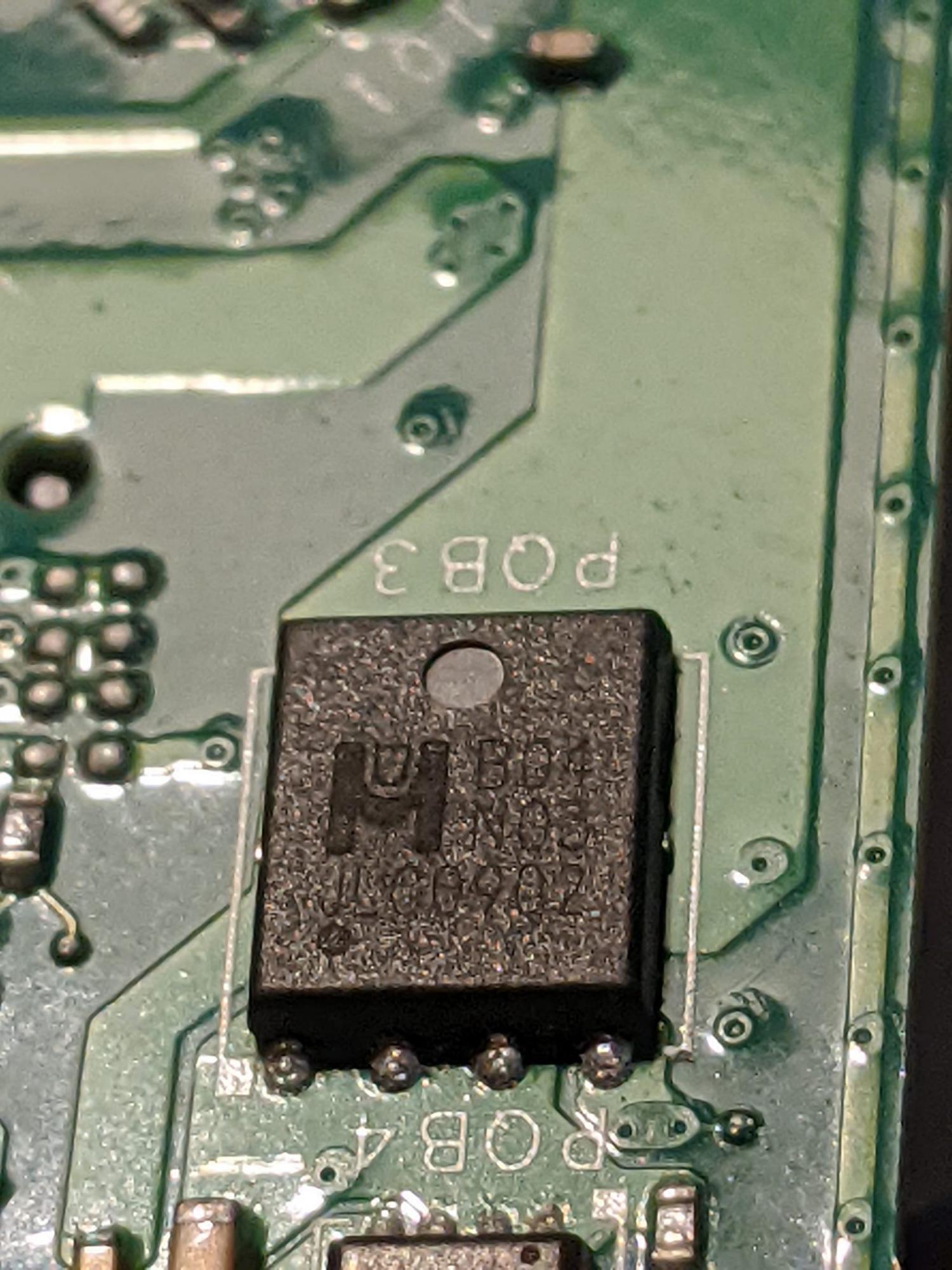

                    Thank you mon2 for you reply, I really appreciate it. Looking at PCB copper, what you describe looks like what I get.
                    IC = B04N03JL00902 (or somthing near...)
                    https://datasheetspdf.com/pdf-file/1...OS/EMB04N03H/1
                    1 to 2 = 0 ohm
                    2 to 3 = 0 ohm
                    1 to 3 = 0 ohm
                    123(source) to 4 (Gate) = 0.589 (black probe on 4)
                    4 (gate) to 5678 (Drain) = open (tried probe on both side)
                    123 to 5678 = 0.475 (black probe on 5678)
                    Sam
                      The resistance checks look ok and the mosfet does not appear to be shorted.
                      Place the meter in DC volts mode (use 30V or higher).
                      Carefully, check the voltage on Pin #1 of this mosfet = should match the DC adapter input voltage.
                      Then, carefully check the GATE voltage. Most likely the voltage on the GATE is not high enough to enable the pass through voltage from SOURCE & DRAIN pins.
                      Post the readings.
                        Thanks.
                        PIN 1,2,3,4 = 0V
                        PIN 5,6,7,8 = 19.45

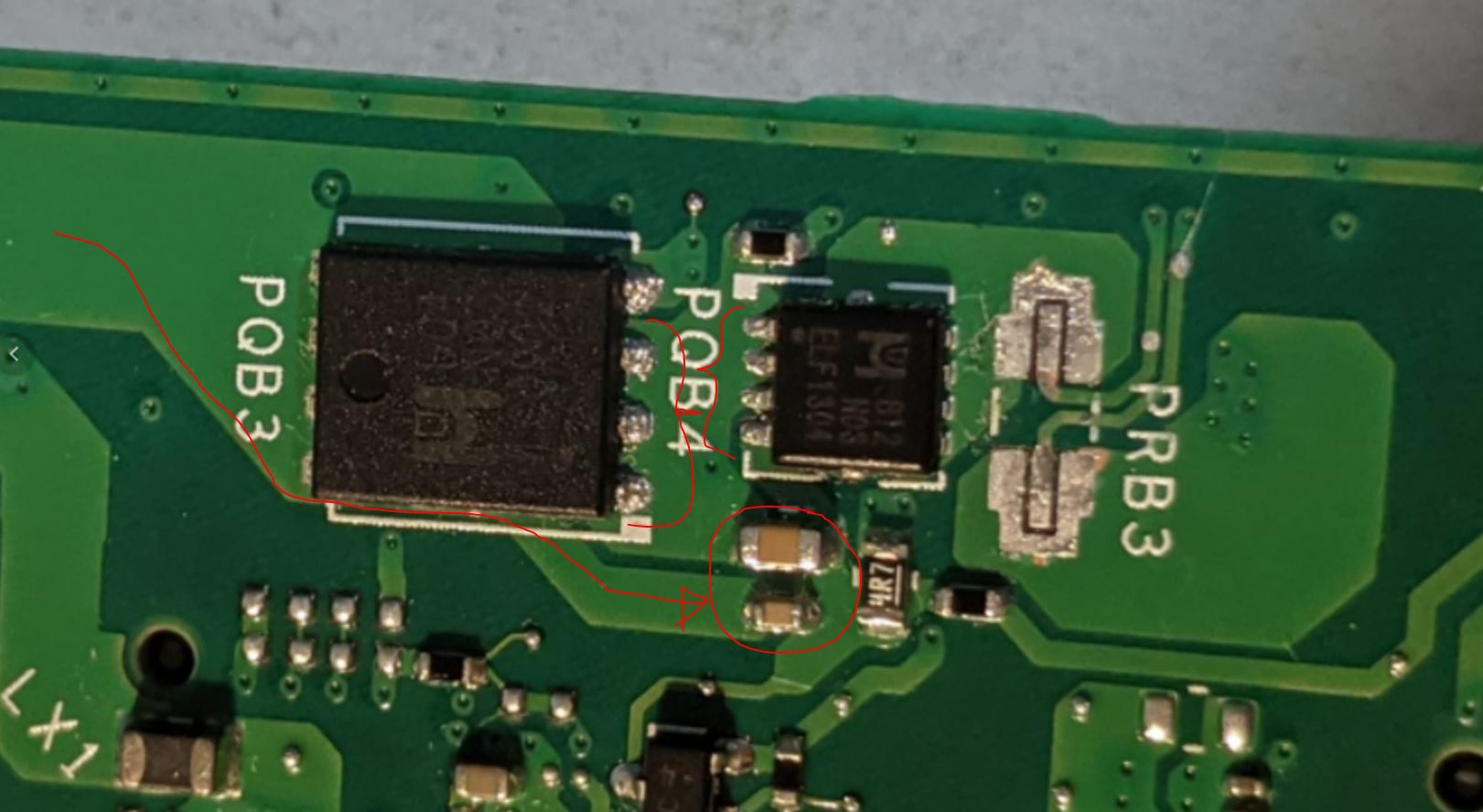

                            PQB4 excelliance B12N03E looks ok, no short between source, drain and gate
                            • samstown
                              • Mar 2021
                              • 122
                              • Switzerland
                              as I get no Volt on PQB3 and PQB4 source, it must be the two caps... but they are not shorted and just to add, nothing get hot

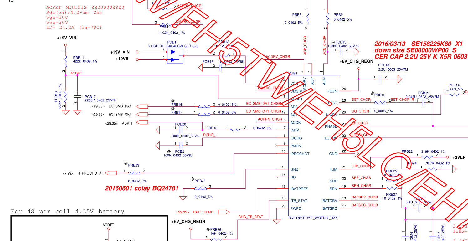

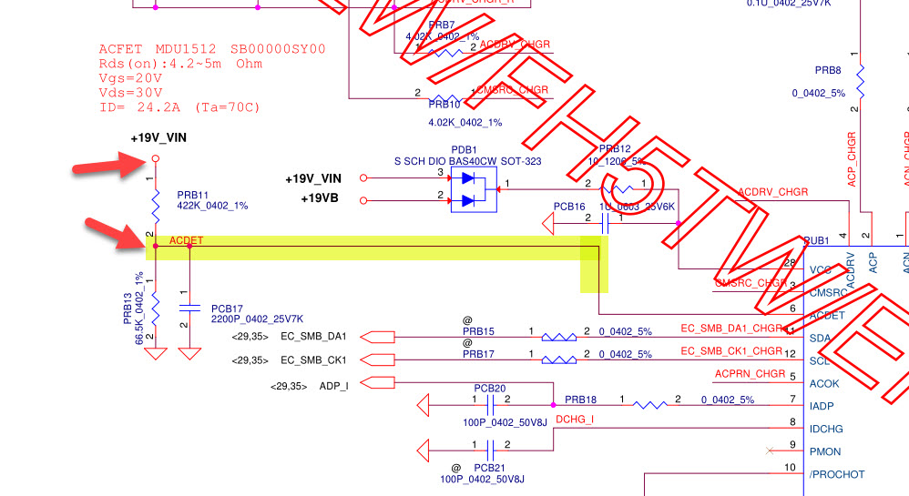

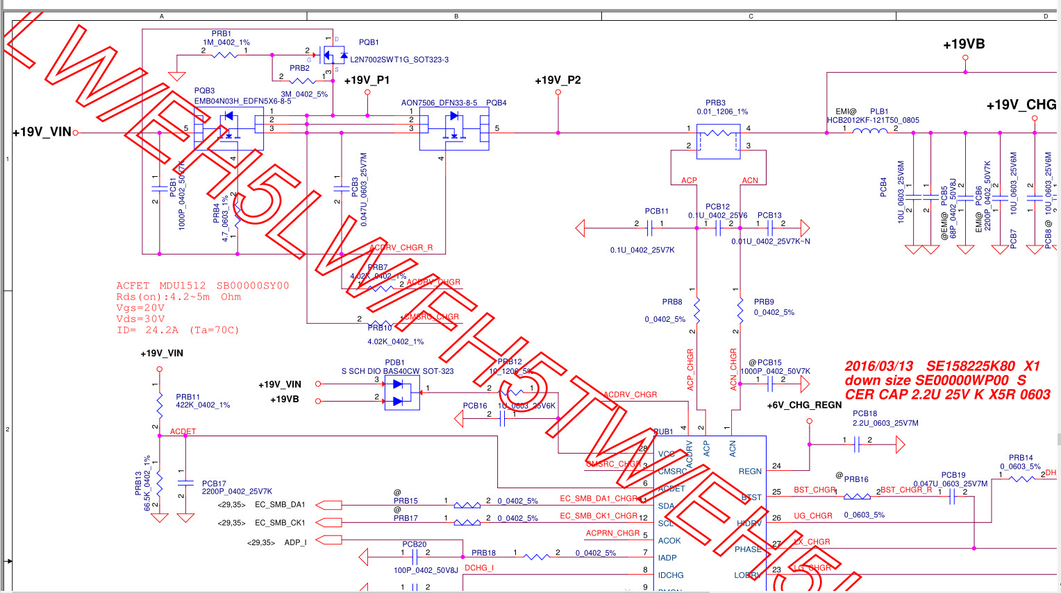

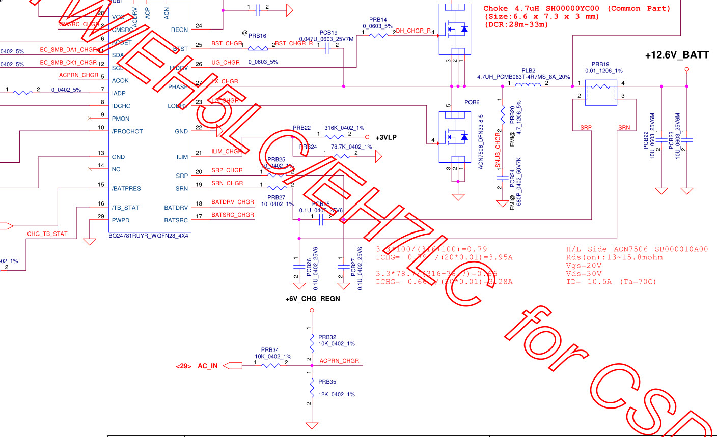

                                Posting the partial parts of the schematic.
                                It will be a good idea to know the voltages on each pin on the charger IC @ PUB1.
                                Remove the battery but attach the official charger. Then carefully check the voltages on the charger IC. Post the readings.
                                • samstown
                                  • Mar 2021
                                  • 122
                                  • Switzerland
                                  Thank you for your help and patience.
                                  Pin not listed = 0
                                  5 = 2.64
                                  9 = 0.30
                                  16 = 0.4
                                  17 = 0.24
                                  19 = 0.24
                                  20 = 0.24
                                  24 = 1.8
                                  25 = 1.03
                                  26 = 0.24
                                  27 = 0.24
                                  28 = 18.86

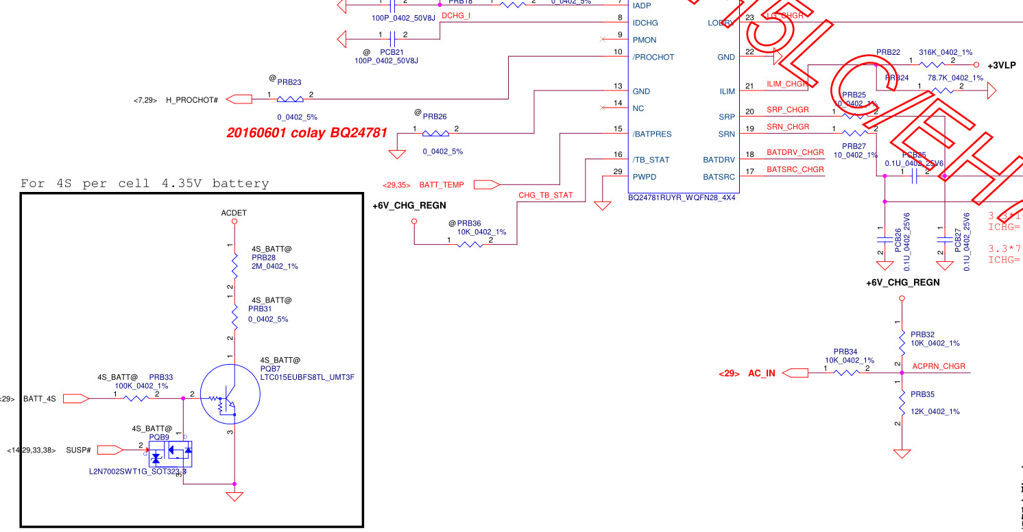

                                    See attached.
                                    Can you confirm again that ACDET = 0 volts ?
                                    This is a simple resistor based voltage divider.
                                    Pin # 1 of PRB11 should be the same as the DC adapter voltage.
                                    What is the reading ?
                                    Then the junction between pin # 2 of PRB11 & pin # 1 of PRB13 should be a much lower but safe value for the charger IC to determine if the charger is plugged in or not.
                                    What is the voltage reading between these 2 resistors ?
                                    The voltage should be a value > 0v unless PRB11 is damaged or is missing from the logic board.
                                      Sorry, my mistake was too late... Pin 5 = 0.
                                      ACDET pin 6 = 2.64
