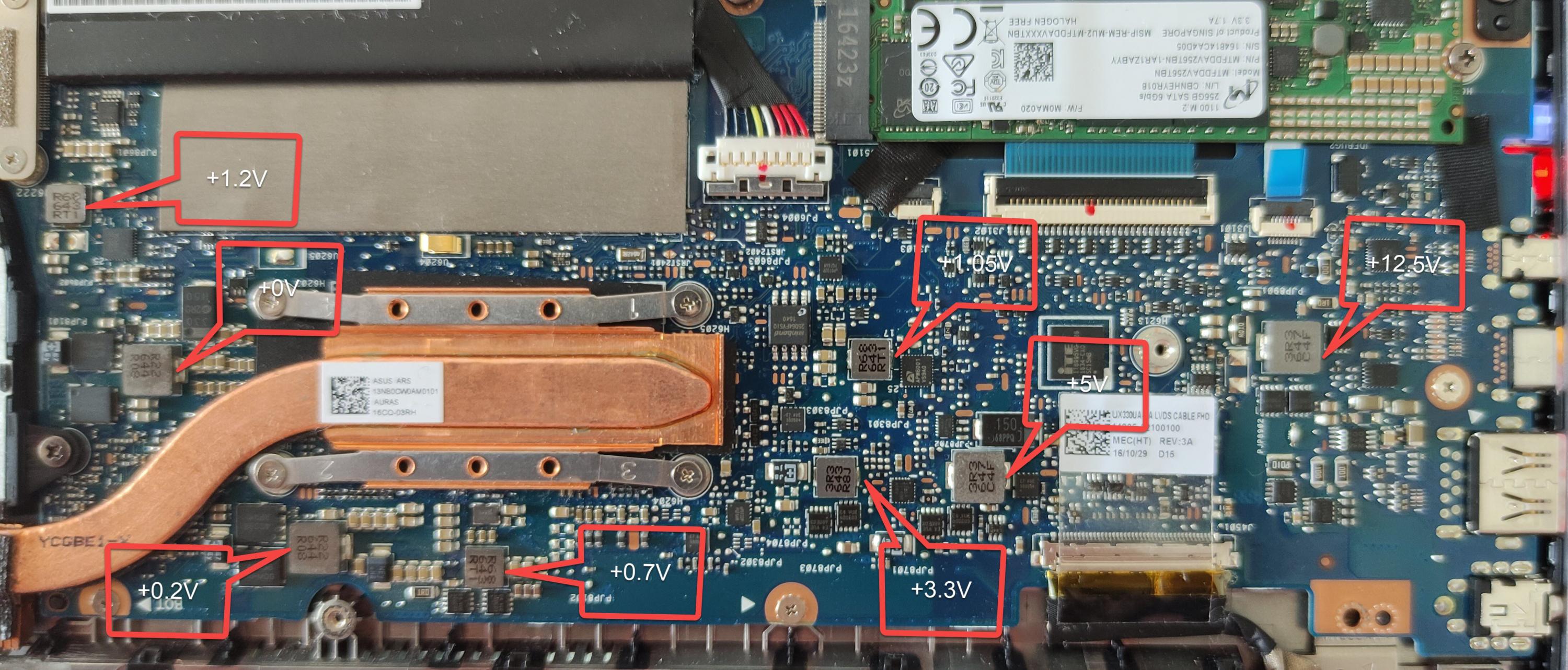

Had one in dead today with a shorted RBFET (A5 VND = P0903BEA). Replaced it with a AON7502. Took some measurements on the coils for future reference as schematics/boardview seem scarce.
Asus UX330
