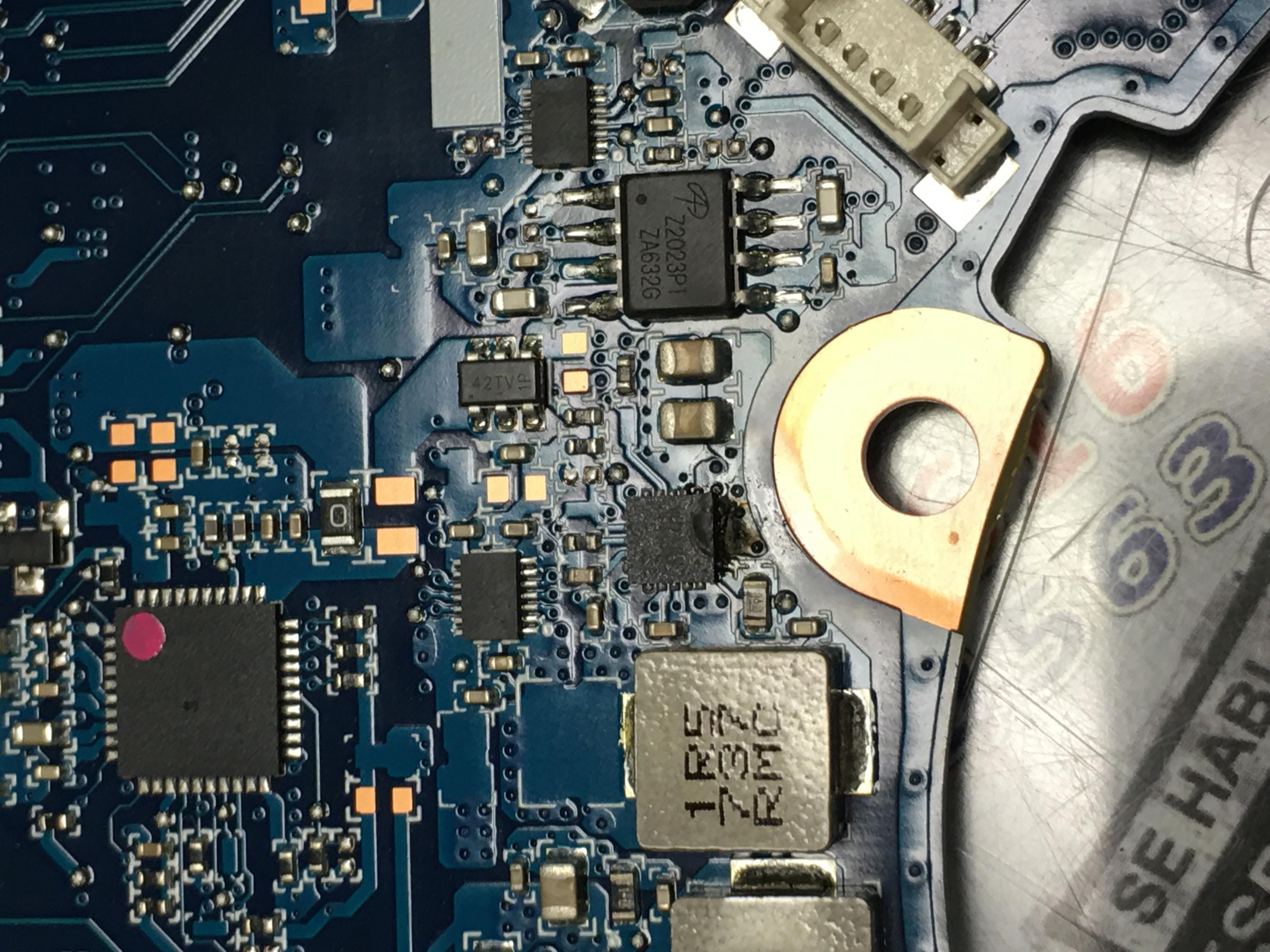

    I have a HP Omen 15-ce019dx with motherboard DAG3AAMBAF0 Rev F with a blown ic. Looking for the replacement chip and just need a little help to make sure I am buying to correct one. Markings on the blown chip are AWV7HK
    I believe this one from ebay is the correct one from my research.
    https://www.ebay.com/itm/25395899858...gAAOSwMQ1b2gzK

    Yes thats the right one https://www.badcaps.net/forum/showpo...1&postcount=12

      Thank you!
