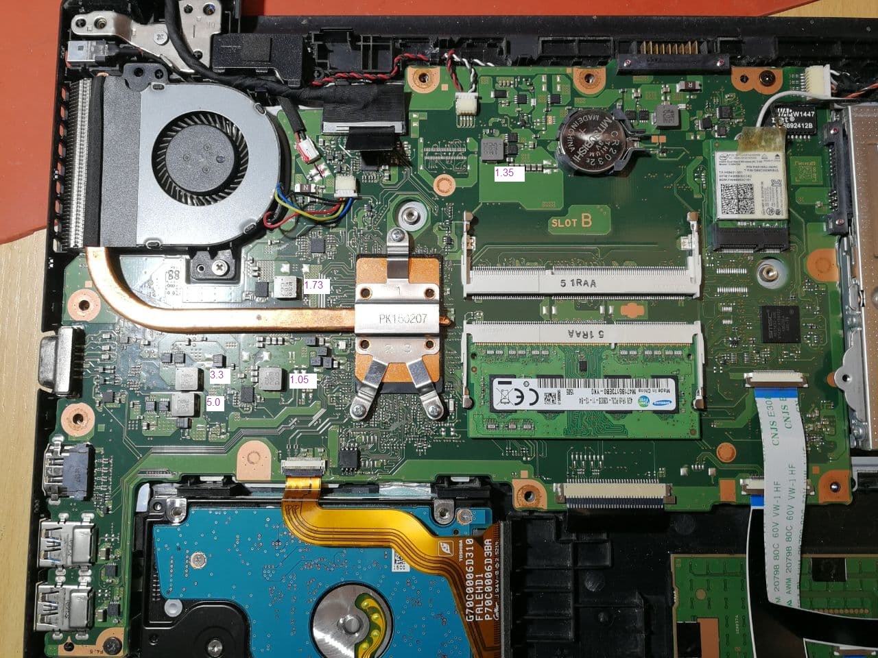

    I have a Toshiba Satellite PRO B50-B-10K not display (external or internal)
    Part NO: PSSG0E-003007FR
    it drain about 340mA in PS
    keyboard is working
    I wrote a new bios an clear me but nothing changed
    Please help me figure out the problem.

    Are there any voltages on the coils,you must have done some testing

      Yes
      these testes on the coils after power on:
      3.3v
      5.0v
      1.05v
      1.73v
      1.35v

        have you tried some known working DDR3L ram. Have you tried with just the bare board,nothing else attached
          Yes, i did but the same thing

              Dramrst# present on pin 30 of ram slot??

                Sorry for late reply, but the device is returned to customer :-(
